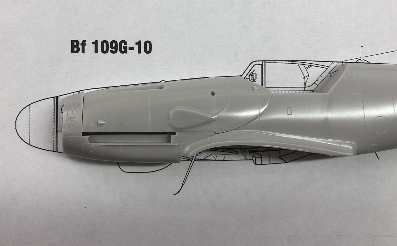

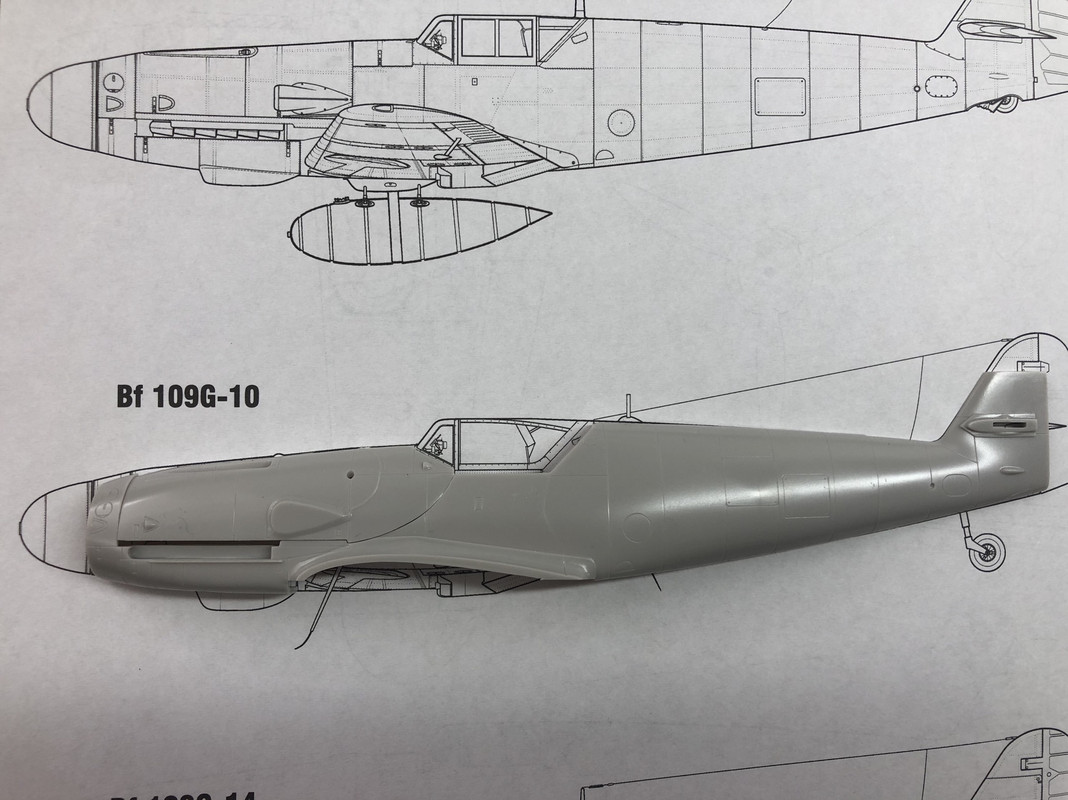

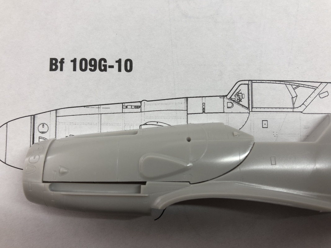

The Fujimi kit is as they say “ a mixed bag”. It gives a lot of options but at the cost of being a bit over engineered. It has panel lines for the G-5 to K series so these wil have to be filled selectively. The nose is also to short. I have taken some pictures of that. Because the nose is to short the slope of the nose is also to steep (it is pinched in the vertical axis). The exhaust and gun ports are in the right place. But the tip (between the engine cover and propellor hub ) is 2mm to short. I have a plan to fix that. I am not sure how I can correct the slope.

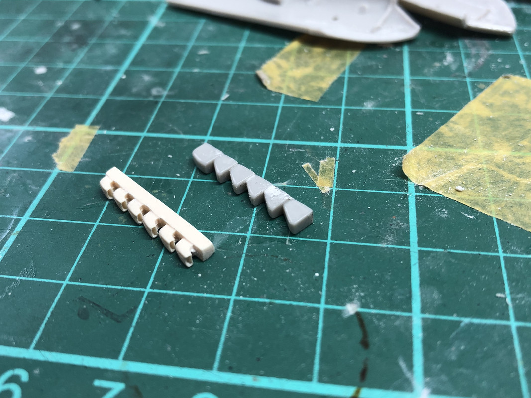

Small progress: I have been working of the resin exhausts. These are generic and not designed for any particular kit. So it toke some time to get them to fit.

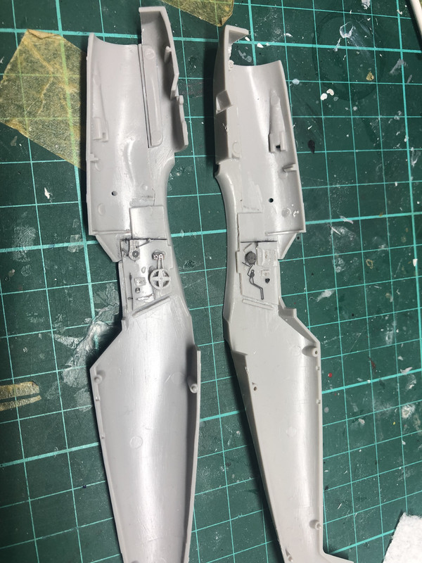

I have been working on the cockpit. I have used an Eduard PE set, designed for an Academy kit. The fit is actually quite good.
