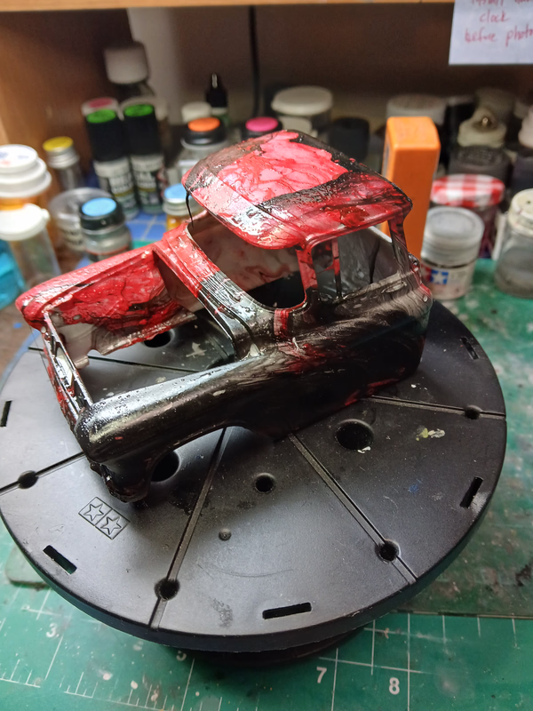

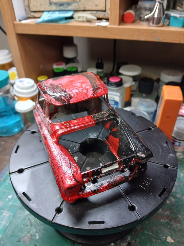

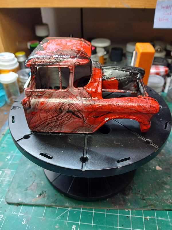

Finally tried my hand on hydrodipping using a junk truck cab. Base coat is silver. I sprayed gloss black and gloss red in hot water; then "slowly" dipped the truck cab in hot water . You start dipping in an angle and work slow to get the whole cab in. Then youre suppose to move the paint away after it's completely submerged before taking it out of the water.
Not my best work but I do need to practice more. Here's are the results of my first hydrodipping method.
This is exactly what I was trying to achieve. Pretty cool, eh?

That's wild and screams Mad Max! Not bad for a first try. The makey dipping specific 'paper' that you float on the water, then hit it with activator and it turns to liquid. The demo you shared the paint method seemed to gloop a bit and add texture.
