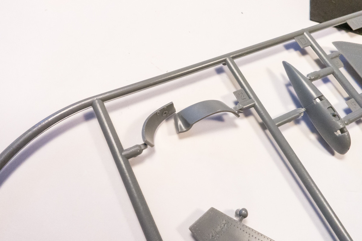

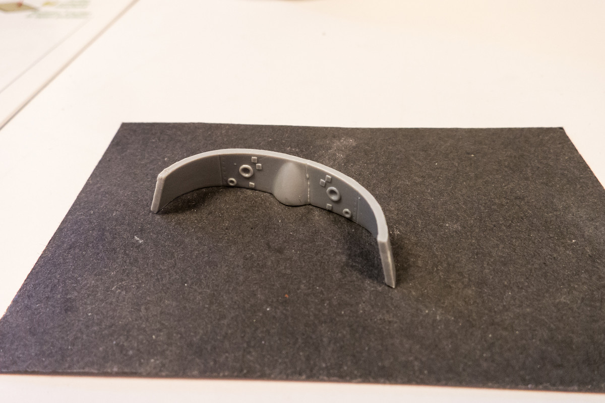

Some parts breakage that I just noticed. This ring part forms the upper roof of the big chin intake. I was going to check to see if the casting block interfered with the install of this part but found it broken.
After some consideration and some encouragement from Anthony Galbraith, who designed the masters for the Barracuda Tempest V Nose Correction set, I've ordered that resin set and will attempt to implant the Special Hobby resin engine into the Barracuda resin nose. Incidentally, if it works, I won't have to deal with that broken part above as the Barracuda nose has that area molded in place.

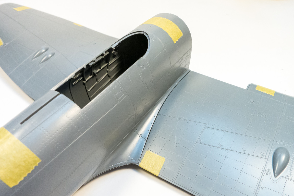

I'm not going to get much deeper into this build until I figure out what I want to do with the surface details. My options range from (a) do-nothing all the way to (b) sand everything away and rescribe-rivet it all over. I want to make improvements but I don't have the desire or resolve to do (b). I've tested the rivet dot pitch pattern against my riveting tools (RB Productions, Galaxy Tools, Trumpeter) and they don't match so fixing the kit rivets will have to be one at a time. I am toying with the idea of filling all of the rivets with black CA glue and punching new rivets with one of my tools. The black CA would give me the visual pattern of the rivet lines without having to re-draw them. But I don't know how the filled rivets would respond to having a rivet tool run directly over them and I'm afraid of creating a mess. And there are a TON of rivets... lots of filling and sanding.

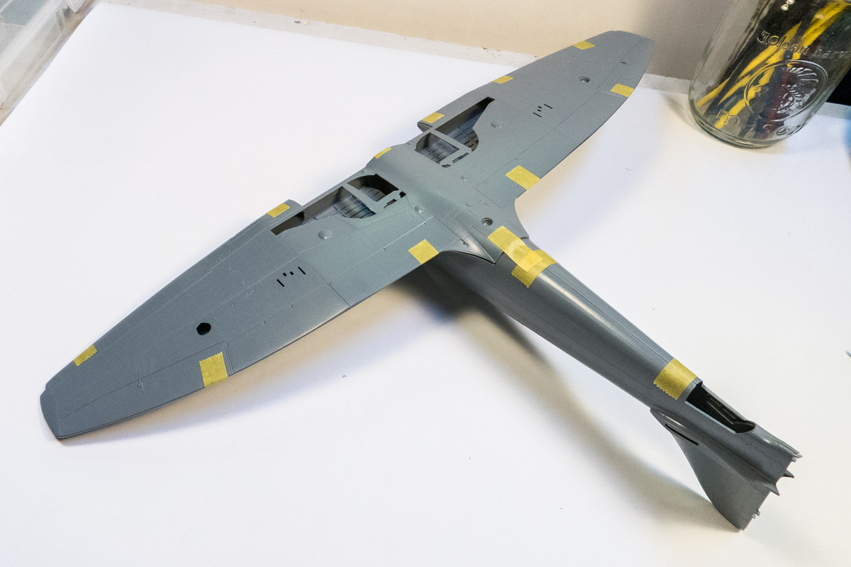

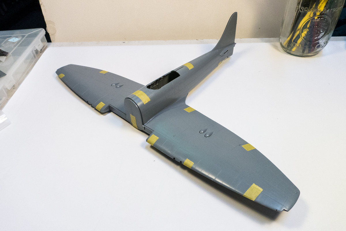

I did some preliminary dry-fitting with the major fuselage and wing components. Fit is not especially great but not horrible either.

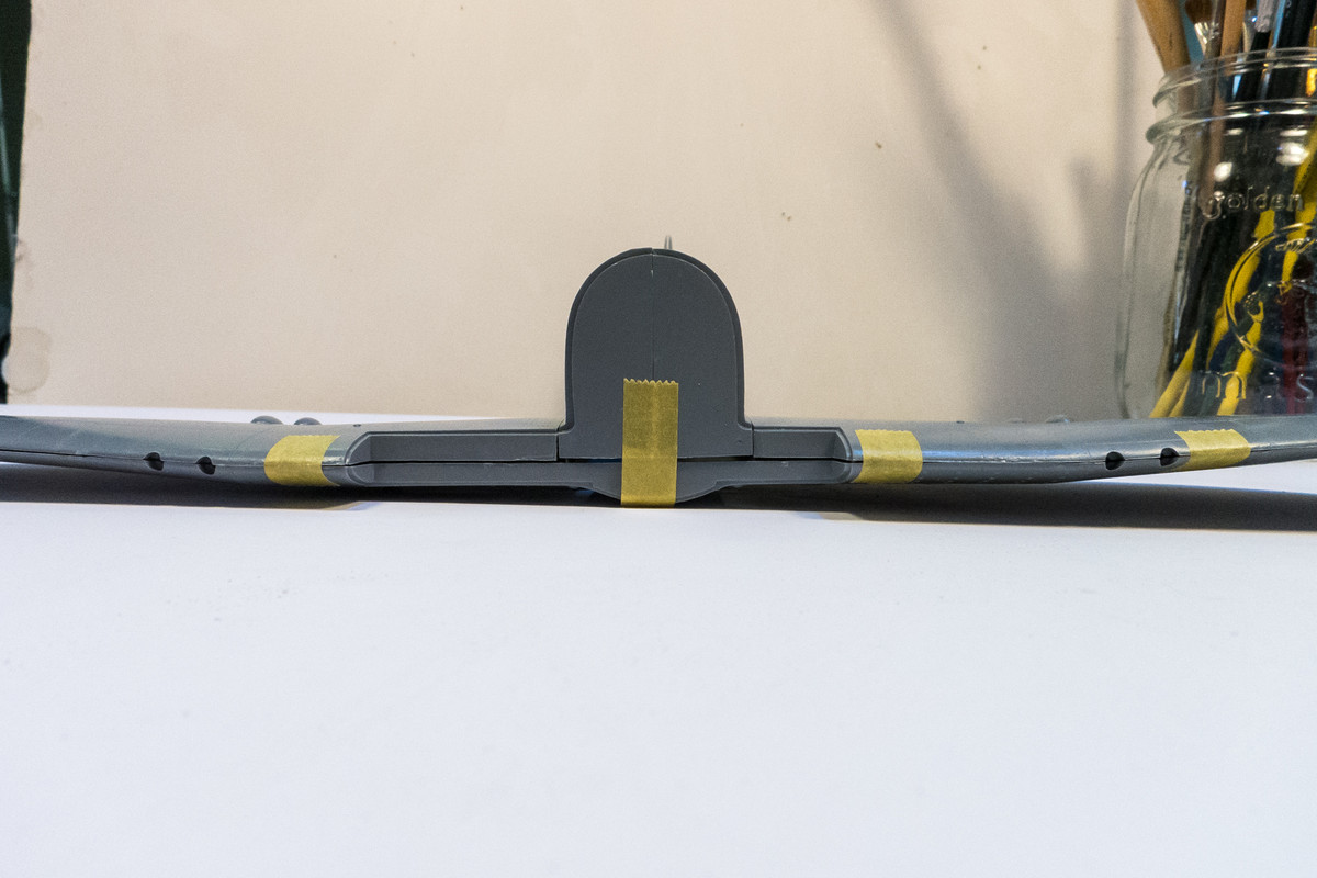

Checking the wing geometry to make sure that center section is flat. Will have to pay attention to this area as internal components are added to make sure that the fuselage doesn't push the wings out, causing an anhedral condition.

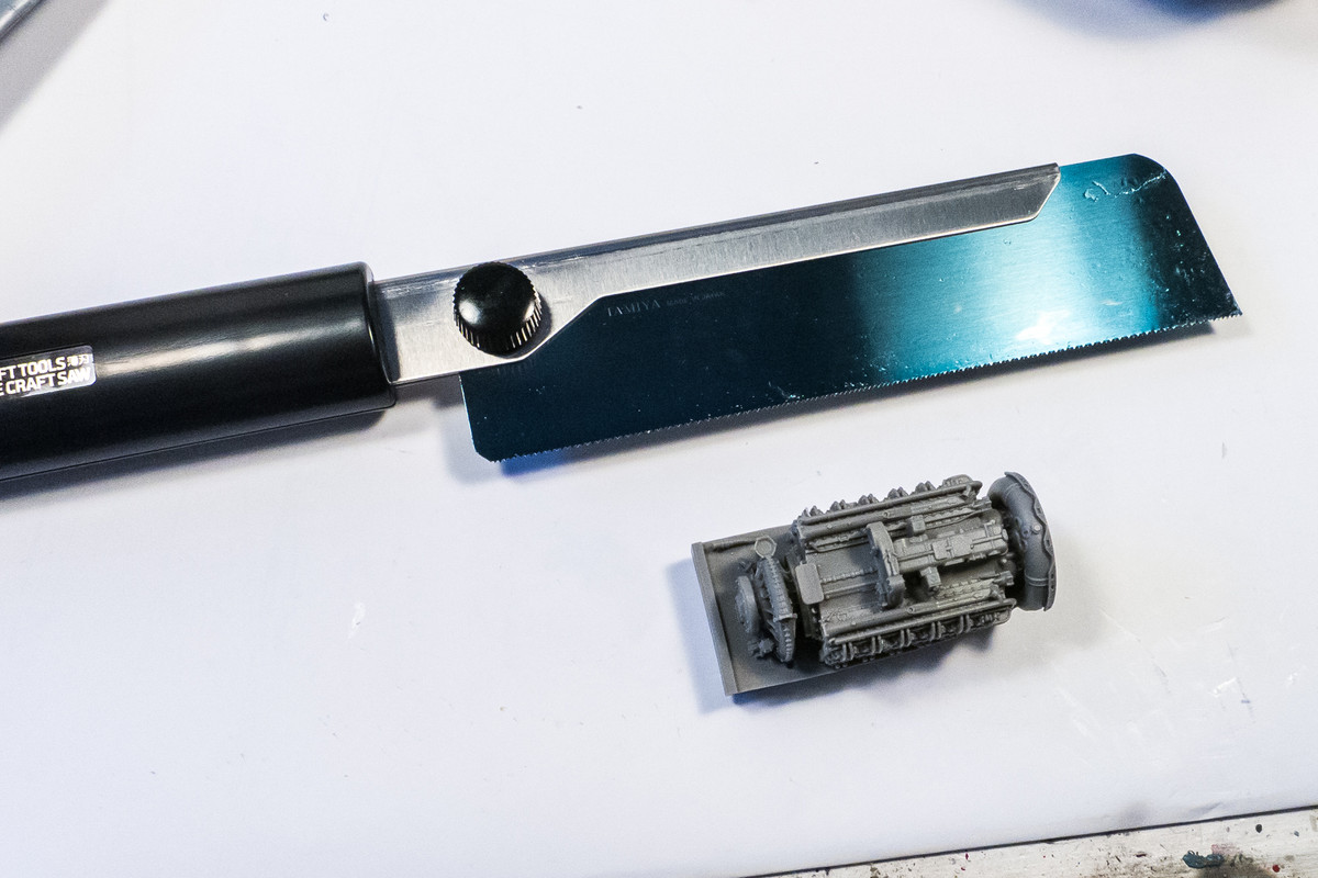

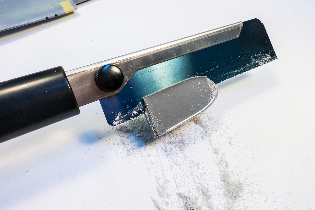

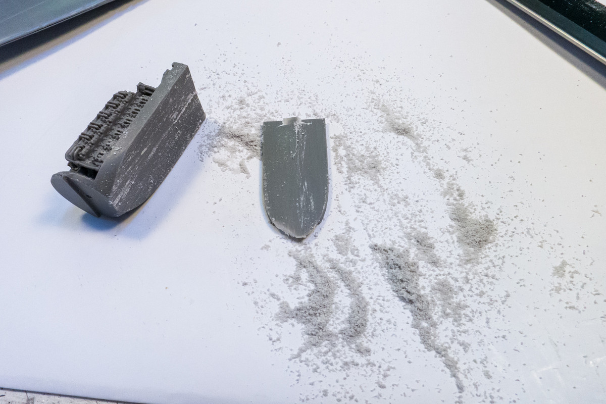

Got a new tool in the mail today to deal with the big casting block. Tamiya Thin Blade Craft Saw #74024 About the size as a big kitchen knife!
Plenty of blade clearance to cut through this piece.
Life is so much easier with the right tools. Thank you Damian for this excellent recommendation. Make sure you wear a mask when cutting resin!

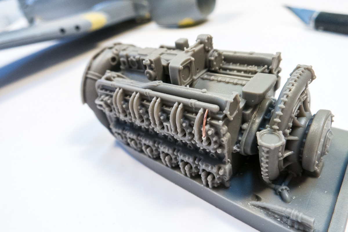

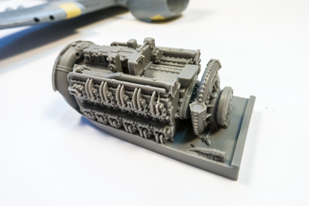

One of the things I noticed after taking my first photos of the resin block (meaning it wasn't caused by the sawing process), was a broken ignition wire.
That got me to thinking... what if I replaced all of the ignition wires? Very do-able!

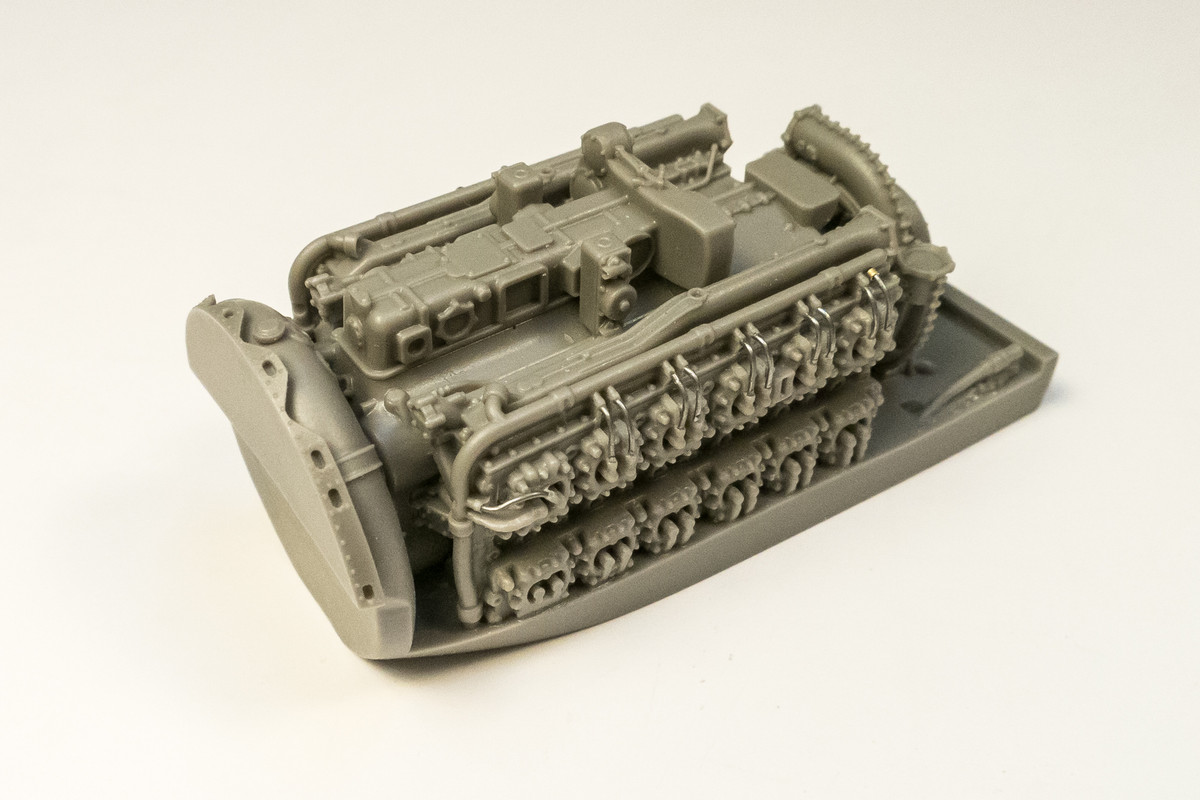

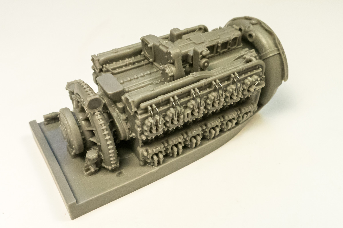

Thanks guys! Haven't made any decision regarding the surface details but I did replace the molded ignition lines on the resin engine with lead wire.
Posts: 12169
Looks good!
