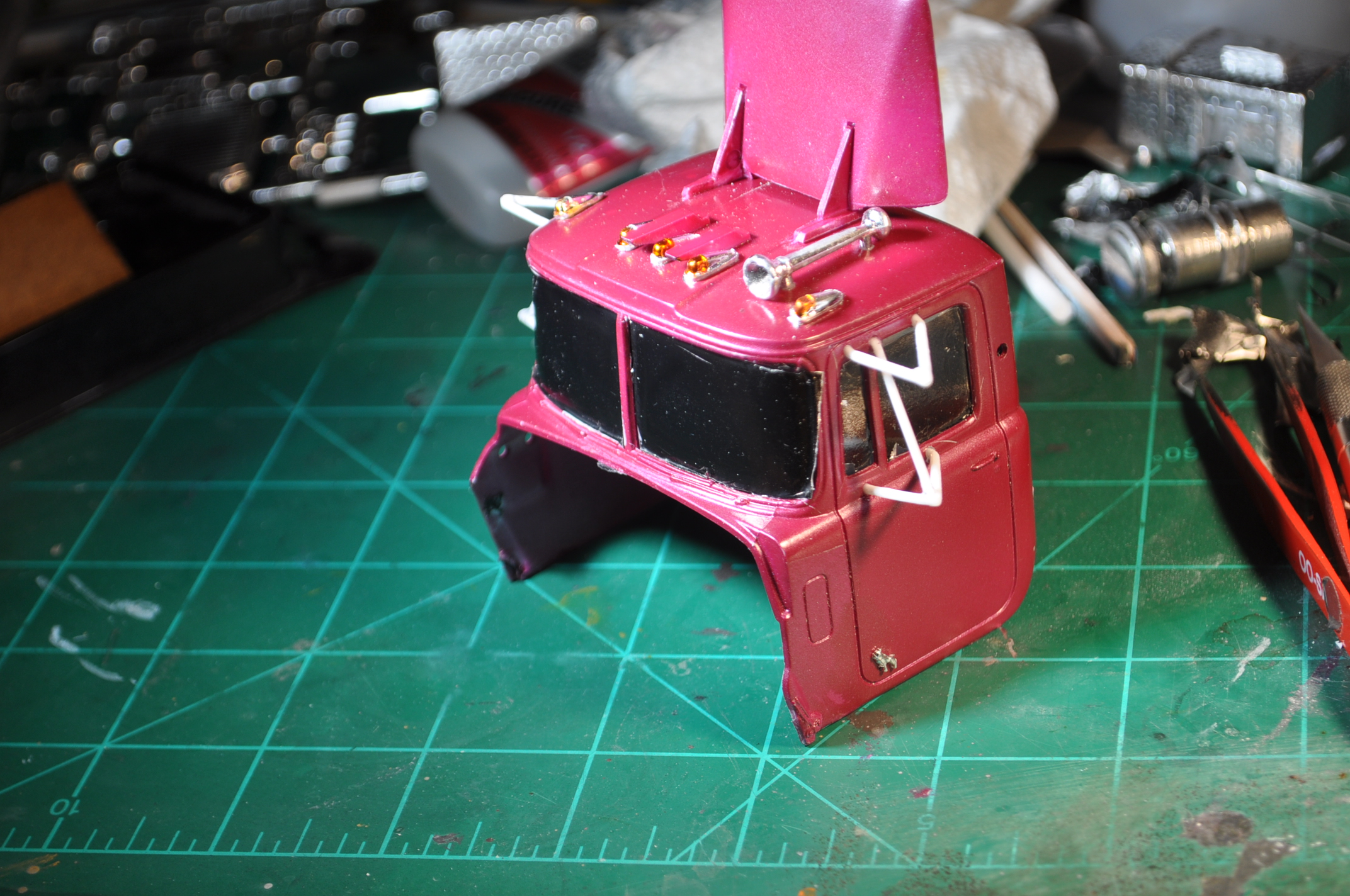

She has started fighting back....sort of passive-aggressive.
After mucking up the windscreen, I blacked it out. I was already considering this option, anyway. The interior was way below even my standards. I used some Bare Metal Foil 'Black Chrome' to cover the winders.
Still have to chrome the mirror supports and touch up some of the body color. Found a mirror effect spray paint from Rustoleum....a couple of youtube videos seem to show that it really does produce a mirror finish on clear sheet - spray it on the reverse side (4-5 coats). Sho 'nuff looks like a mirror finish. Thought I'd spray some clear plastic sheet and cut out the side mirrors. Yeah, I am a dork.

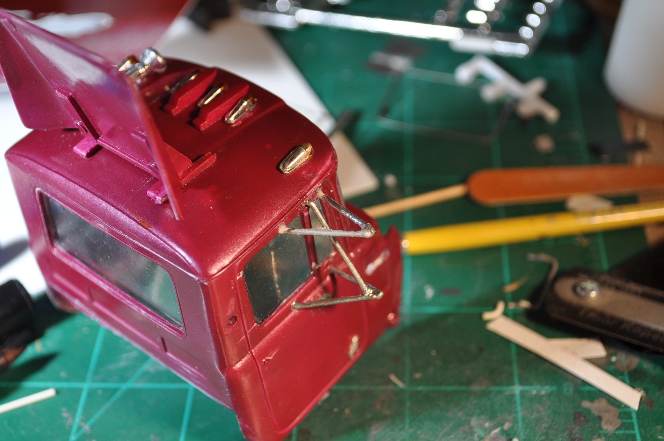

I decided to take the black chrome BMF off the windows and repair the marred area of the right windshield. Looks much better.

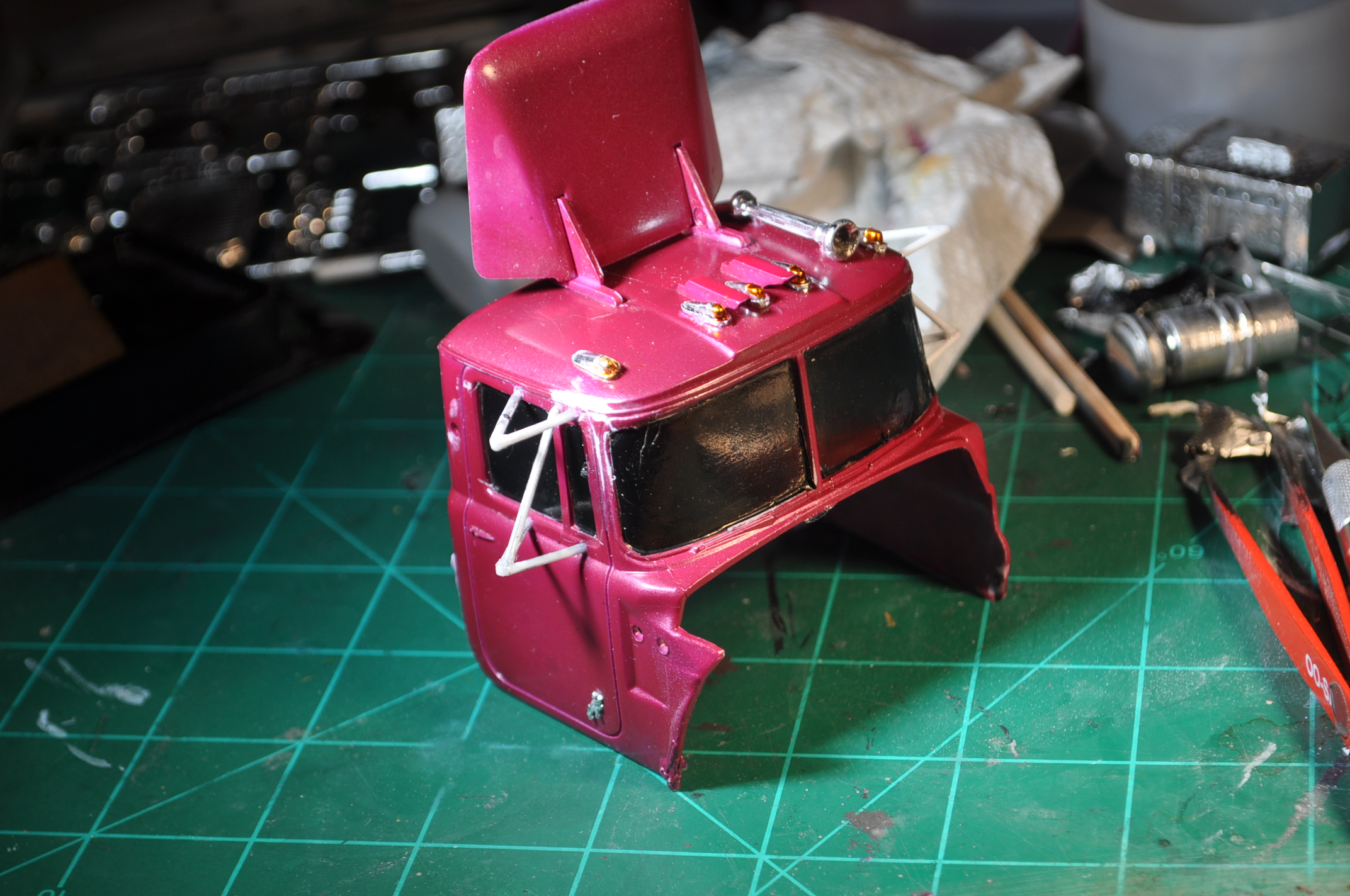

Anyway, I thought this was close to being finished. The more I work on it the more things fall off. Sort of like old age, I guess. With all the fiddley bits for the mirror brackets, some were sure to break. While I've escaped from breakage, two did go missing. One upper support bracket and one mirror bracket.

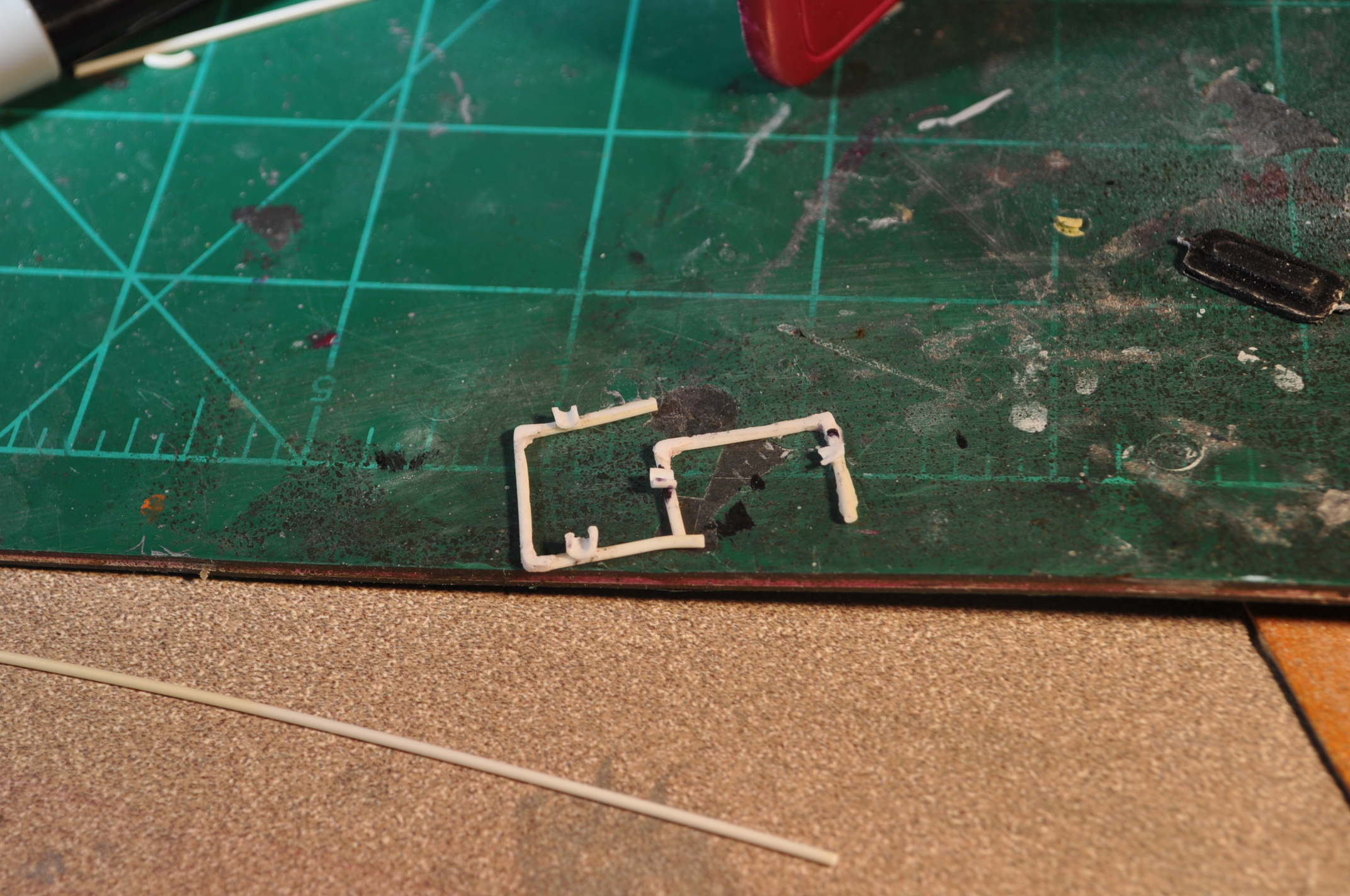

I ended up making replacements out of some styrene rod and a bit of sheet styrene. For the mirror brackets, I spent way too much time trying to heat the rod and make the bends. Every time, the first one was okay, the second one would not work. So, I gave up and glued, using butt joints and sheet styrene for corner gussets, some rod and then cut a couple of pieces of styrene tubing and split them. Glued them on the brackets for the mirror support.

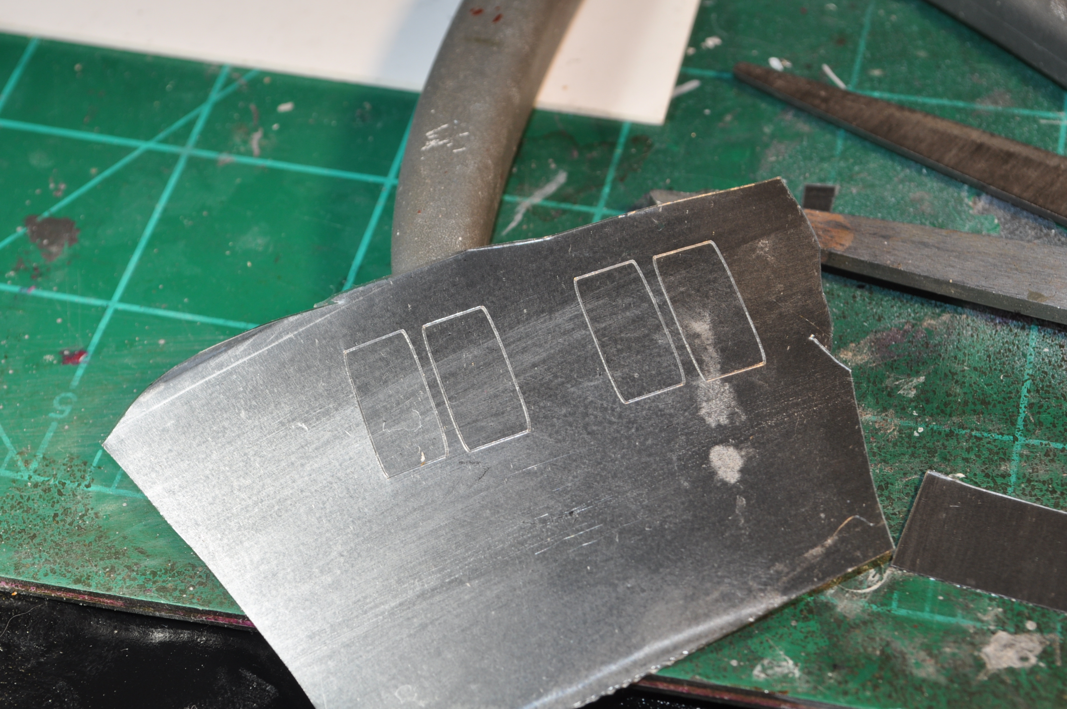

On the mirrors, I painted up some clear plastic sheet, scored it with the Silhouette cutter and glued it on the mirroe. Thought it added a bit of dimension to the critter.

These will be cut to length and the mirror brackets sanded down to a more scale-like look.
