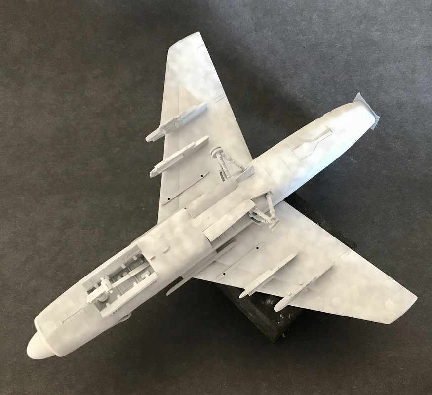

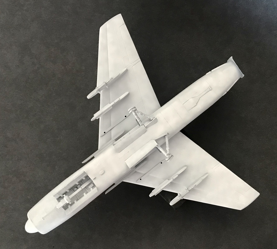

Today’s update- more airbrushing!
First up, I decided to try a marble base coat of Tamiya Flat White on the lower surfaces and flying surfaces topsides.
then I lightly airbrushed on multiple coats of very thinned (2 parts thinner 1 part paint) Tamiya Gloss White over the base coat
not too bad...

Cool - did you do gray overall? I have an F4-J ready for paint in the same scheme and have been thinking of trying this.
Posts: 21541
Re: 1/48 A-7B VA-93
keavdog wrote:Cool - did you do gray overall? I have an F4-J ready for paint in the same scheme and have been thinking of trying this.
Thank you. Yes a base coat overall of Tamiya Gray Liquid Surface Primer. Except for in the intake. I used Tamiya White LSP in there for a more vivid white.
