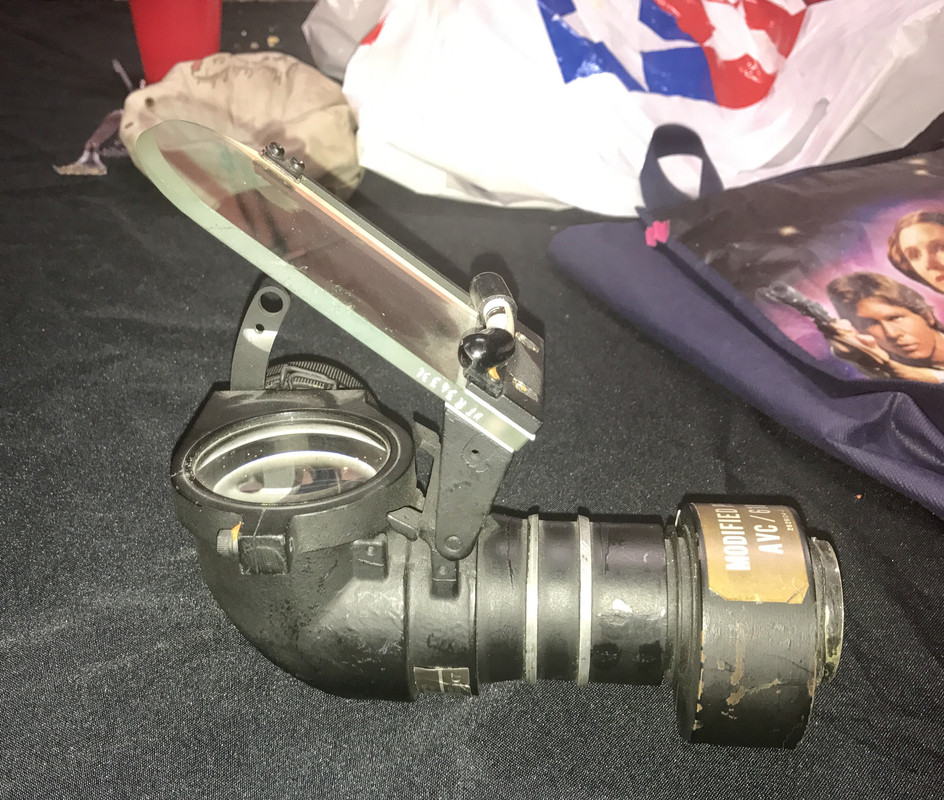

Stikpusher wrote: ↑Thu Jun 29, 2023 9:48 am You diving deep into this one! Beautiful work on the driver. :shoutout: Are you making your own barrels from telescoping brass tubing, or did you buy those pre made? Very interesting about the pencil rub onto graph paper for the canopy mask… :hmm:
I have some photos of an A-4 Skyhawk gunsight for reference if you’re interested…

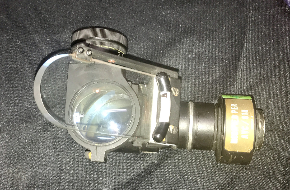

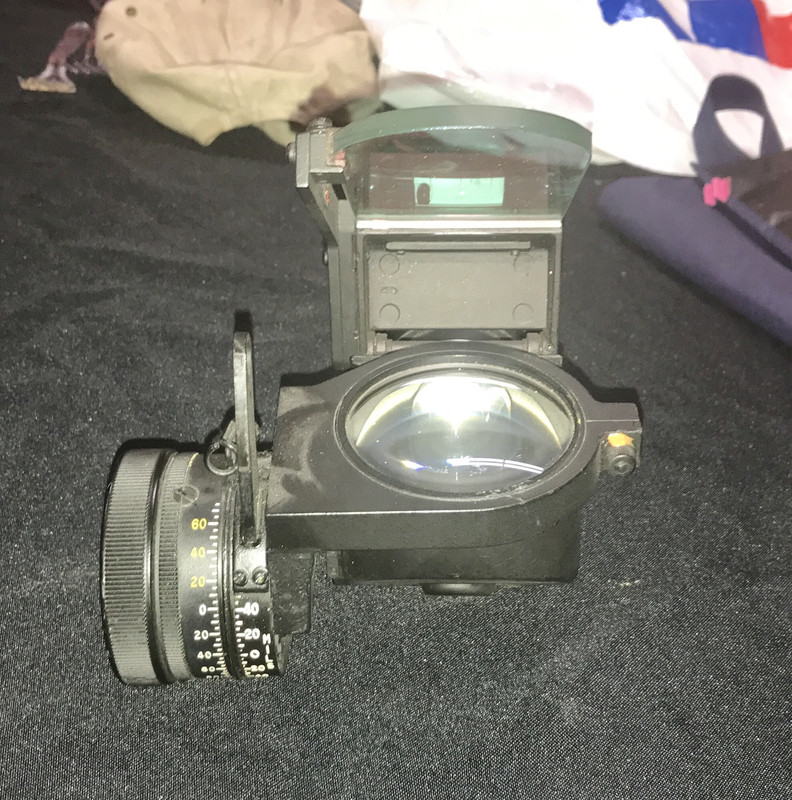

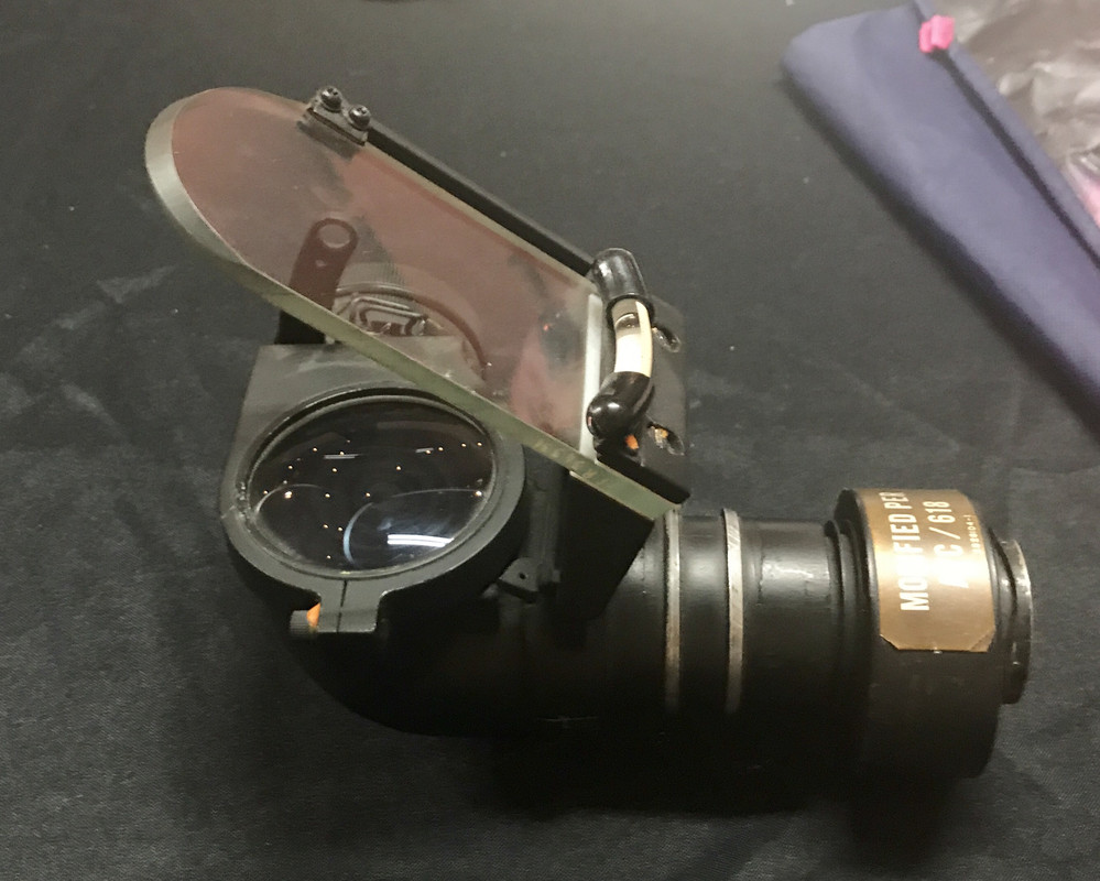

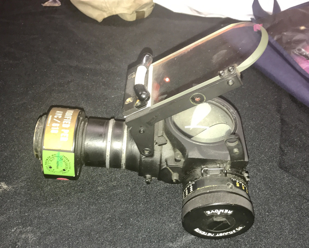

Here is the sight off of a Skyhawk that one of the guys brought into an AMPS meet a few years ago

You're welcome Chris. It was cool in that if you shined a bright light up the mount tube, the aiming reticle would project onto the sight glass.

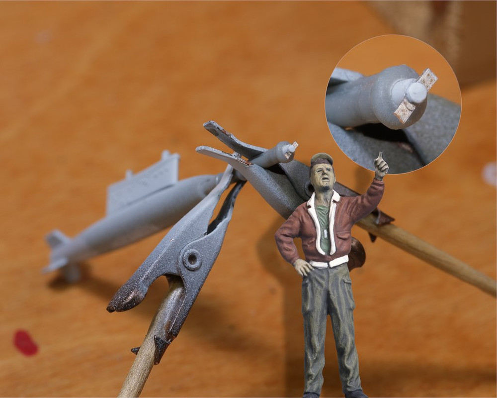

The new fuse prototype is 'Sarge Approved'.
Styrene rod, strip of aluminum from soda can, tiny .2mil punched styrene disk for the end cap.
