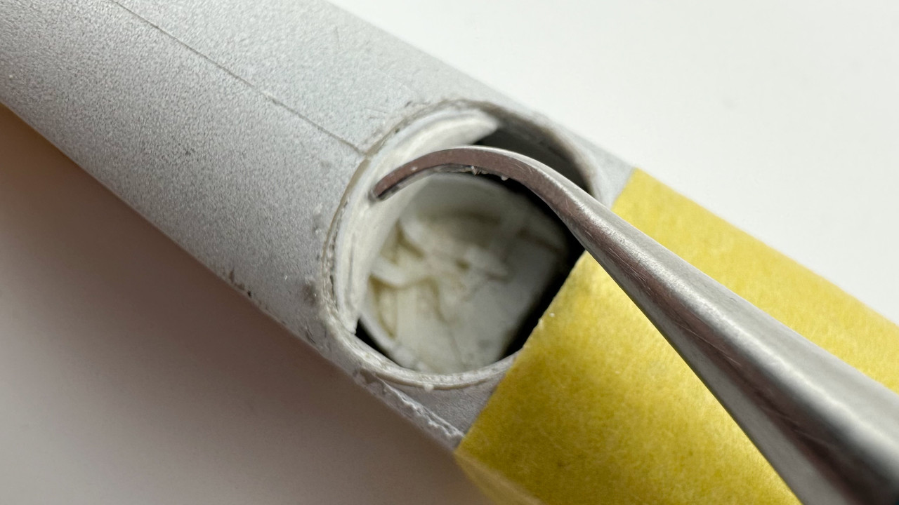

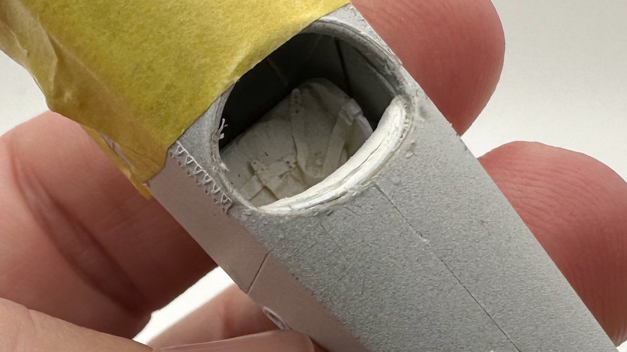

Next using dental scrapers to shape the "leather" form—I've glued in the piece with PVA white glue which I've let set overnight. What' useful about using good old Elmer's is that it sets well if given the opportunity, but will still release its bond with warm water. This allows me to really work on the new part I've made. I really put this to the test with a Trimaster kit where I white glued white metal landing gear and the bonds held in place once the glue set. The issue there was building a jig to hold the legs while the glue set since it takes a long time.

Thank you, Stuart! Sincerely! Thanks for following and sharing your encouragement! My next step will be a tightly controlled light sanding to reduce the thickness of the edges.

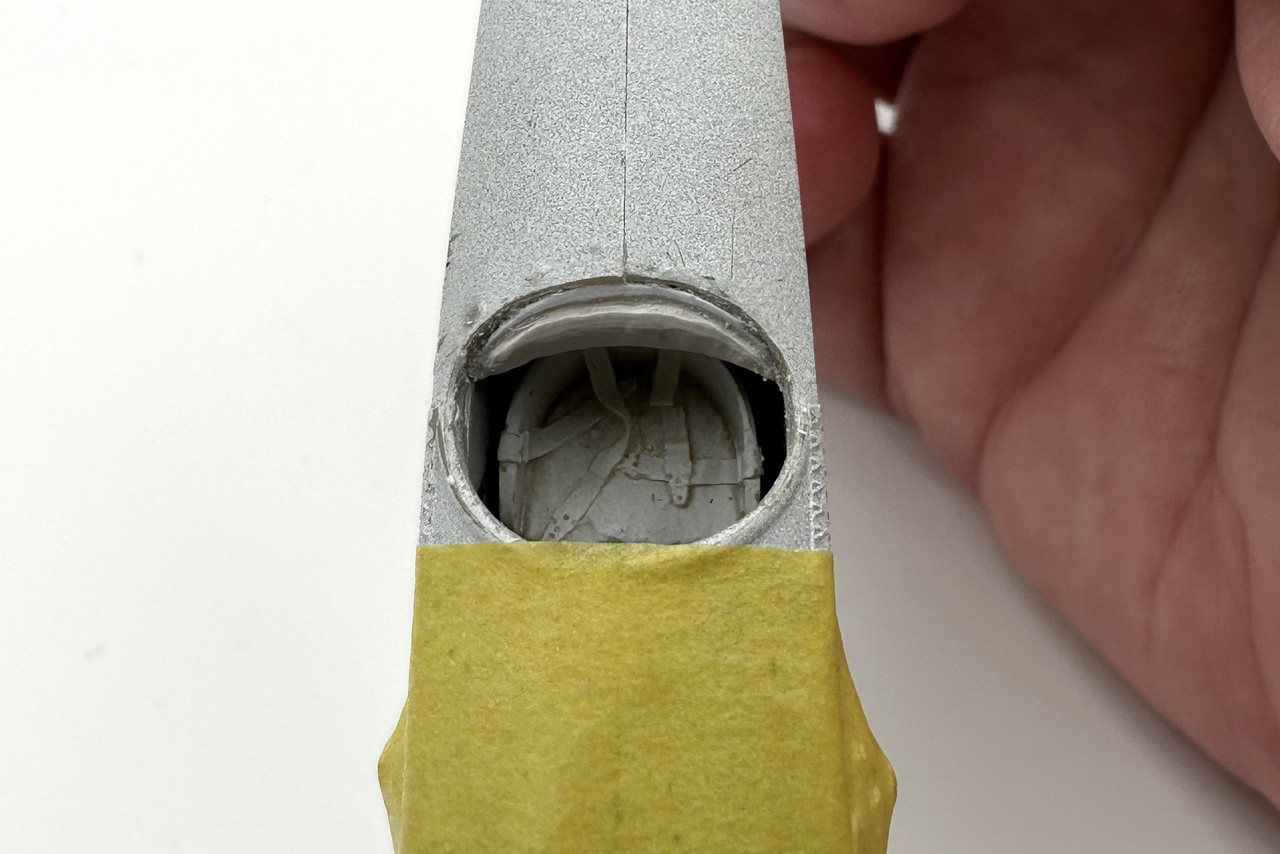

Thanks so much for being here, Carlos! I’m truly grateful. In this photo you can see better the stations left from carving the seat down; no matter the amount of repetitions the dental tools only go so far to smooth the surface before these start to polish the materials and in some cases will cause some finer edges to flake apart. This is why I’ll use small sanding strips made by Mr Hobby and sand down those ridges. I only have 800 and 1000 grits left but those should work in such a small area.

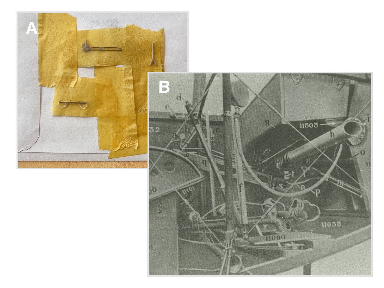

Small parts, with modifications—
In the case of the elongated piece of aluminum attached to the throttle and the stirrup post, these are repairs first. I glued these parts in place then started asking questions about how the cockpit really should look; pulling parts out weakened them so replacements were made. In A: throttle and assembly were made by cutting out the plastic part and replacing it with bent brass rod, adding filler with CA; the stirrups are brass rod and thin strips of plastic card; the control stick is still in progress—I’d like to add a grip to it if possible. B is the reference image.
