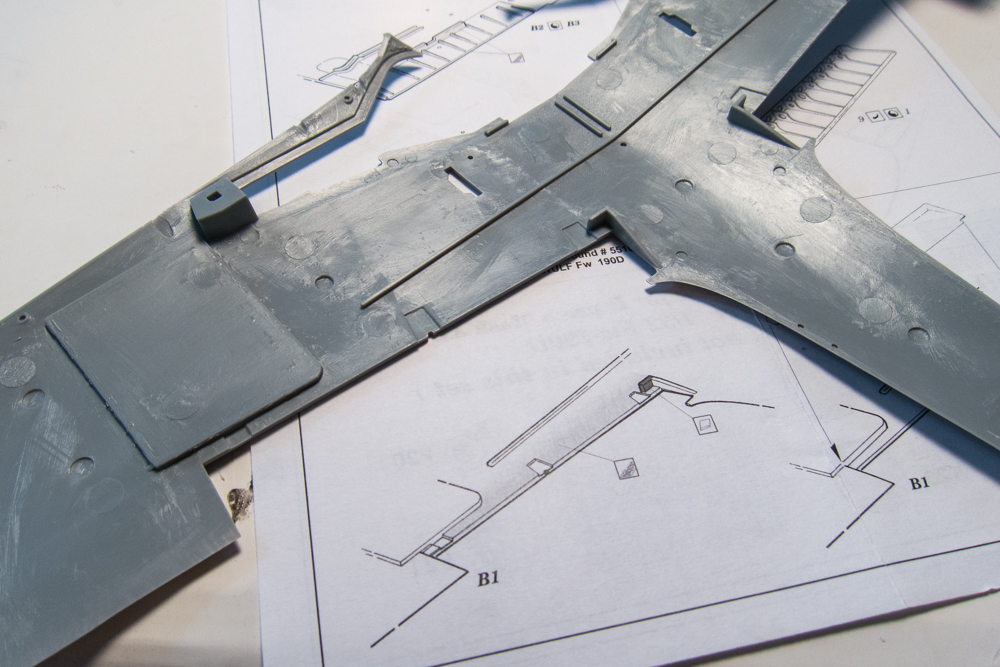

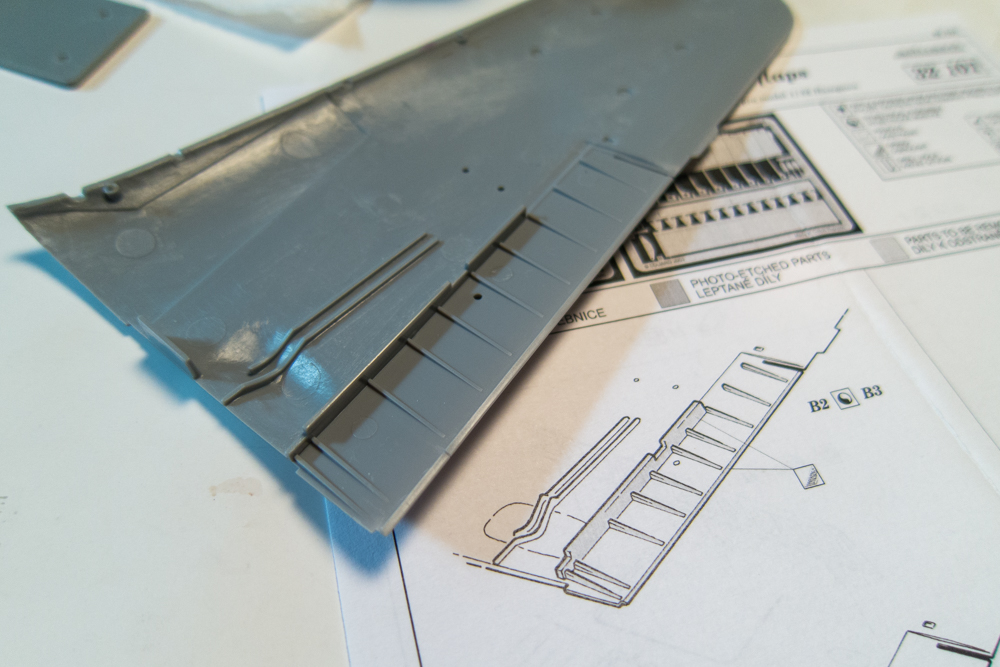

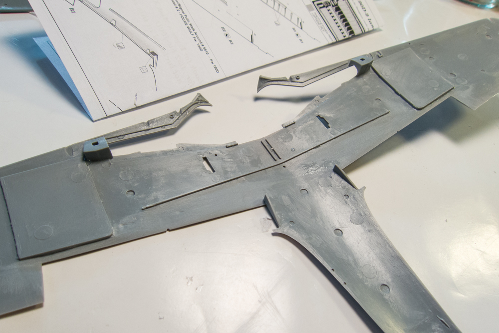

I decided to do some grunt work to keep the momentum going. Something not requiring too much thought... just time and effort. I'll be using the Eduard brass flaps for this build like I did for Black 1. That means some removals from the kit wings to accommodate the brass flaps.
The Eduard instructions show the necessary removals. On the upper wings, the interior flap ribbings need to be gone. The removal areas are all raised, which is relatively simple to do.
I use my pair of Tamiya cutters to snip away the raised ribs. A curved x-acto blade is used to slice away the remnants.
The curved blade is scraped across the trailing edge repeatedly to get rid of the raised edge. I used the same scraping technique to further remove the ribbing. Now the area is ready for sanding.
For sanding, it is important to use a coarse enough grit to cut through the raised remnants and flatten the area.
The top wings are finished.
The removals on the bottom wing are a smaller area (see shaded area on the Eduard instructions) but take much longer to do since I have to drop a narrow area down "one level", which will essentially remove the three square recessed areas on the trailing edge of the flap openings.
This took me two sessions of scraping, slicing, grinding and sanding to finish the bottom wings. By "finish" I mean prepping for the flaps. The wing surfaces still need to be riveted.

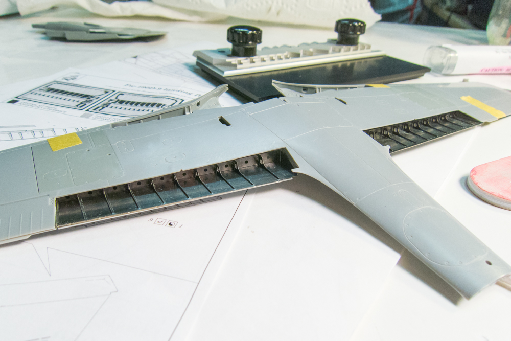

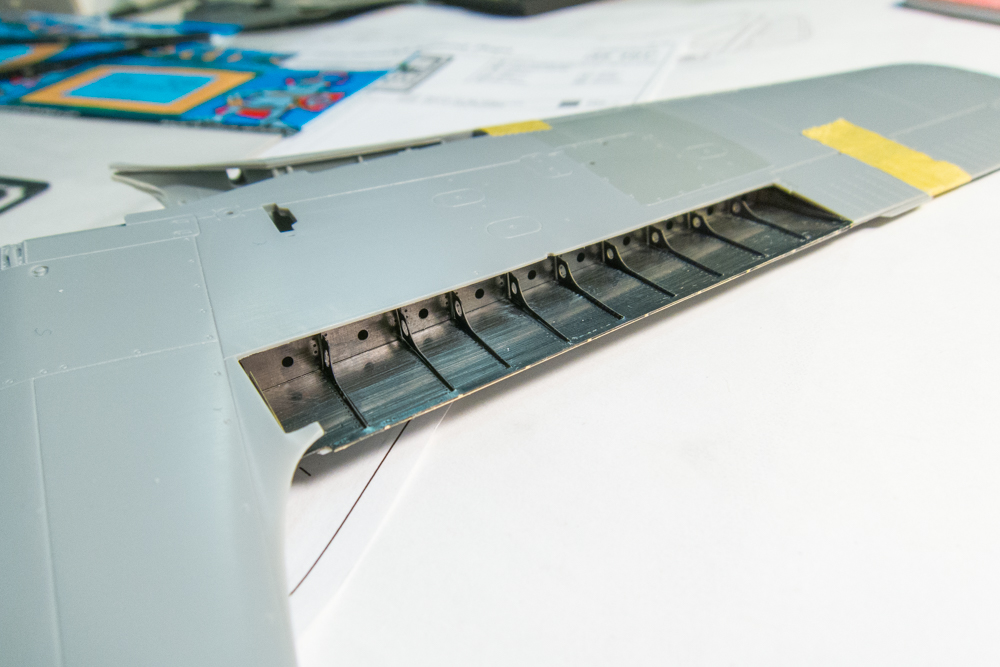

Tinkered around with the engine plug... mostly thinking about it. I was pretty happy with the result from Black 1 so I'll probably follow the same general game plan but just add to it incrementally.

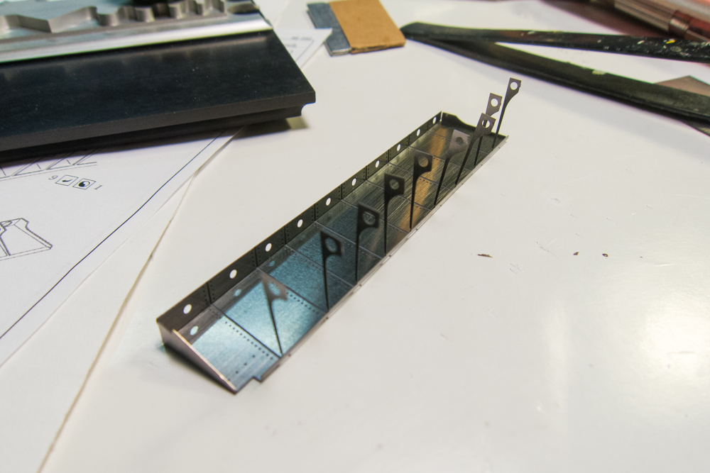

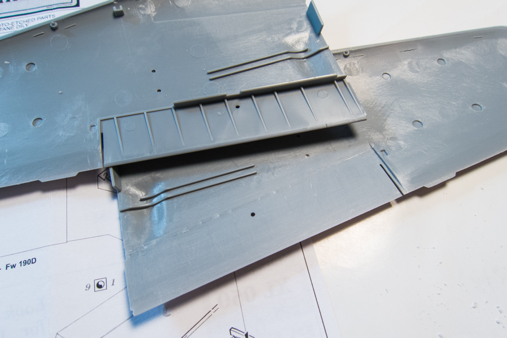

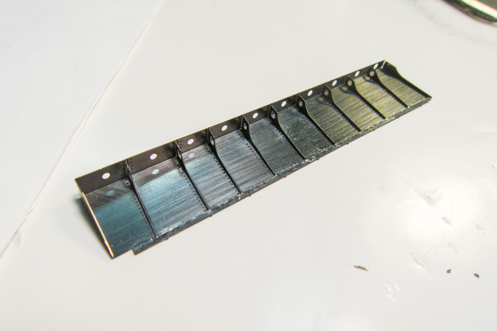

In the meantime, I decided to cobble together the upper brass flaps to see how they fit into the previously modified wings.
A PE bending tool is help to get uniform bends. This one is from The Small Shop.
Careful handling is necessary with these PE parts due to the delicate connections.
CA glue is used to secure the ribs into place. After the CA glue dries, I'll clean up the excess with CA glue debonder.
The port flap seems to fit ok!
The other flap was assembled and dry fit onto the wings. Everything looks a-ok!

Finally—I’m trying to understand most clearly how you removed the excess styrene from the kit in order to fit the AM. This was so deftly done! What intrigues me is the way you eliminated the existing forms on the interior edge. What is most interesting to me is how your results eliminated the raised interior without stressing the plastic; that combination of finesse mixed with results like these is potent!
Re: 1/32 Hasegawa Fw190D-9 Red One
Hi Bruce! My parents have flown in from Hawaii. My sis and her family will be arriving on Tuesday, along with my daughter returning from Berkeley. We're all going to a cousin's house in Irvine for Thanksgiving dinner. My mom is the oldest of 12 children and so I have lots of relatives on that side of the family. I hope your Thanksgiving is blessing filled and that goes out to all of the posters here at SPAM.
Plastic removals are not my fave thing to do. Especially the thinning of a flat surface. It's a drawn-out process and I've only shown the beginning and the end so it looks neat and tidy. It's not. In the middle, there are a bunch of rough cuts and grinds with plastic shavings and dust all over the model, my fingers and my lap. For thinning, I usually use a combination of (a) scraping with a curved x-acto blade, (b) sanding with coarse grit sandpaper and (c) grinding with a stone bit on the Dremel. The Dremel is a last resort and not ideal since even the lowest speed on my tool results in melted bits of plastic.
