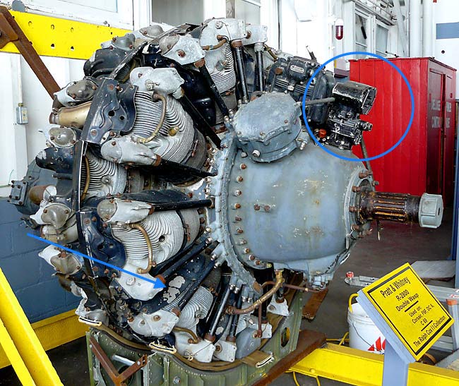

At least two colors of blue appear to be used—
Thanks for the photo, Bruce! That's definitely a R2800 but did it reference a version? The shape of the distributors tells me it is a different version. The circled item in your photo is the prop regulator, which is in front of the magneto based on what I learned just yesterday.

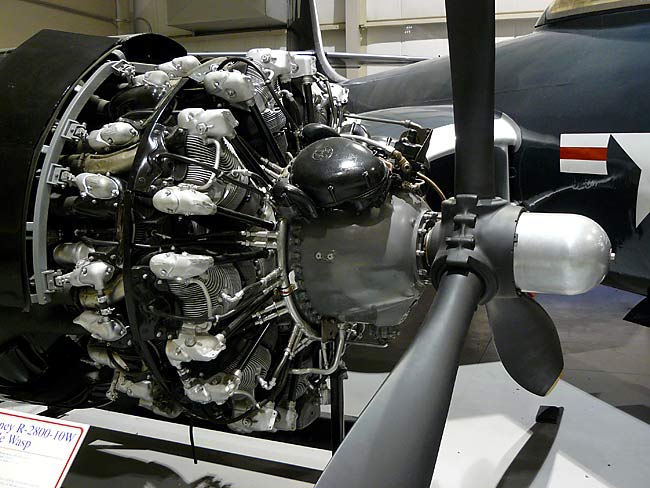

I think the engine in my F4U-1a is a R2800-8W with the elongated tear drop distributors. The closest I can get online is this restored R2800-21...
Which is similar to this restored R2800-39...
Both of these have magnetos that look similar to the Vector magneto but I don't know how relevant it is to my F4U-1a Bu No 17740.

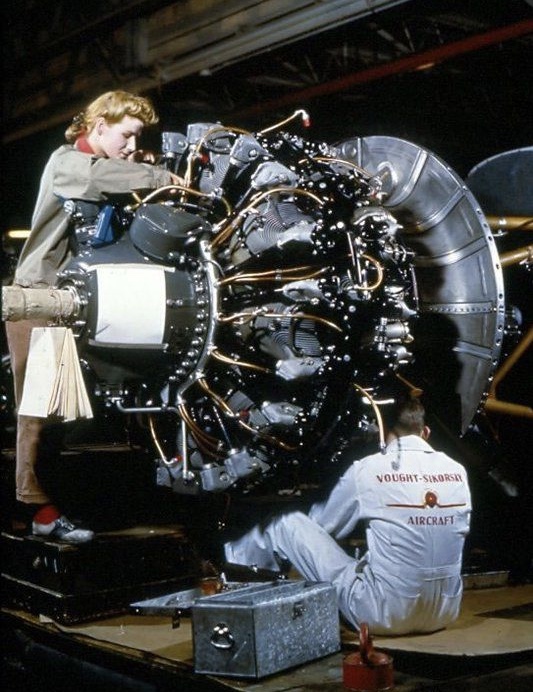

Apologies! Here’s a period photo!
That was low-res. I can do better. I have a folder of WWII color photos with a sub folder on that engine. The U.S. used it in so many aircraft.
10-W!
That period photo is FANTASTIC! It doesn't look colorized. And it's a Vought factory with an R2800 with the right distributors... definitely taking notes here, especially the colors. This will become my color reference since I consider it more valid than a restoration.
