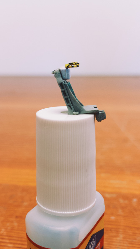

Thank you both! Apologies I am working two different jobs at the moment and am really tired. Caffeine is failing me. It is time for an energy drink.... I want to add the handle but Dragon’s version is the wrong type for the Vigilante—I think it would be correct for another aircraft type but not this one. Also the seat is close to the canopy so I have to slightly flatten the grab handle to keep it from touching the edge.
Today I painted the detail parts—headrest-head curtain in white, seat cushion in RLM 65 which looks quite good, and yellow orange on the hand grips. Once this cures I will add the black stripes with Molotow or Gundham 0.3mm black marker.

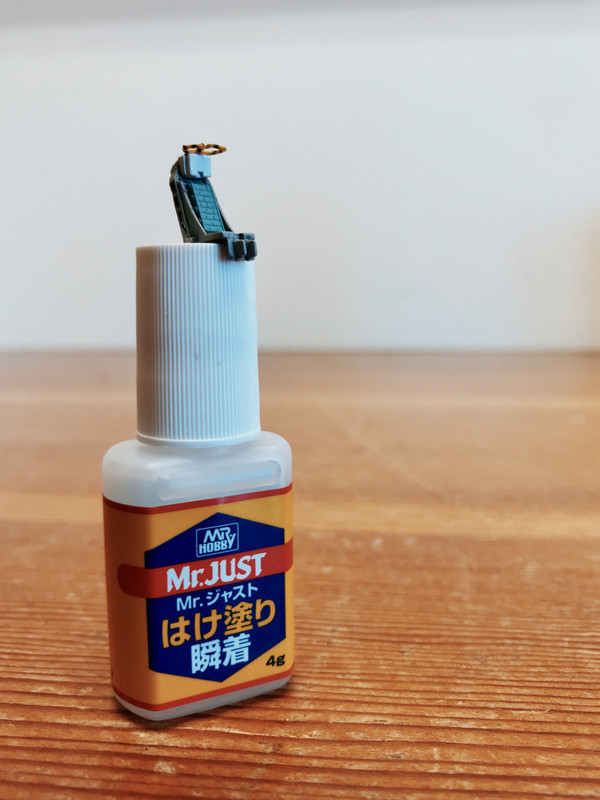

Re: 1967 Monogram 1/72 US Navy A-5A Vigilante.
Stuart!
Thank you and keep the camera.
Mock-up for colors / haze grey, yellow-white and RLM 65 Blue on the kit version of the cushions!
Thoughts?
Tape belts and greeblies are next up.
Thoughts?
That is blooming brilliant Bruce - I've seen kit seats that weren't as good as that! I like the colours.
Ok, I’ll chime in with what the colors are called, and you can pick what you like...
The seat cushion is in a color called sage. A greenish gray, with some blue to it. Something like Tamiya Field Gray, or Humbrol Slate Gray will work. The metal seat pan and frame are Dark Gull Gray. That has been the standard US aircraft interior color from the 50’s until the 21st Century when black came into the mainstream due to aviators needing to use night vision goggles. The seat base looks to be a khaki OD or some similar brown shade. Harness straps are also sage, but due to their fabric and weave, are a darker and more satin shade.
