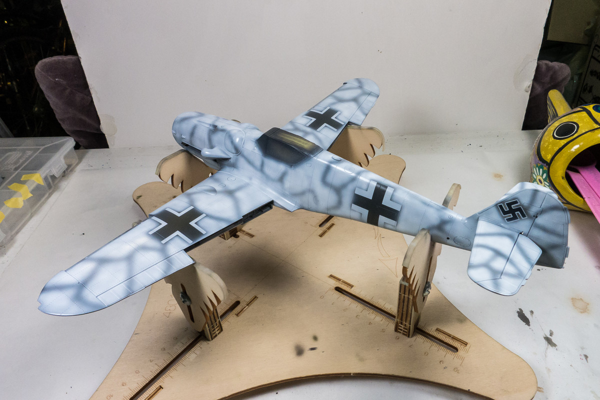

With the Shiden Kai in wait mode as the HGW seatbelts are en route from the Czech Republic, I finally pushed myself to put the white wash finish on the G-14. I decided to apply chipping fluid (MIG Heavy Chipping) to all of the upper surfaces to try and create wear on the white and that was a mistake. For some reason the fluid decided to pool into little balls as if I had waxed parts of the 74/75 finish. I tried dispersing it with water and MIG Scratches Effect fluid but I couldn't get it to level out. Hairspray and the various chipping fluids tends to evaporate without leaving a physical trace but I now knew that the treated areas were not completely covered. So after the chipping fluid dried, I pressed on with the white.
As feared, the chipping didn't work out very well. Because the white coat is in blotches and not uniform, the chipping aggregated in the dark areas where the white paint is the thinnest. And so I started to develop a pattern of chipping that followed the edges of the blotches... not a good look. So... avoiding the dark areas and concentrating on just the wing roots, I did as much chipping as I could and then started repairing the other areas. After the originally chipped areas were repaired, I tested out applying chips with a sponge and got acceptable results. So that's the direction I'm heading in right now.
Not what I had envisioned when starting this project but modeling is often an exercise in adaptation. The chipping will be developed slowly so I'm not worried about the haphazard and incomplete look of it now.

Tape only works if the the top layer of paint is on an unstable foundation. Which is something that most modelers try to avoid. However, the chipping fluid purposefully adds instability to that top layer. Dissolving that fluid layer with water dislodges the top paint layer into fragments and the result is (hopefully) realistic paint chipping. In my case, the chipping fluid beaded up on the base surface and created little dots of unstable white paint. Which can be lifted off by adhesive tape but it doesn't look good. The dried chipping fluid is also elastic and will pull off paint in bigger than desirable chunks. So I'm going over the model with micromesh, trying to create small areas of wear and encountering pockets of the chipping fluid, which is pulling the paint off in big chunks. These areas are being addressed by tape pulling/micromesh to remove as much of the unstable chipping fluid layer as possible even down to the plastic in certain areas. These areas will be repaired with RLM 74/75/white. It's a not a great situation but I dug my own grave on this one.

I didn't put a gloss coat over the RLM 74/75 but the AK Real Colors are semi-gloss. Typically, chipping fluid is applied over metallic paints which tend to be on the smoother side too so I didn't really think the 74/75 would present a problem. The areas where I burnished the cross markings down with Micromesh exhibited the most beading so I think the smooth finish and not anything chemical was responsible.
Here is an example of some of issues I'm dealing with. If the effects were on a smaller scale, I'd be able to utilize them but the areas of white paint that were lifting were too big.
These areas were resprayed with RLM 75 and the white overspray was re-established over that.
Concurrent with the repairs, I've been trying to push ahead and have painted the the yellow areas under the nose and the yellow ID band around the rear fuselage.
No masking problems for the yellow areas but the black chevrons revealed some new repair areas.
