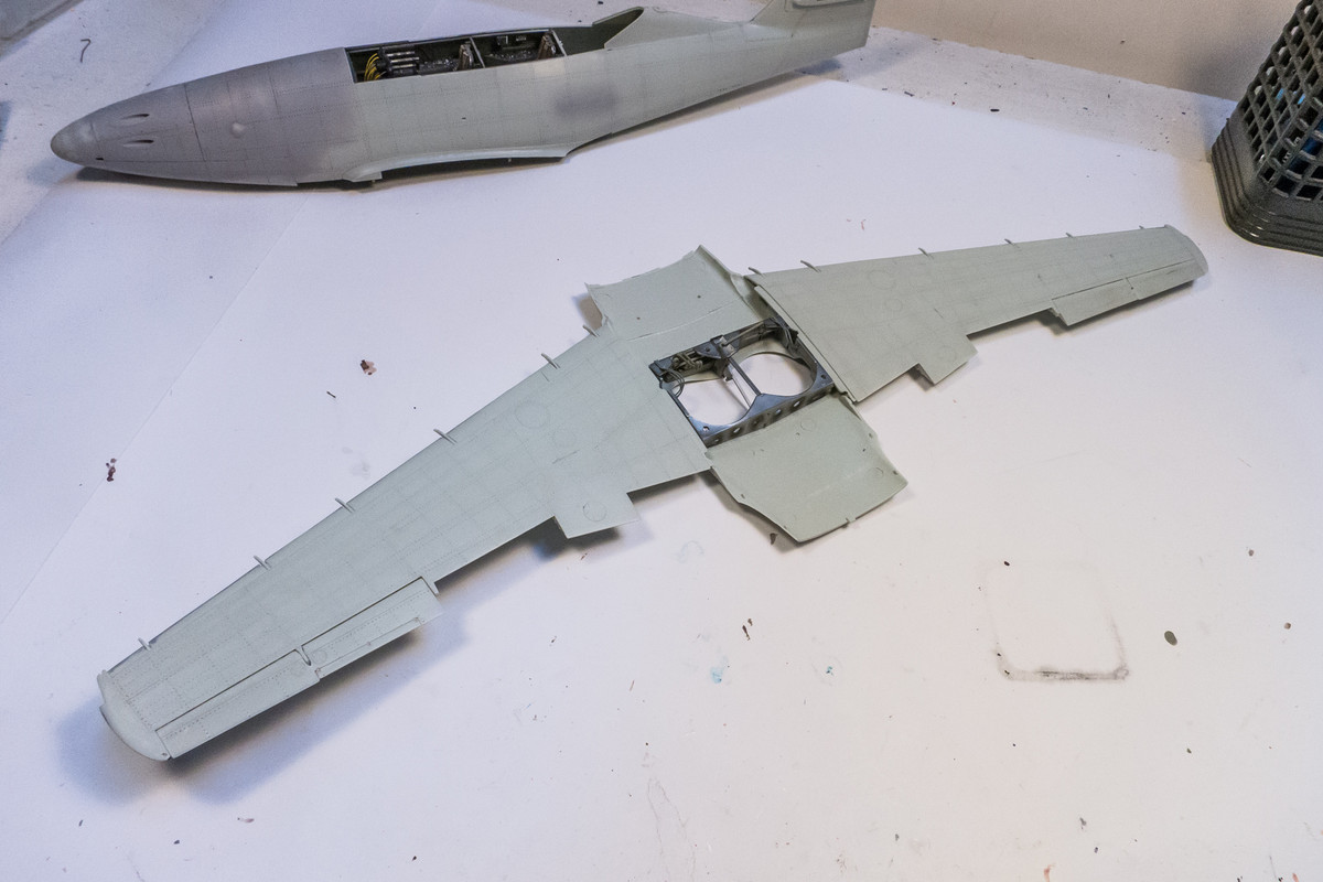

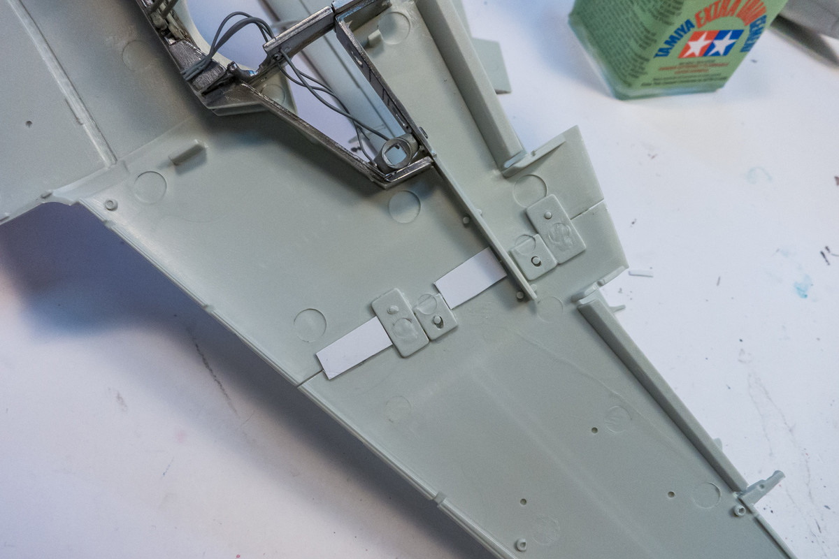

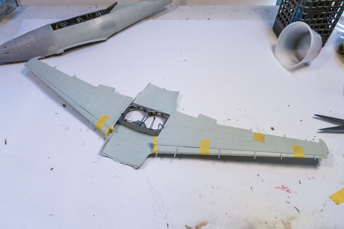

Thanks guys! Getting some good progress on the 262! The outer wings have been glued into place. Although the fit is pretty positive due to the tabs, I beefed up the contact surfaces by adding pieces of sheet styrene. It may not be necessary since the engine nacelles will probably add to the strength/stiffness of this area once they are glued into position.

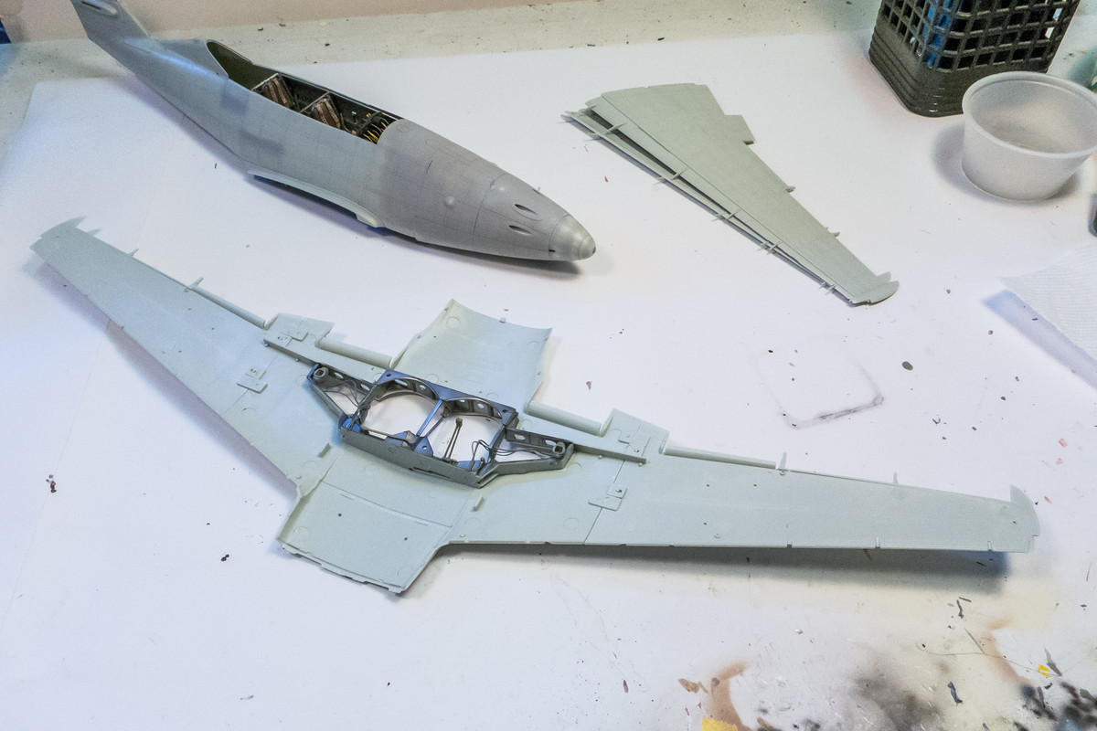

The upper wings can now be glued into place.
The ailerons have been glued into place but the flaps are still unattached.

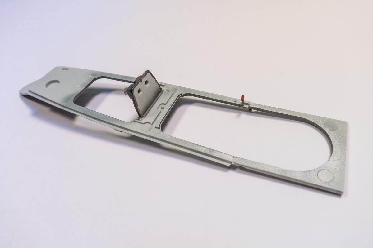

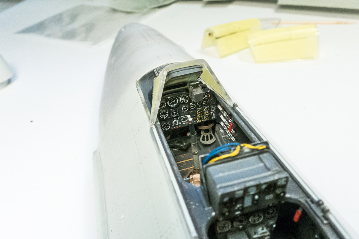

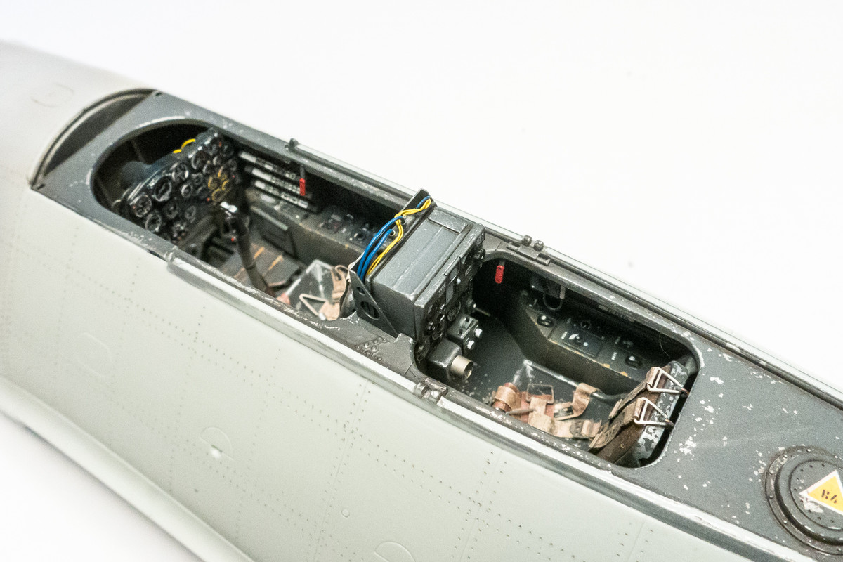

It's time to glue the cockpit sill in. The radio operator's instrument panel and the emergency canopy releases are glued in first. A piece of stretched sprue was glued to the back edge of the instrument panel to help it stay in place.

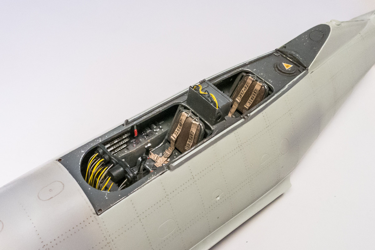

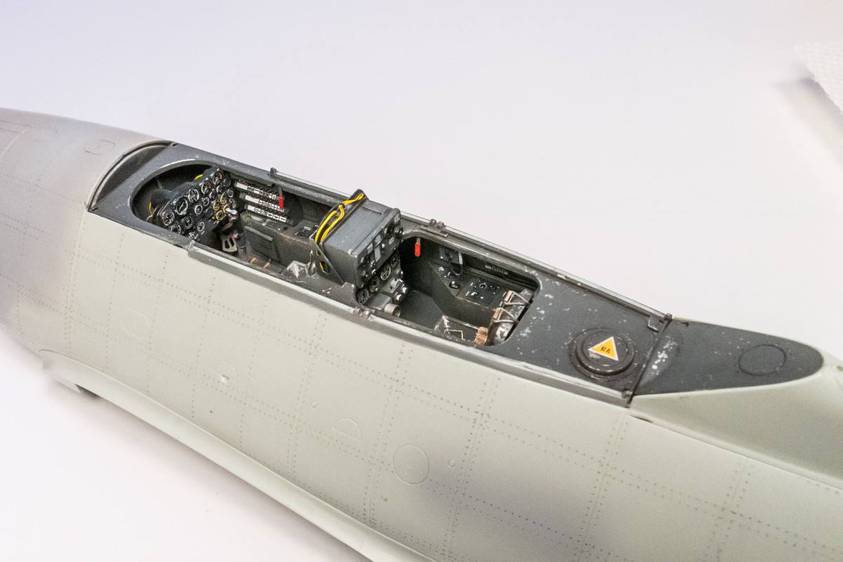

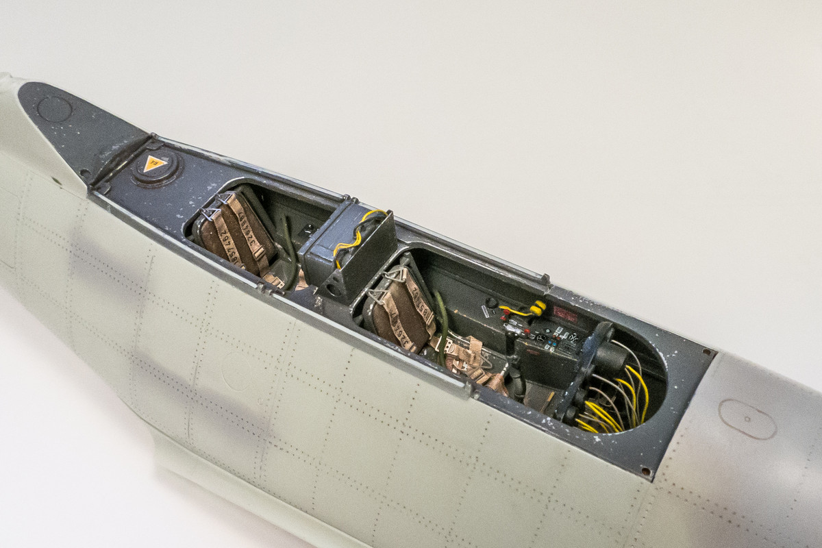

The radio has not yet been glued but we can take a look at the cockpit with all of the components finally in place.

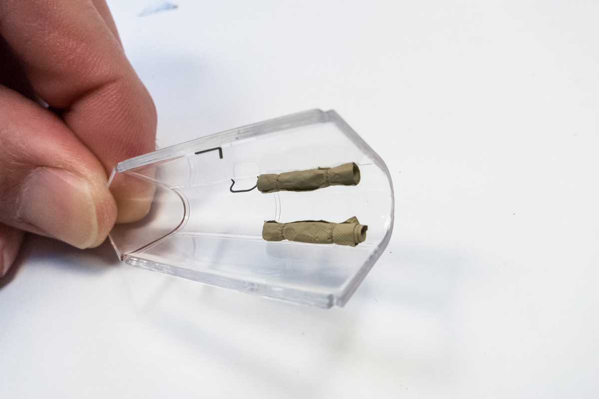

I'm thinking about adding the curtains that were used by the radio operator. The first attempt was not successful as the foil that I chose initially was too stiff. I settled on foil from a candy wrapper and got better results. Not sure what the color of the curtains were but I sprayed them with a light khaki just to see what they would look like painted.
I'm guessing the curtains was so the radio operator could keep his night vision? Riding back seat to a fighter pilot blind in the dark had to be one scary job. Probably along the lines of a EWO flying backseat to a wild weasel.

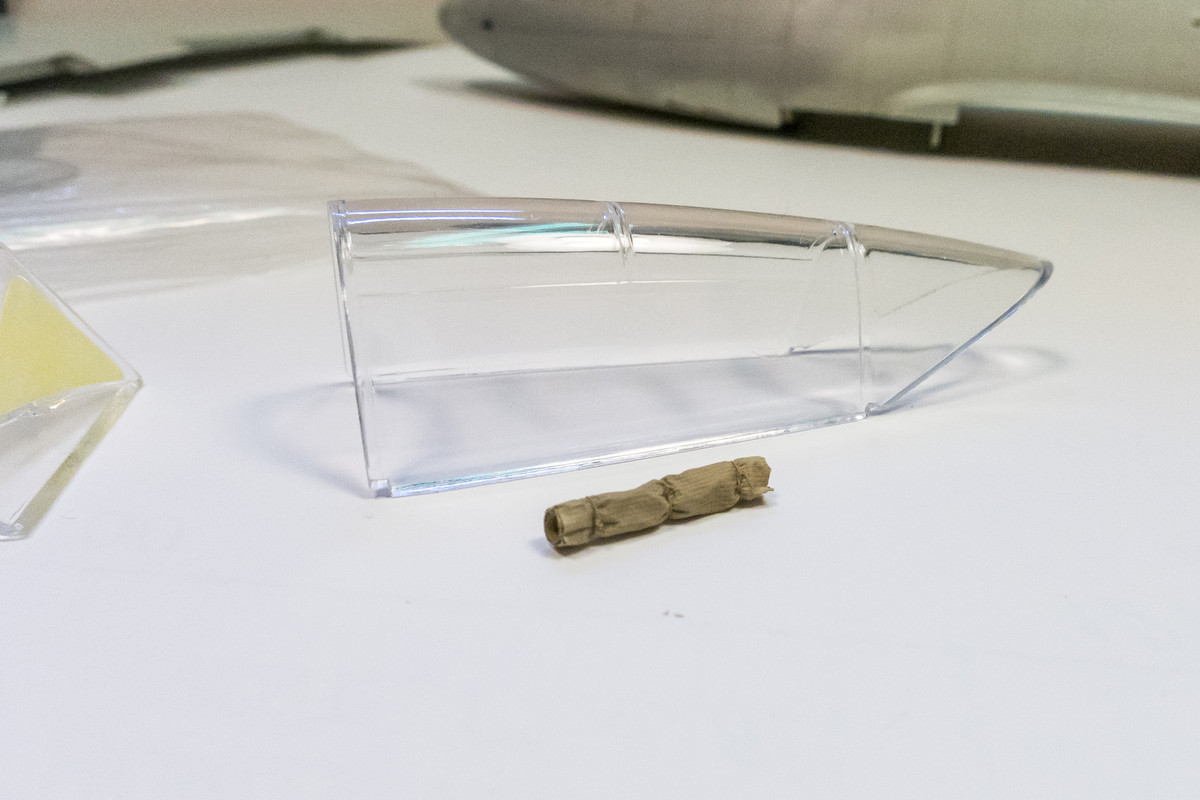

Using the same candy wrapper (Ferrero Rocher, if you must know), I re-cut the curtain pieces so that the crosshatch texture would be at an angle.
I used dabs of white glue along the canopy frames to attach the rolled-up curtains. Hopefully, I've avoided any visible glue marks.

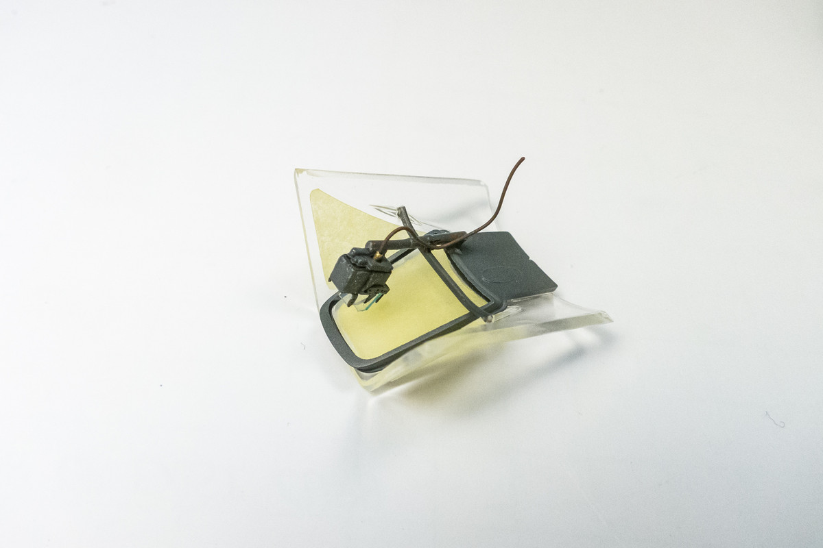

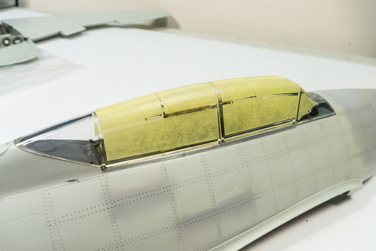

I started masking the clear pieces using the wonderful Eduard masks. The armored glass was previously masked and painted in dark grey (RLM 66, Mr Hobby Aqueous) and was glued into position after the windscreen masks were applied. The Revi 16C gun sight was glued into position at this time.
Before the clear pieces were glued into place, I made one last adjustment to the radio, which was finally glued in. The radio leads were painted dark blue, although I kept a random strand in yellow just for visibility.
