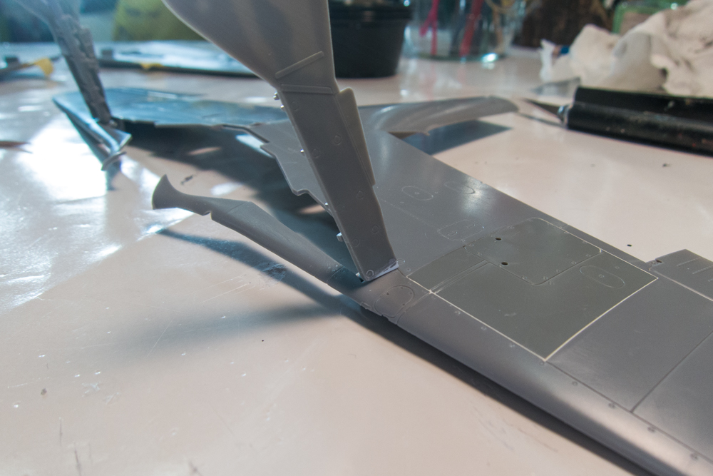

I'm modifying the landing gear doors by adding small shims. On the real Dora, the upper end of the landing gear doors tucked into the gear wells when the landing gear was down. I can't represent this without major modification of the wing in direct vicinity of the gear leg mounting which I really don't wanna do. So I'm simply reducing/eliminating the gap between the door and the wing.

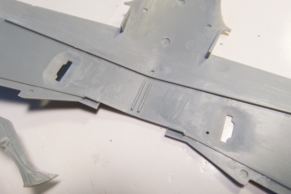

The ammo ejection ports on the wing bottom have been thinned out with the help of a Dremel and stone bit. I should have done this AFTER I've riveted the wing bottom. Now I have to be careful around this thinned area when I do get around to riveting.

Good morning, John! Regarding the thinned ammo chute areas, I suppose you could tape in a section of sheet styrene as a backing before you begin the riveting. At least, I think that’s what I would suggest as a way to protect the edges. Just a thought from the peanut gallery, though! What do you think?

I like Bruce’s idea using a styrene sheet taped down for any additional riveting needed. It will give you a strong stability and protection from current rivets/thinned chute areas from being lost or damaged.
Well thought of, Bruce! I would never thought of that. :shoutout: :shoutout: :shoutout:
Re: 1/32 Hasegawa Fw190D-9 Red One
Thanks guys! Reinforcing the thinned areas is a GREAT idea. I didn't think of that either and I'll definitely make use of that advice. Thank you Bruce!

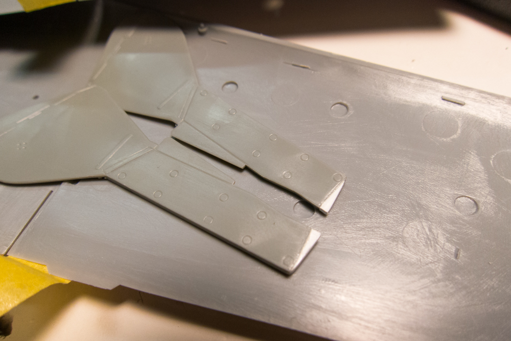

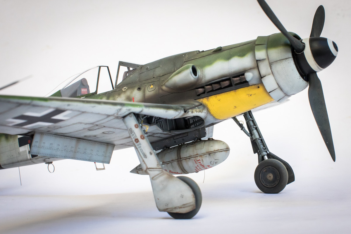

The shims on the landing gear doors have been trimmed to fit. I don't have a before shot but you can see from a previous build the small gap between the landing gear door and wing that I am trying to close.
I've also gone the extra step of riveting the landing gear doors this time.

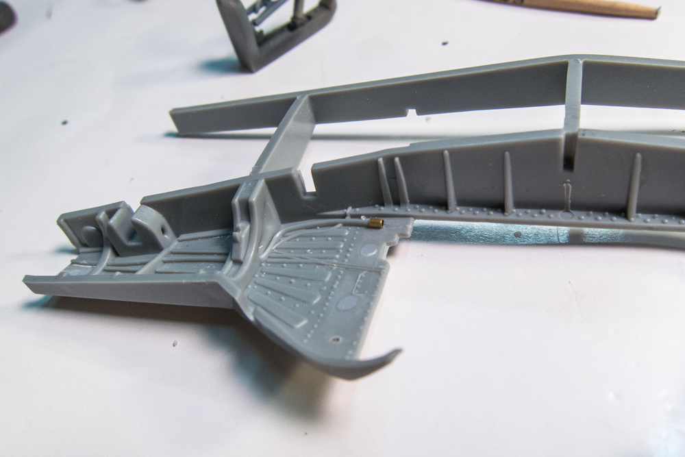

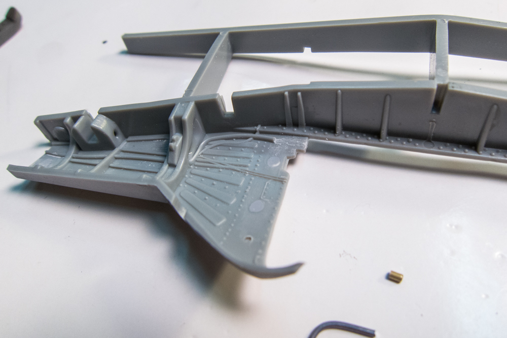

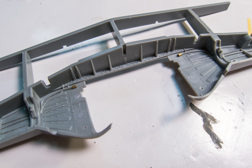

One little thing that has bothered me on my previous Dora builds is the ducting detail molded into the wheel well. See that thick duct/pipe that abruptly ends at the edge of the opening?
I've trimmed away a portion of the duct closest to the opening.

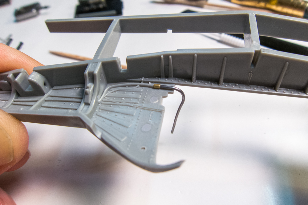

Then I glue in a small section of brass tubing to accept a piece of lead wiring.
Maybe not a 100% accurate fix but I think it will look a touch more realistic. More importantly, it will quiet that niggling little voice in the back of my head. The wiring will be added after I paint and assemble the wheel well area. The photos of this area reveal a nasty sink hole on the actuating arm (not wing gun) mount that I'll need to fill.

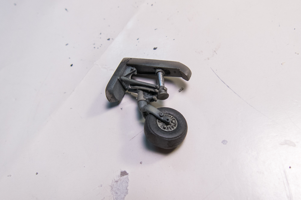

The resin tail wheel components have been painted and weathered. I am getting closer to the point where I can glue the fuselage halves together.

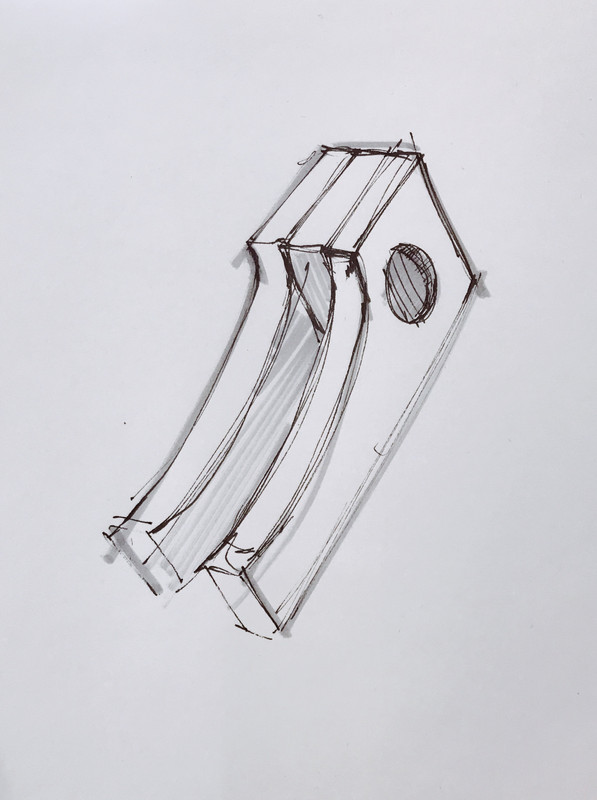

John—I do not have my Dora resources on hand but I believe the wheel well ribs are circular stamped, and it looks as though your particular wheel well piece has lost its center so to speak...
Let me know if this is correct—or if this needs to be revised.
Thank you Stuart and Bruce! Bruce... I also do not have any references on hand but what you describe so beautifully with your drawing is possibly true. Probably true. For me personally, it falls into that category of "nice to address but maybe not worth the effort to replace the ribbing in the wheel well". Some things I feel compelled to take action on and others, not so much. With the minor modifications that I am doing, I'm personally satisfied with how the wheel wells are going to look. At this moment, preserving my momentum on this build is a higher priority than 100% accuracy. Looking at my work as a whole, I think this has always been my approach.

No worries, John! Sincerely! I hesitated to even produce a sketch. As someone who completed one model in 1-1/2 years, I do understand momentum’s loss. There’s an interesting book I read in school called “The War of Art,” and like any Dora photos I don’t have the book on me, but I do remember the chapter on “Momentum” feeling as though the author knew me personally or at least he personally conveyed to a receptive reader that once you lose momentum you have to fight to regain it. Hence—war. However this was geared at those who make art a career so I do believe a hobby is much more tolerant of absence.

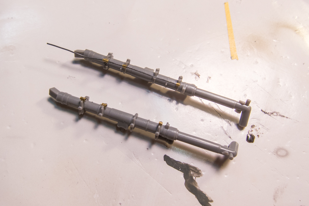

To keep me occupied as paint dries, I've added small bits of brass tubing to the landing gear legs to hold the brake line, which will be represented by a strand of lead wire. On previous builds, I glued the brake line before painting and the soft lead wire got all bent out of shape through the paint/weathering process. So for this build, I'll add the brake line after painting.
