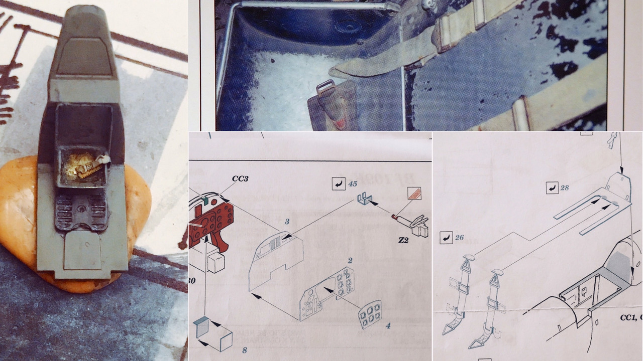

I am definitely basing this off of the very first profile of White 1 you posted, John! Thank you so much. The only issue I have is there seems to be no antenna mast in the photo...
I am thinking about asking the “Flugzeug” forum for details but if you have any ideas, please I can use em. I asked Carlos and Marius, too.

You bring me gold, John. That photo(s) is(are) everything. My planning goes like this—finish the cockpit IP and second lap belt then assemble the fuselage. Yesterday I made a sketch thinking I want to get that soft pastel blue which is late war and somehow not have it harden as various coats of weathering, gloss and clear go on it. No idea but I do think I will start with the cowling/engine section and assemble for silver basing, followed by late war sky blue in a sectional approach, then whatever the sky blue which looks light green is in the center, up the sides, followed by the grey top camo. I know it’s all technically camo but the grey top camo now makes sense as a preliminary stripe! Then follow it with squiggles.
What are your thoughts?

The fuselage fits with precision, and the areas where connections are made to the sprues are logically planned and practically require no finesse. Really. Incredible. If Eduard studied this... I have two frames aft where I sanded and polished, but that cowling is in three pieces and fits together perfectly. My plan is to mask the interior side walls to deal with these later and get on with the exterior. The cockpit will drop in from the bottom, and all that holds the cowling together are a few drops of PVA. I plan to mask and prime white the engine area and propellor hub. Then make a wee mask for the white stripe based on a tracing I made of the decal. Then on to the blue. I’m going for a very light blue, pastel and soft.
