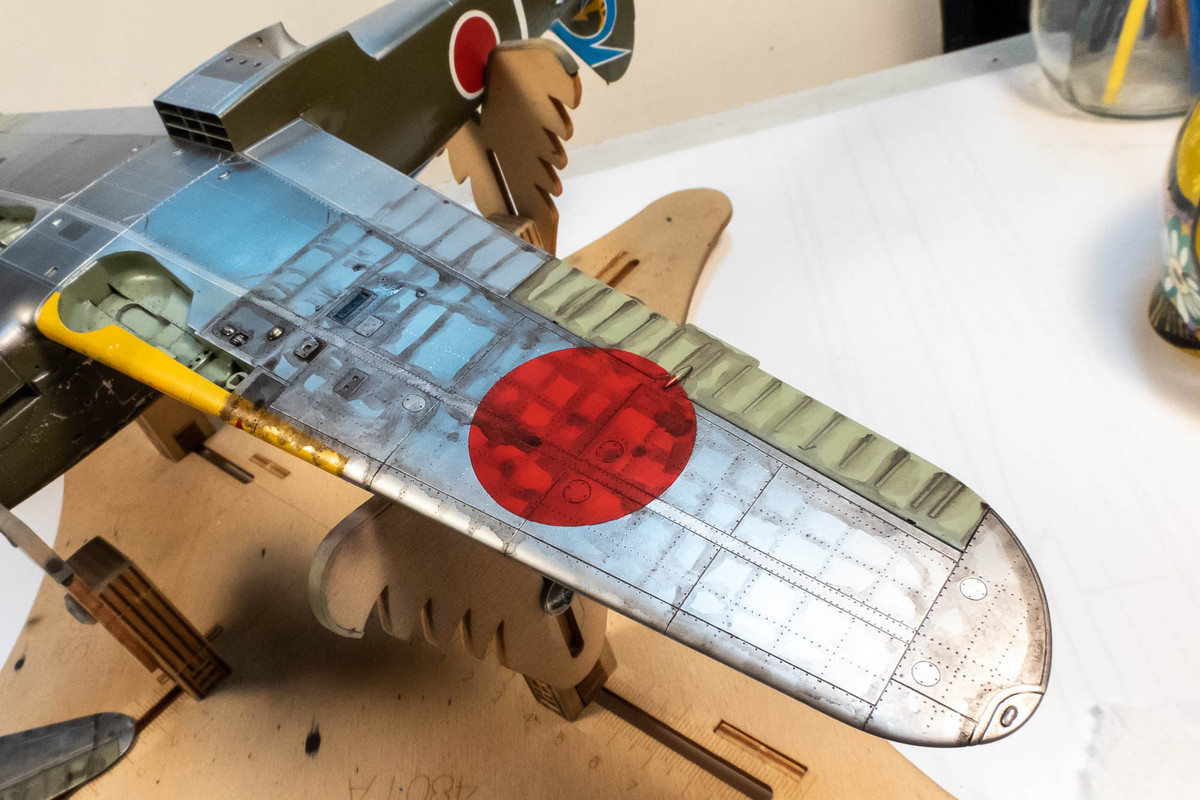

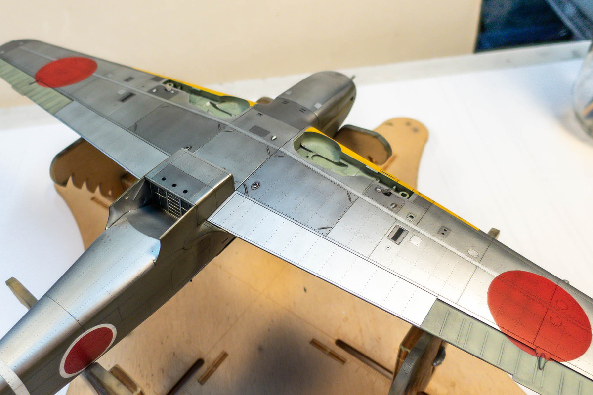

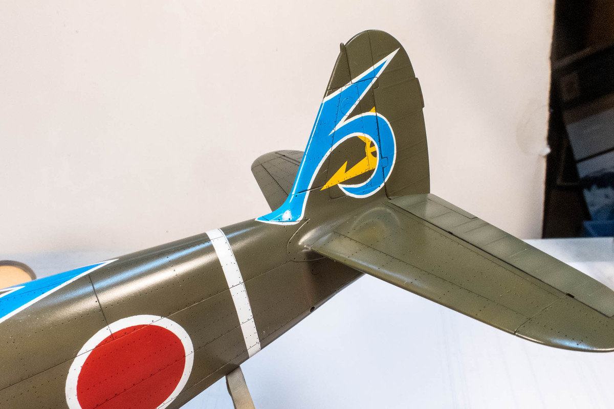

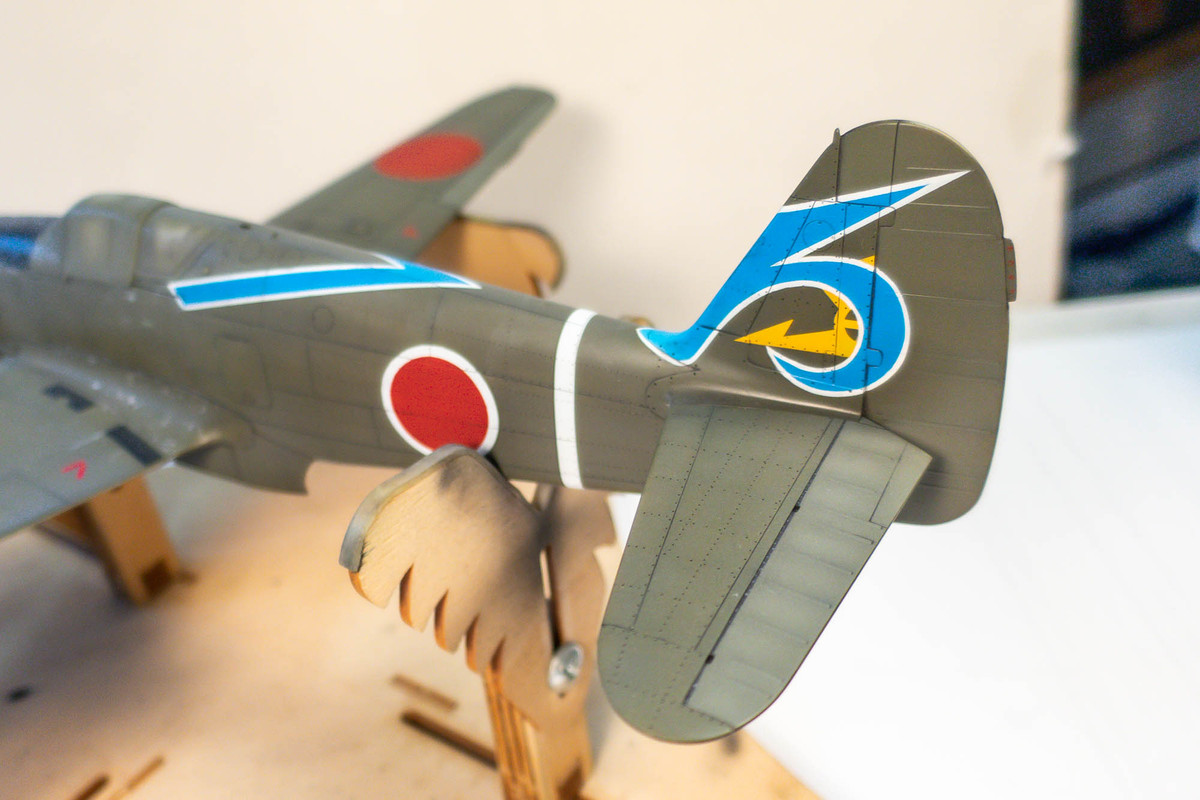

The model has been given a clear gloss coat and I put on the decals as well. The decals were few in number and tiny in size and not worth photographing. The next step is to give the model a pastel wash. I make my own washes with pastel chalk, water and a dab of liquid soap to help suspend the chalk particles. I used a single color, dark brown for both top and bottom.

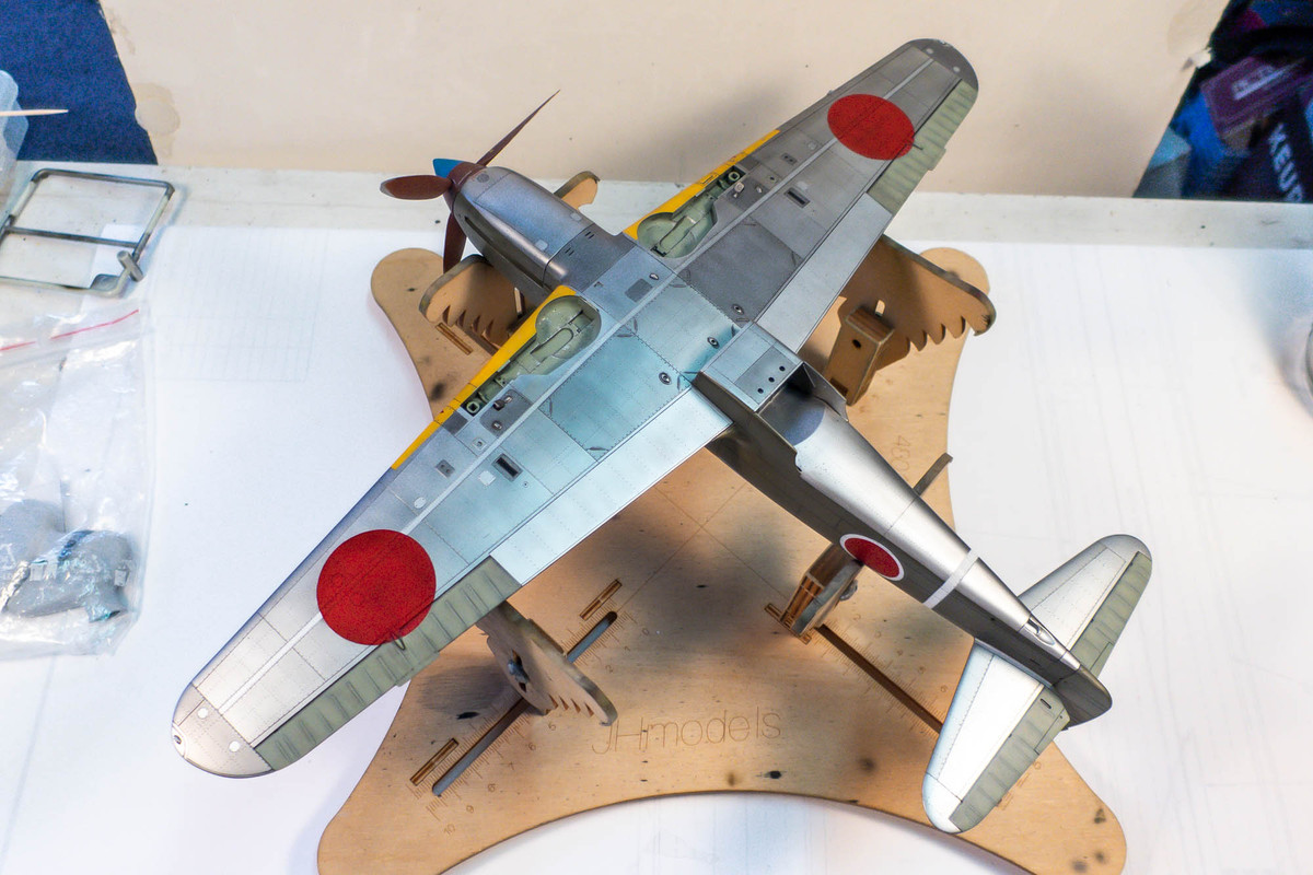

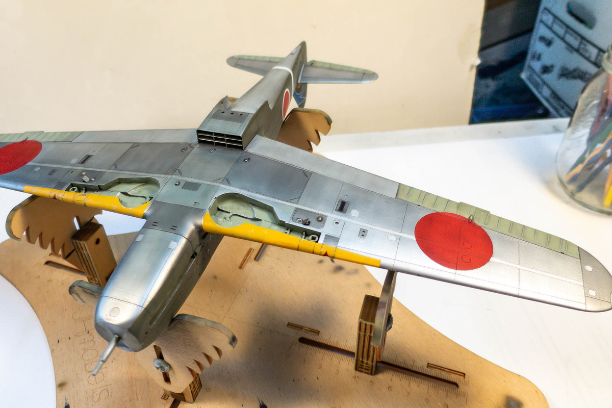

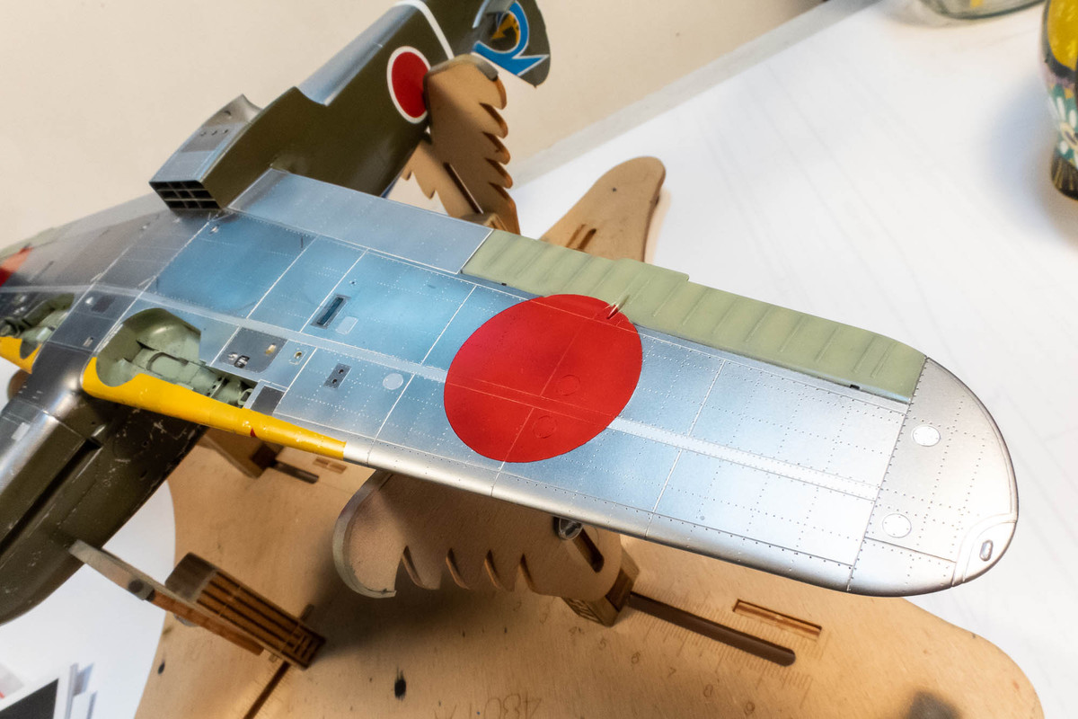

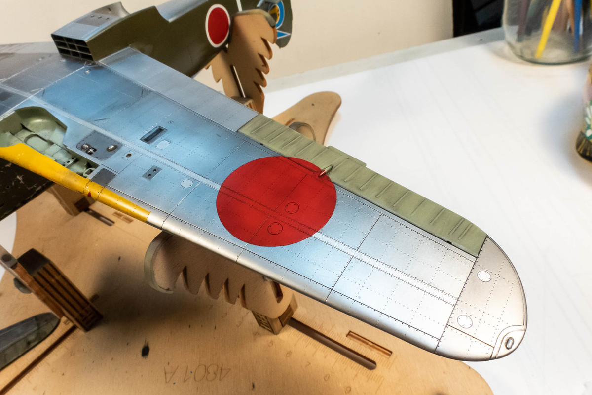

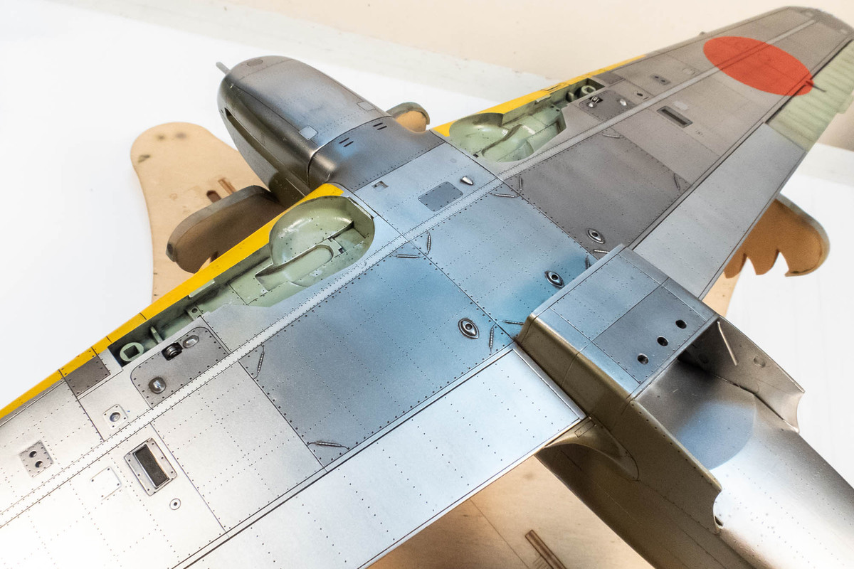

Here is the lower wing before the wash...

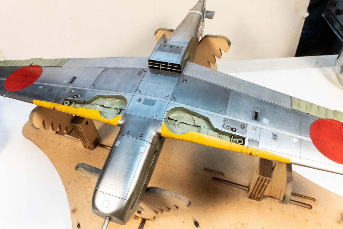

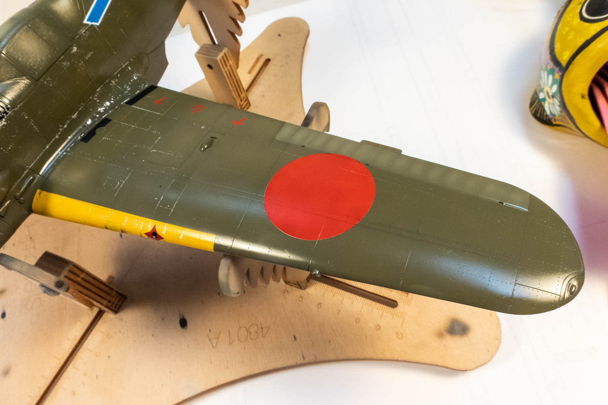

During the wash...

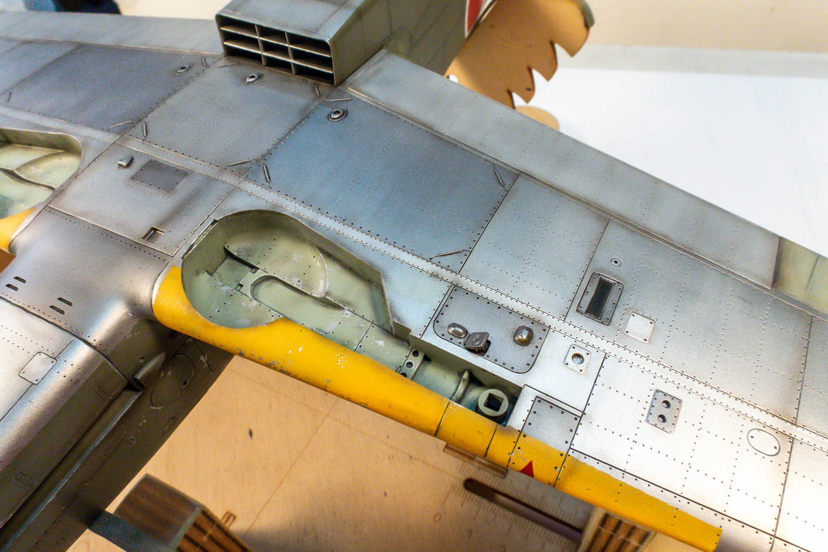

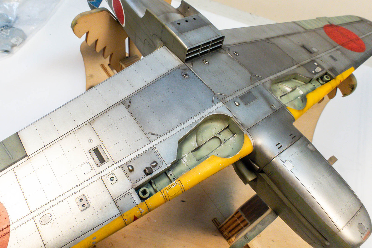

After the wash is wiped away...

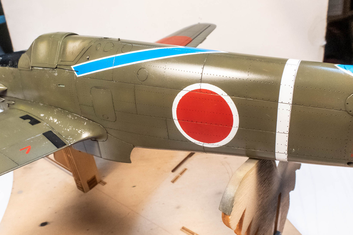

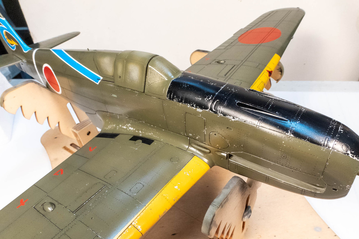

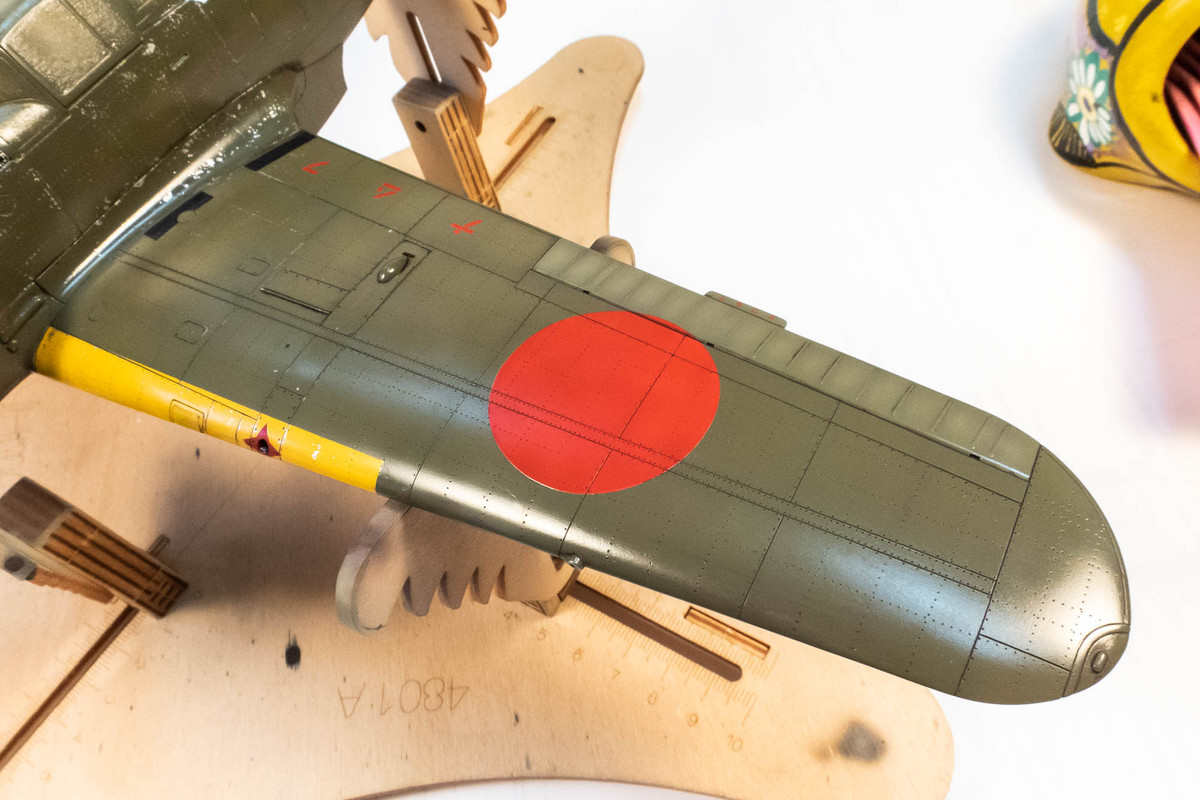

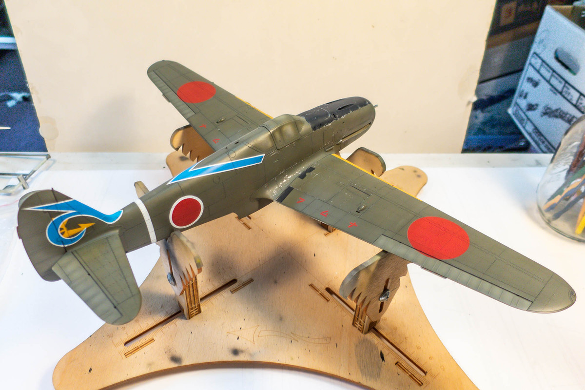

The upper wing before the wash...

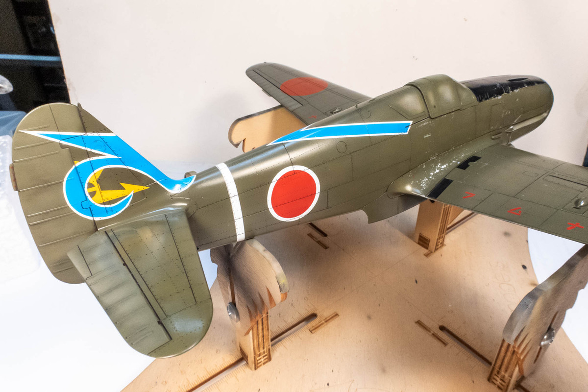

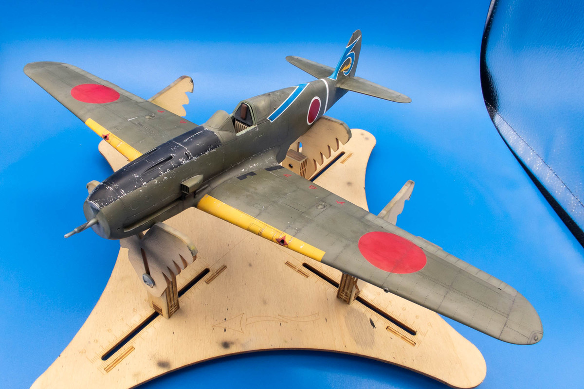

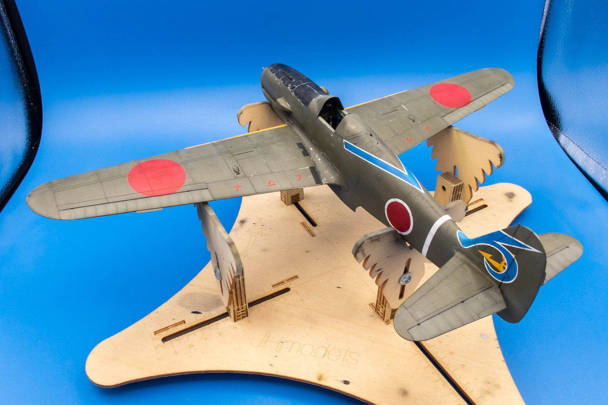

More views of the model after the wash...

All of that detailing is coming together beautifully.

Great idea with the wash.

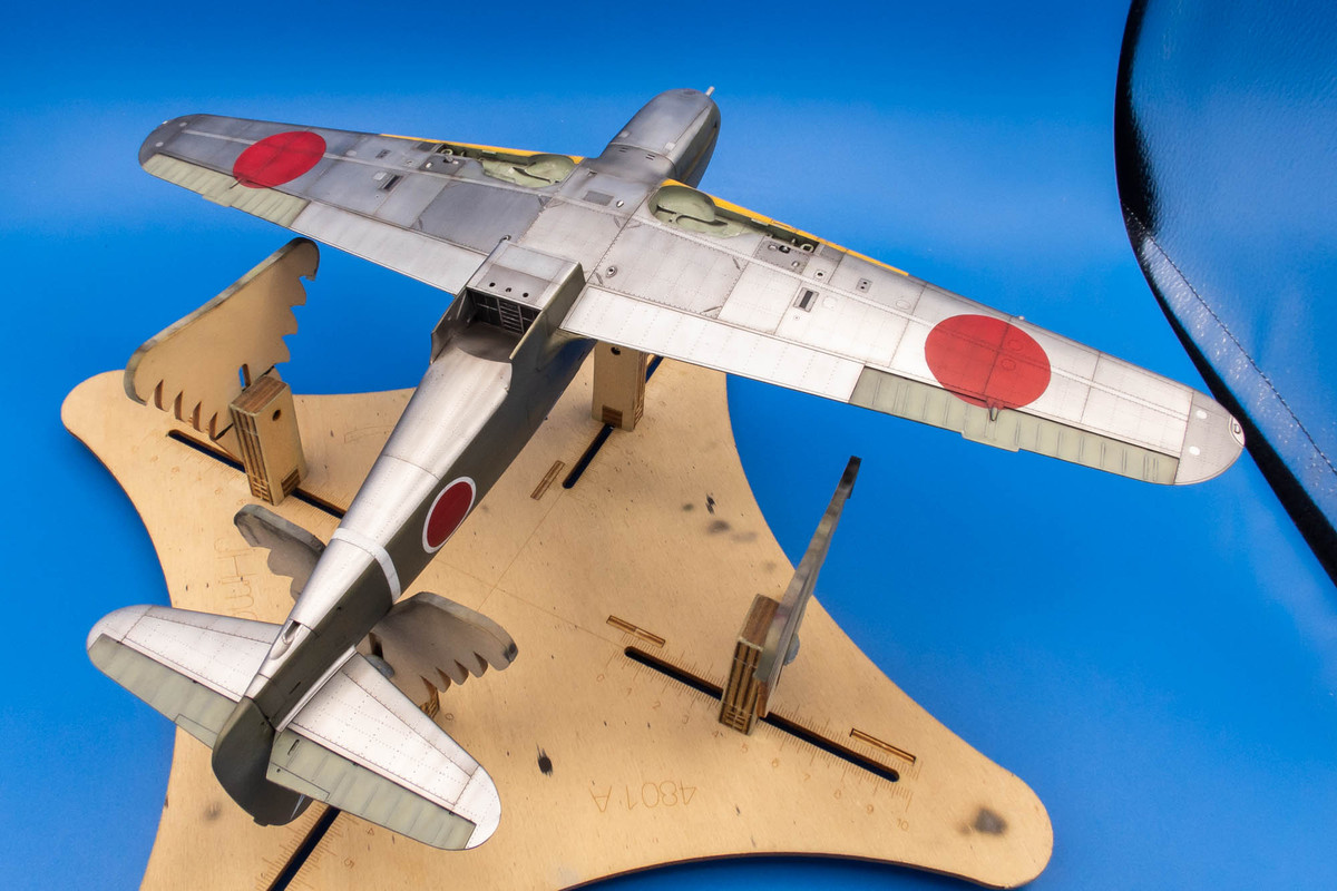

Anyways... back to the Hien... after the wash, I put on a flat coat. Straight Model Master Acryl Clear Flat on the top.
A 50:50 mix of MM Flat and Alclad Aqua Gloss on the bottom. The wheel wells and the fabric-covered ailerons got the straight flat.

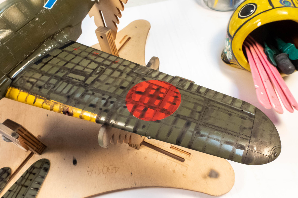

My first weathering step is to use a very highly diluted mix of brown and black and run it along the panel lines and joints. I also use it to create subtle streaking corresponding to airflow across the surfaces. It should be really subtle. If it is too heavy, I rub it away with Micromesh. The Micromeshing itself leaves interesting staining patterns too so I guess it contributes to the weathering process by way of partial subtraction.

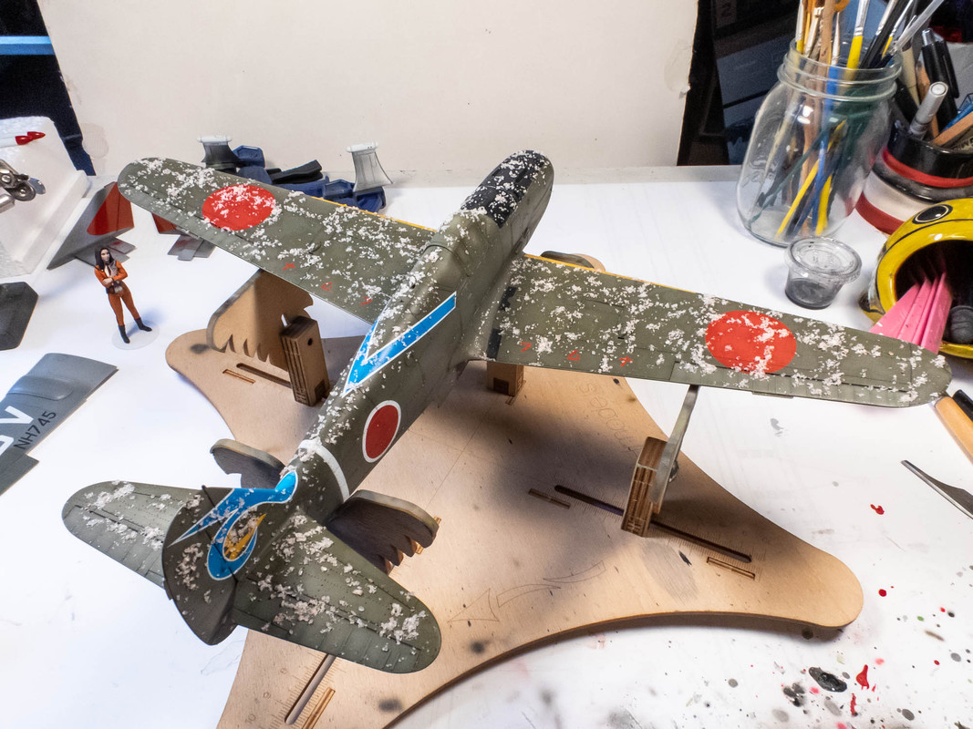

After doing a bit of post-shading on the top, I had to confront one of the bigger finishing hurdles... salt weathering. I don't think this technique is appropriate for every build but I think a worn Hien would benefit from it. Here is the model after the salt application.
After the salt is completely dry, I sprayed a VERY diluted lighter color (Tamiya Deck Tan XF-55) over the salt. After the salt is removed, you should have some random stains on the surface of the model. This is what the model looks like after the salt weathering step.
