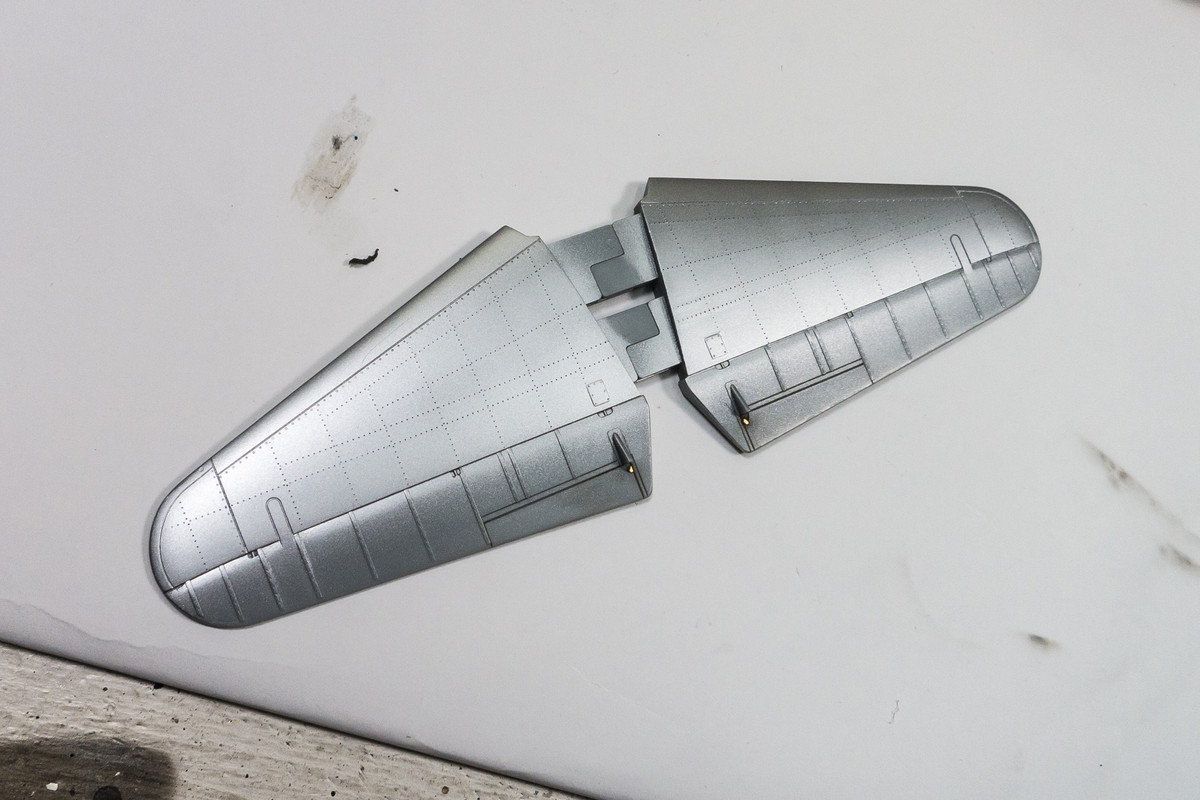

I've yet to finish the scribing and riveting on the bottom so I thought it would be a good time to test some ideas for the metal finish on the metal stabilizers. These parts are large enough where I'll be able to lay down some pre-shading texture but are small enough to be easily wiped if the paint test goes awry.
First, I applied my customary black pre-shading onto the stabilizer bottoms using a mix of freehand and scrubbing pad masks. I'm not aiming for high shine finish so I'm not too concerned with a perfect glossy finish for the preshading.
Using Alclad White Aluminum for the base metallic shade and found that, shot straight from the bottle, the color is translucent enough to allow the preshading to peek through.
Carefully modulating the application, I want to get rid of any hint of black color of the preshading underneath but leave behind some depth within the metal shade. It's hard to capture with a photograph but this effect is very interesting and promising.
I'm going to let this cure and then see how stable this coat is. I want to try and buff/Micromesh the surface and see how it reacts to a clear coat.

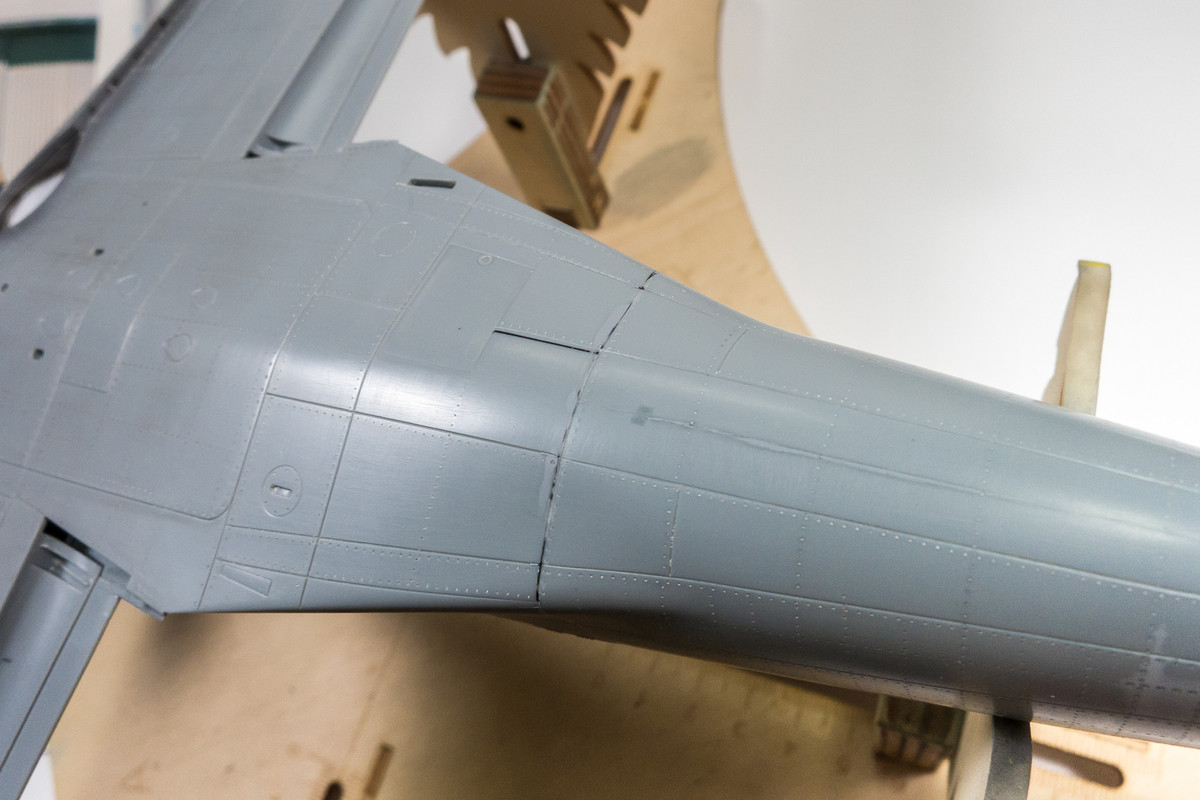

As I mentioned, I'm working on finishing up the seam between the bottom of the wing and the fuselage. The bulk of the seam was filled with black CA glue and the surface surrounding the joint was leveled out using Mr Surfacer 1000. The other black line is an errant panel line that needed to be re-scribed.
Once the surface was sanded and polished, the panel lines were re-scribed and rivets were applied. A thin coat of Mr Primer Surfacer 1000 was sprayed to check my work. The rough edges of the re-scribed panel line at the glue joint need to be smoothed out but overall, I am checking this area off as addressed.

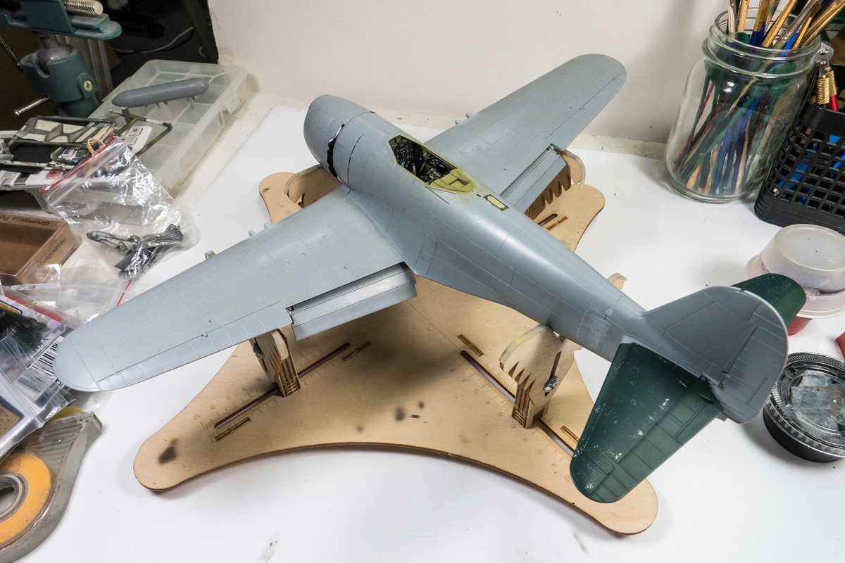

Back to the stabilizers. My work here will be a microcosm of the procedure that I'll be using to paint the overall aircraft. Previously, I played with using a mottle pre-shade and Aclad to create some tonal variation in the natural metal finish of the bottom, which turned out fairly well. The topside will be treated differently. The base will be metal to serve as a base for hairspray chipping. I like to use Tamiya AS-12 Silver, decanted from the spray can, in these situations. I simply squirt a small amount of the paint from the can into the airbrush cup, add a few drops of Tamiya Lacquer Thinner, stir away some of the bubbles and spray away.
A coat of hairspray is sprayed over the silver and allowed to dry. A mottle pre-shade is applied over the hairspray/metal layer.
My version of the Green was established when I painted the spinner a few months ago. It is a mixture of two AK Real Colors: IJN D2 Green Black (RC305) and Luftwaffe RLM 83 Blue (RC327) mixed at a 3:1 ratio. Straight IJN D2 Green Black is used on the fabric portion of the stabilizer for a slight color variation. The photo below shows one stabilizer after chipping. The chipping at this stage looks rather spread out and unrealistically random but it will be enhanced later using other techniques.
I'm going to use a grey/green color for the undersides of the fabric-covered stabilizers and ailerons. Tamiya JA Grey (XF-14), to be exact. I scanned the stabilizers and made a custom mask using the Silhouette Portrait cutter.
The mask allows me to apply pre-shading and the grey/green color without impacting the Alclad.
The basic painting of the horizontal stabilizers, top and bottom are finished.

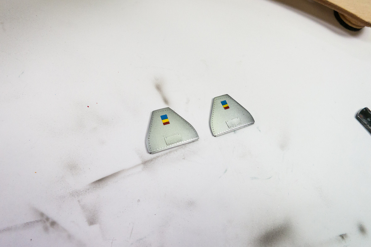

Hasegawa provides decals for the landing gear loading indicators. They don't correspond to the colors found in my references at all.
Since the decal sheet had been previously scanned to produce masks for the markings, it was relatively easy to make new masks for these indicators.

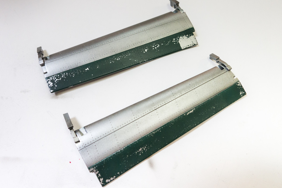

In my haste to paint the horizontal stabilizers, I forgot about the flaps. I am going to show the combat flaps in the extended position. These were deployed only in flight but I'm assuming that they could be lowered manually for maintenance if necessary. Maybe not typical or operationally realistic, they give the model a bit more visual interest.
Here are the flaps after painting. I lifted a big chunk of green with tape and that area needs to be repaired. I'm going to apply Micro Mask with a sponge to see if I can salvage some chipping.
Both the stabilizers and flaps will be sealed with gloss and further weathered separately from the rest of the aircraft.

Thanks! Forgot to show what the landing covers look like when placed on the landing gear legs...
