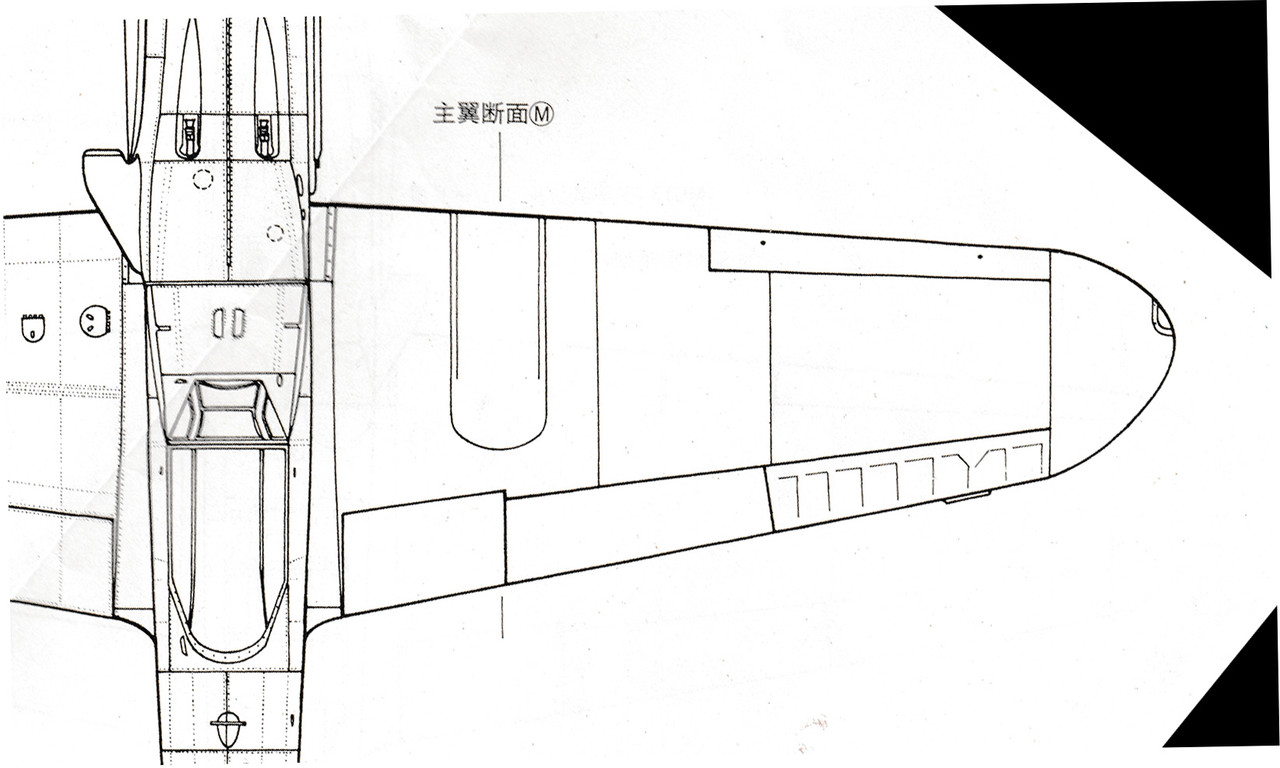

Interesting! Before you make any corrections, I think I'd have to first ask, what are we basing our corrections on? Here are a couple of scale drawings of the K-4 wing.
The first is from a Japanese publication (Model Art) that I have...
The second is from the 109Lair website. Disregarding the rivet detail, there are two additional panel lines that aren't shown in the Model Art drawing.
Not having access to blueprints or an actual K-4 to measure from, I don't know how accurate these are. Comparing the two, it seems like the main panel lines on the wings are in almost the same place in both drawings. The 109Lair drawing has those two additional panel lines but let's disregard those... no need to complicate things.

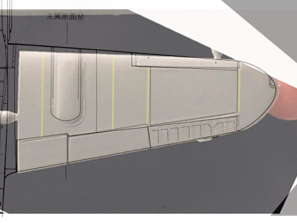

Now let's look at the Heller wing. Using a photo that Bruce posted, I've highlighted the panel lines and numbered them.
Superimposing the Model Art drawing onto the Heller wing, we can sort of see how things line up, considering the fair amount of error in trying to line up a photograph to a line drawing.
My suggestions would be, assuming that we trust the Model Art drawing to be somewhat accurate: delete panel line #1 (I feel pretty safe in saying that this panel line is fictional) and remove and relocate panel line #2. Panel lines #3 and #4 look close enough, in my book.

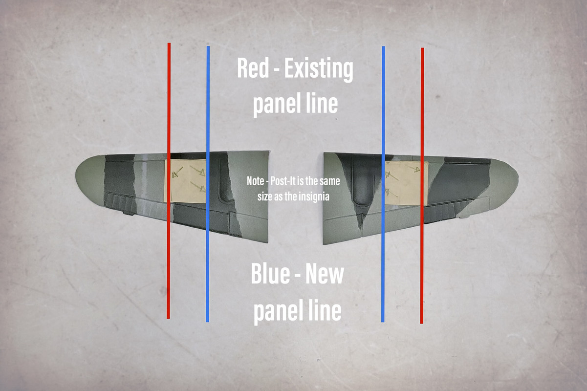

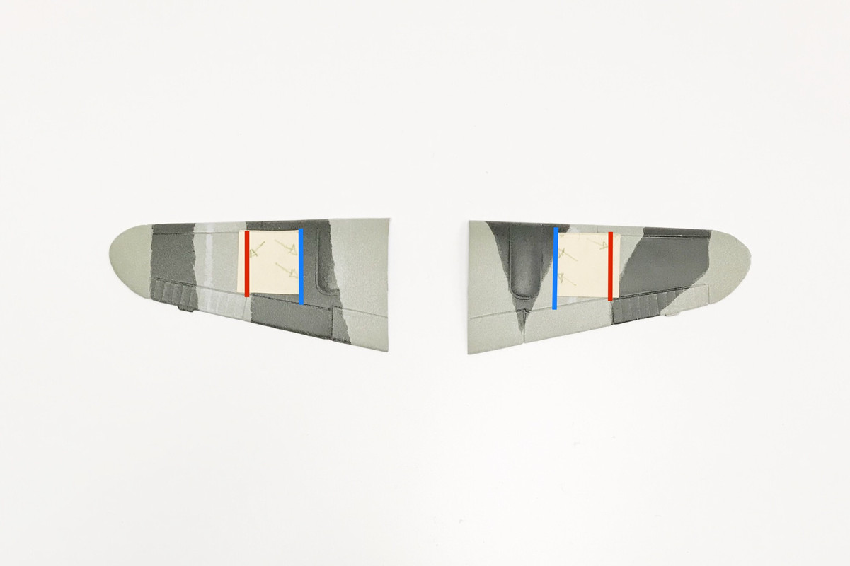

Thank you so much! This was simply an extraordinary step by step comparison of the upper wings between the kit and actual plans. Here is what I independently produced based on my 13 x 13 mm Insignia-sized Post-It’s with some additional graphics as an overlay. The lines should stop and start the way your illustration samples do. I think in the end these are fairly close. Obviously I missed the panel line (marked 1 in your diagram) completely, my mistake. I didn’t even think about it. You’re right—should not be there. You are also right to use the plans. I used one photo you gave me which shows the Insignia is aligned from the innermost panel on the original aircraft. Finding that panel line I guess I worked backwards by setting the insignia square down slightly covering the panel lines marked in red, then I had the blue location. I also removed the red paint, but I need to still polish out the engraved panel lines before I touch up the gray. Again, I cannot thank you enough. Here’s my attempt at figuring this out:
Corrected marking lines:
What is super cool is seeing how we arrive at our conclusions!!! Again thank you so much!!!

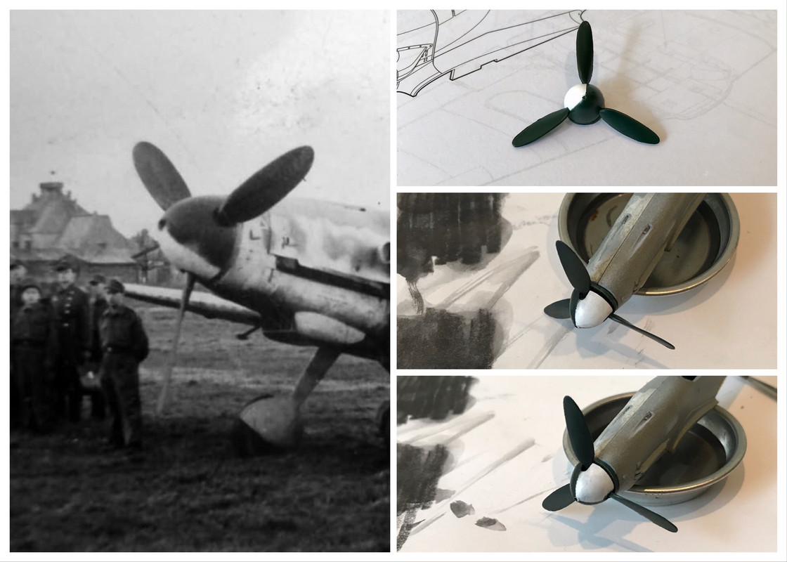

What a bear, for whatever reason. I chose IJN Nakajima M3 Green and mixed it a little too thin, which led to bleed through underneath the masks and on the Off-White underneath. Three times I went ‘round the Horn doing this and now I am here:
I didn’t enjoy doing painting these parts so some joy points went away. I need to do something else for the evening then return to my list with a clear approach.
