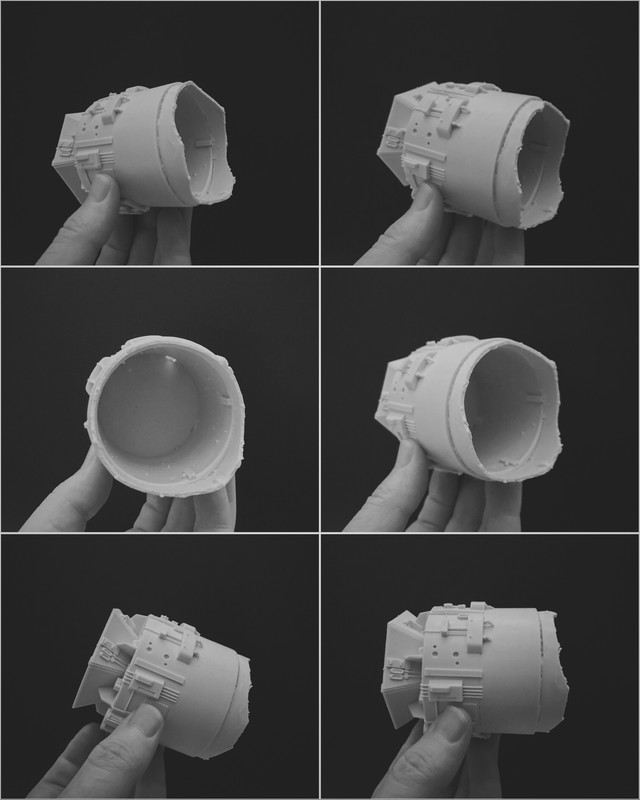

Thanks so much, Carlos! I sincerely appreciate your words. I’m grateful. I don’t know what the tan spots are on the bottom of the engine molding, but I would hazard a guess these are from greased silicone moldings. What happened is conjecture, however my guess is that blobs of “mold release” with a distinct Hawaiian Tropic scent blobbed onto the bottom of the mold—embedded the cast part and were fixed in place by the resin. There are holes where the blobs are thickest so methinks this is the most likely scenario as the resin pours of the three other engines do not have this issue. The reason I wanted to see the baffle/thruster pieces on the engine besides being darned cool was to see if these areas were in load bearing areas, or on delicate moldings such as fuel tanks. Unfortunately there are blobs on one of these tanks. I think I should see if I am able to remove the mold release then fill with putty, but I am not sure.

Where there is a will, there is a way. Clean off the Hawaiian Tropic mold release agent... (funny how that scent brings back memories of carefree times, waves, friends, and certain young ladies...
Clean up and correct any molding imperfections, then move forward. Break it all down into bite size steps.... How do you eat an elephant? One bite at a time...

Carlos—haha I was sitting through old X-Wing build threads and those marks are air bubbles surrounded by mold release agent which I will need to address by using a good filler. I am thinking I will give Milliput a try out. Any suggestions? A lot of resin folks use Bondo.

1/48 AJA ARIES 1B ENGINE
So. The molding process left this rather large stub. Any thoughts on the best way to remove it? I sent an email to Zona Saws asking for information about their razor and coping saws.

I’d start with one of the sanding drums on the right to get rid of most of the stub, and then use a good old hand held sanding stick for the final work to make sure you don’t ding up the resin part.

Great points, Carlos! And also howdy Duke, I read what you wrote earlier about hitting up the sale, I was not able to due to trying to figure out what tools I need for this.
Carlos, yes, thanks for the important point about going too far. I was thinking about using the saw vertically to create sections to cut; smaller and more manageable pieces.
