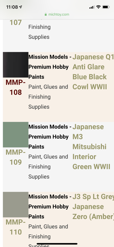

Alright lads, looks like we’re going with my Kustom mix of “BOOYAH! GREEN” after all! Which I’m cool with. I like that color a lot.
Mr. Black Sheep,
Now that’s interesting-
That reminds me of a thread I read where a guy said the color was similar to our cockpit green but slightly more gray. That certainly fits the bill.
Interesting contrast, that.
What I’m planning on doing is, using my “BOOYAH! GREEN” but doing it like this:
1. Spray heavily thinned over black
2. Spray a darkened shade (which’ll look more like the #18 sample) in the lowlight areas
3. Spray the color as-is in the more highlight areas
4. Spray a slightly lightened shade in the areas that need highlighting
This one I’m doing is more than likely a Nakajima aircraft. But I don’t want the cockpit color to be super-bright like I see in a lot of photos, or super gray either, in the even that I’m wrong.
What I’m shooting for is something somewhere in the middle.
And the BOOYAH! GREEN seems like a good ticket.

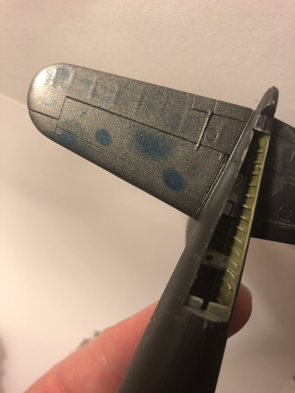

I tested out that liquid mask tonight, thinking I could use it instead of hairspray for my chipping needs.
No mi gusta.
I don’t like that stuff at all.

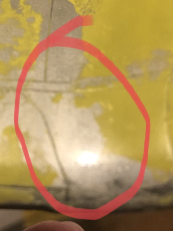

Also, I don’t like Tamiya’s Flat Aluminum sprayed over a black base either. It looks too dark. And that mask definitely isn’t going anywhere unless I wet it and that’s no good for my acrylics. I was hoping it’d go on more gummy so I could carefully remove it with an Exacto blade. Really glad I tested that out:
Metal is too dark, it will turn black under chipping, and that masking fluid seems uncooperative.
Nosir, I don’t like it.
So in terms of my plan for painting this aircraft, I want to do something different and I’m trying to decide what that should be.

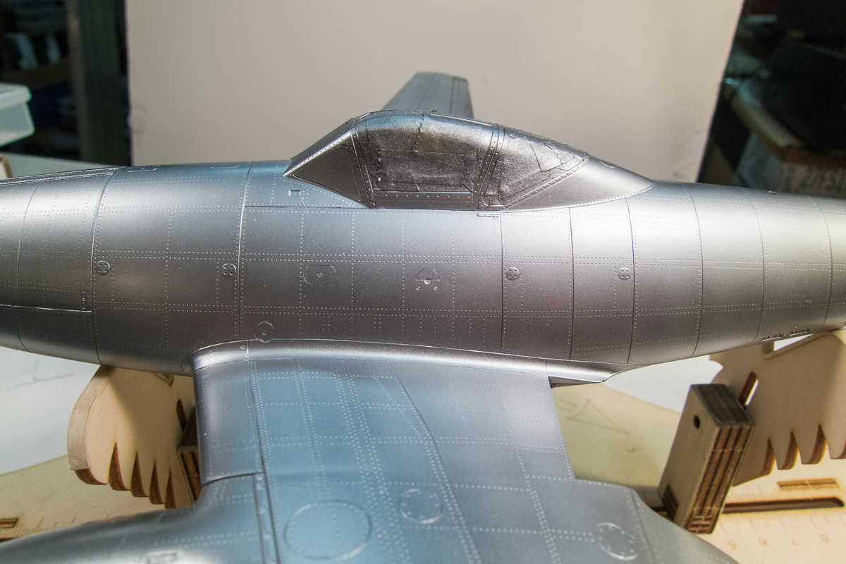

I like this bare metal for an airframe color better. It still shines through nicely when you chip the paint on top:
This is much nicer.

Nice analysis... always good to catch it on the mule instead of the model. I would recommend trying Tamiya AS-12 Silver in a spray can for your base metal. I just spray some into my airbrush cup. You can shoot it straight or you can thin it with Tamiya Lacquer Thinner or Mr Leveling Thinner. It's less grainy than Tamiya bottle silver or aluminum and a bit tougher than Alclad.
John,
I can certainly do that! I like the looks of that base coat in the photo you shared and that, my man, is exactly what I’m shooting for! And no need to prime before you shoot the AS-12 at it, right? Also, if it can be thinned withbMr. Leveling thinner, so much the better!
Bruce,
I knew you’d know what I mean, brother. I thought maybe it was the result of spraying it over black but I’m not 100% sure. And the Titanium Silver and AS-12 Silver looks so much nicer. To me, it does a great impression of nice, smooth aircraft aluminum.
