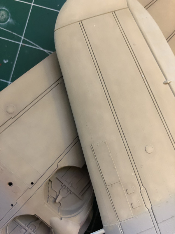

I like your search for that elusive Zero color. And I like your use of different colored base coats. But keep in mind that the color chips that you are matching too have already integrated whatever underlying base color that was used. So mixing to that color and then using a non-neutral base underneath will shift it away from the chip. Which is not necessarily a bad thing. But now I see a definite red hue to the color you've sprayed. What does the color look like sprayed directly over grey plastic? Any difference?
...that said, I wonder if the color would turn more olive sprayed over bare metal silver...?
I don't see a huge shift in color tone but the reddish accents near the panel lines are still noticeable. Again, not a bad thing. It could work very well with the future weathering effects that you use later on. I just wanted to point out what I was seeing in your photos.
You are correct. Pre-shading could knock that out. Or washes. The purpose of that experiment was more to try and mix the color more than anything else really.
I don’t think this color and technique is going to be a GO! though. It isn’t light enough and it doesn’t have that quality of looking yellow under certain light, and amber in different light.

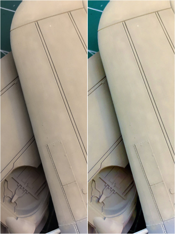

Interesting. Dollars to doughnuts I bet the white balance is interpreting reds a tad strongly on your phone’s camera capture software. Also the image is a tad dark.
Left-Original / Right-RGB Balanced

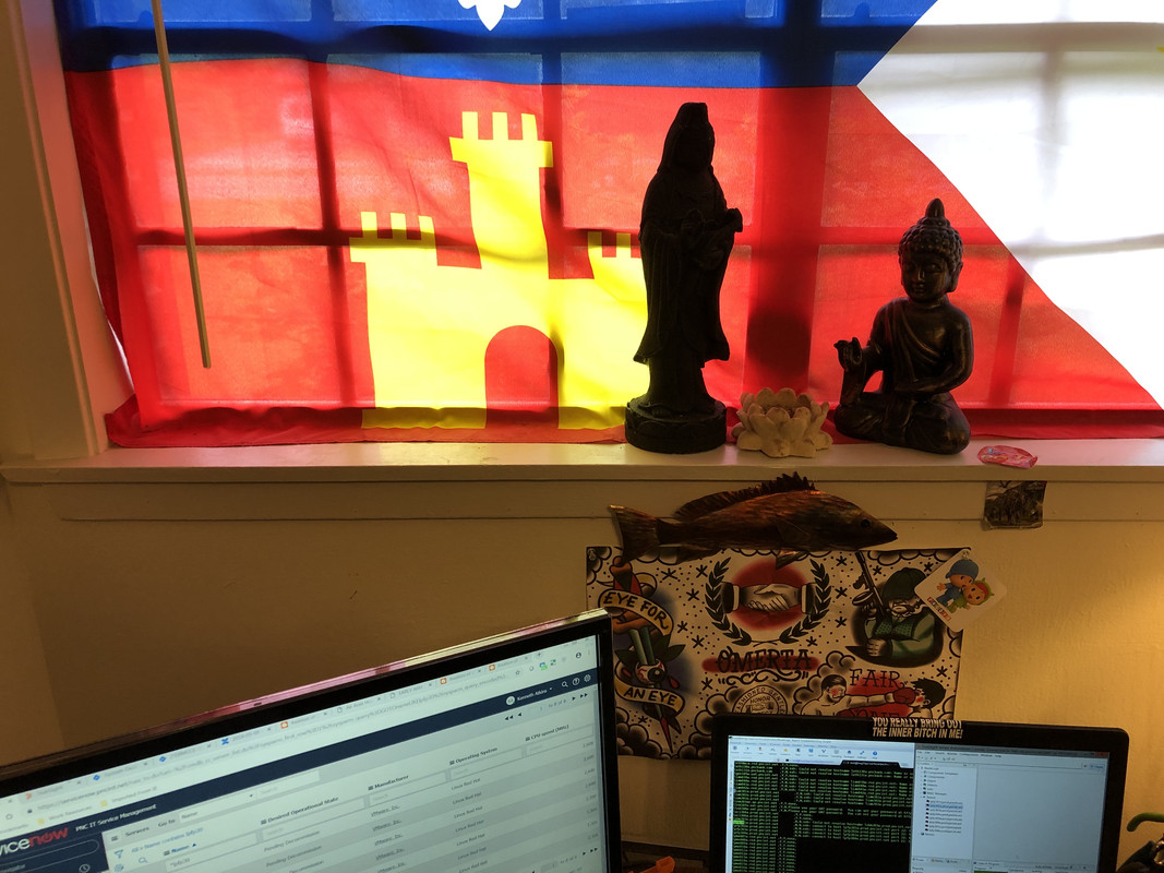

You know way better than I do about such technological voodoo, Bruce. Further- many things in my office appear red due to the fact that I have a big-ass Acadian flag hung up in the window above my desk-
Either way, this color isn’t 100% to my liking today. It goes that way with me, you know how mercurial I am.

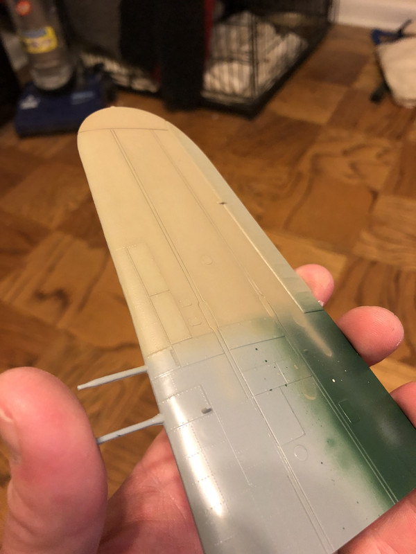

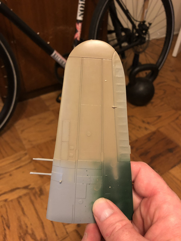

After not being 100% happy with my paint mixture, I ended up experimenting and beating my head against the wall with it for a while before finally emailing Mr. Nick Millman over at Aviation Of Japan Dot Com. He’s one of the foremost proponents of I guess what people might refer to as the “Brown Zero” school of thought.
And he answered me!
He told me the color I’d mixed, using the Greg Springer formula was a very good and close match to the extant chips.
I mixed up more, this time lightening it with a bit more white and Gray Green, and performed another test. Mr. Millman advises that in order to allow for the paint to keep its “color shifting” property when lightened, I’d need to lighten it with light green along with the white, and that made sense. He further explained that Tamiya’s Gray Green is a great color for depicting the paint in a weathered state.
I came up with this. Note how it’s nice and caramel colored and then the yellow comes out when the light hits it at a different angle. That’s what I was trying to achieve. I had read an account of a Corsair pilot who happened upon some Zeros, and he marveled at how the Zero appeared “gold” at first. That’s what got me. Here’s the latest which I’m very happy with:
I hit the leading wing edge as well as a few raised details with heavily-thinned Gray Green as an experiment in localized weathering. I’m doing a well-maintained Zeke, but I’d like to have a little weathering. Instead of chipping at the wing roots and other high-traffic areas, I’ll be using this Gray Green blended in there instead. I like how they look together.

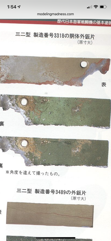

And here are the color references I used this-go-round, note the top chip:
