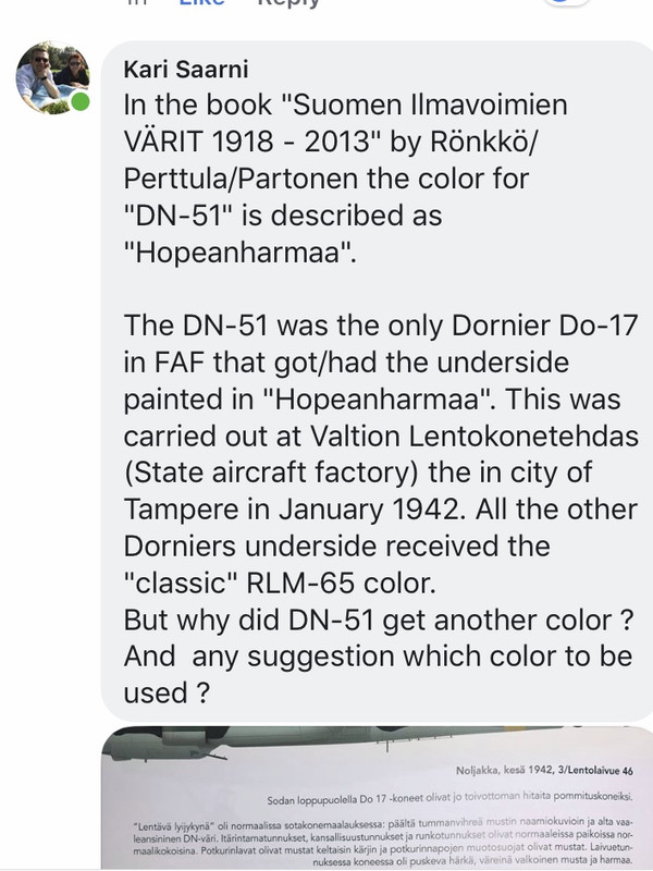

Stikpusher wrote:I found my tin of Humbrol 166. It is quite a bit lighter than what is shown on the Humbrol website and just the slightest tinge of green, similar to what is shown on the color chips that Bruce posted. With :quotes: scale effect :quotes: it would likely work well as is straight from the tin. :hmm:
Many thanks Carlos, that sounds indeed promising !!
Posts: 11468
Thanks, Carlos. Confirming the color!
Kari, I believe your FB reply is by far the best!

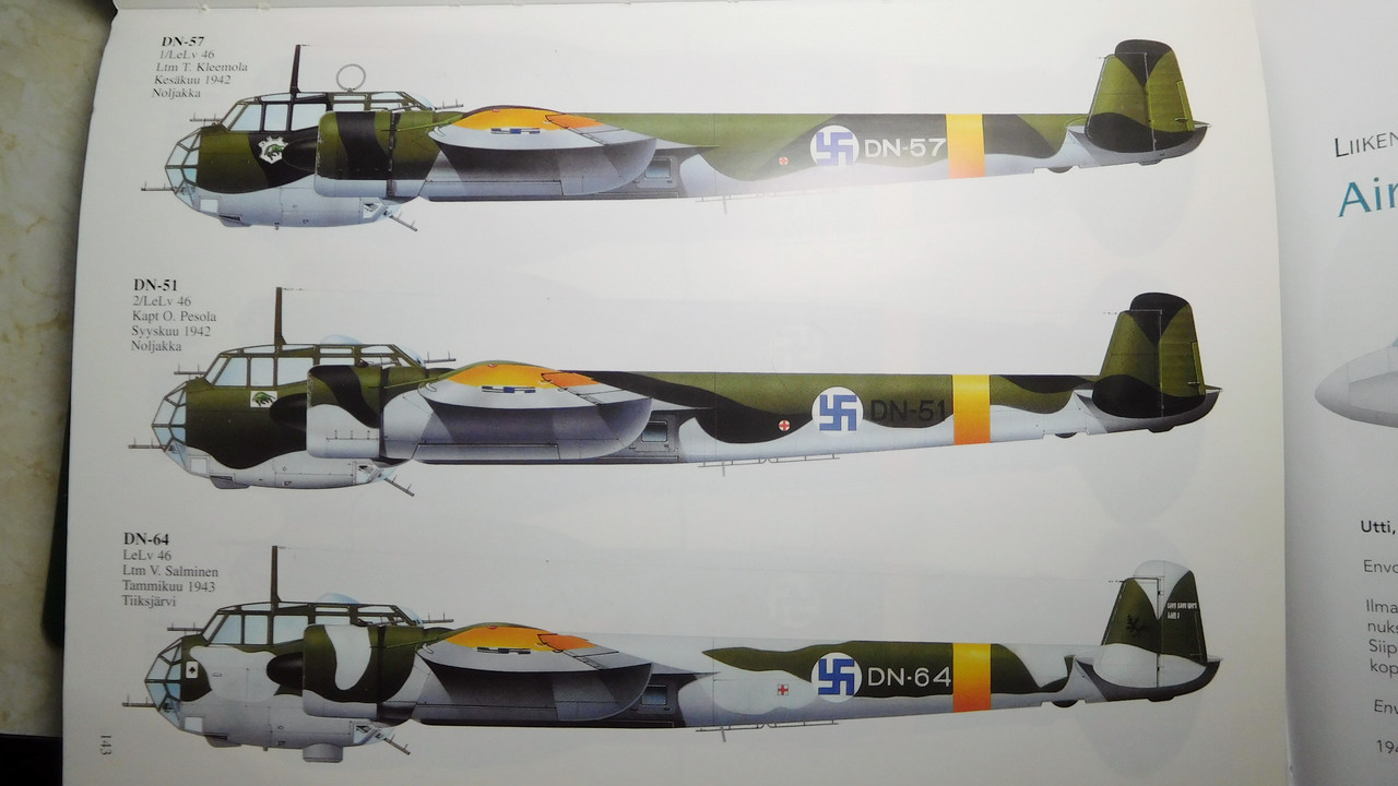

Also is this the profile above the description and if so would you please take a photo for me and post it here?
Posts: 5647
Unfortunately the plane above is the DN-59, but I had another book where I found the DN-51. But the drawings are not so good in my opinion, as I cannot see any difference in the underside colors between the 3 examples..
(DN-64 in winter camo)

Kari, Thank you for the profiles. I updated the first post of this thread, adding these images of FAF "Bison" Dornier Do 17s. My sincere thanks for everything you do!

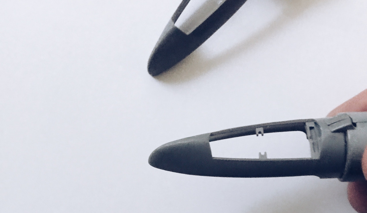

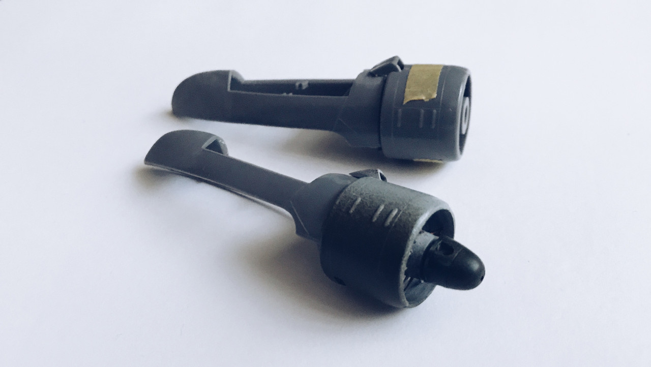

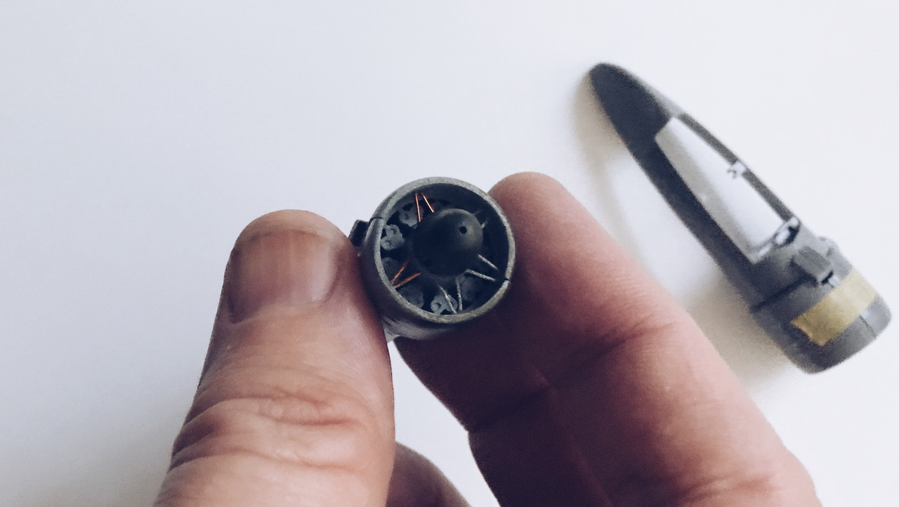

Things that I did above that I should note :
1. Added the two lower braces, which brings the shape to a star overall. I do have a factory diagram of the braces finally which I will add to the thread soon.
2. Removed the left and right raised injection molding pins from the front interior sections of the cowling. There are actually four raised injection molding pins inside the cowlings. I removed the first pair that are visible. To do this, I used my Dad's set of needle files. There must be names for each type, but I do not know the names for the file types. I choose two—one looks like a small "spade" and the other is a round file which is well... very much a needle. Working carefully to avoid gouging the plastic I removed the pins then followed sanding with 600 grit Tamiya sand paper.
3. I built the nacelle sections! I glued kit plastic together for the first time. So, I wanted to do something underneath in case I mucked this up. I also wanted to build out from the engine I am already modifying. Just as a huuuge FYI, the kit plastic and Mr Cement Deluxe were not a match made in heaven... more or less I scrapped the idea of using liquid cement designed for plastic kits. This has already happened on the AMT/ERTL Enterprise anyway, so once the thick Tupperware type of plastic started to resist Mr Cement Deluxe's chemical concoction, I moved straight to CA. I really like the Sprue Brothers branded CA even though it is really thin. I did what I did on the Enterprise nacelles, used a pipette to run a bead on the outside then sanded the bead while the glue was wet. This takes a little or a lot of practice but following the seam edge and grinding the plastic into the glue locked the two halves of each nacelle into place. Then I continued to sand the joins, filling them with sprue dust—the magic pixie dust of all modeling!
I definitely feel that there will be no "popping apart" of these seams which remains my primary concern. I am wondering if anyone has ideas for the attaching wings — the top and bottom seams and the wing-to-fuselage joins may require a similar approach but I would like to try out different ideas. With nacelles, I have an approach that works, but I could use ideas for the wings. Thanks in advance.
