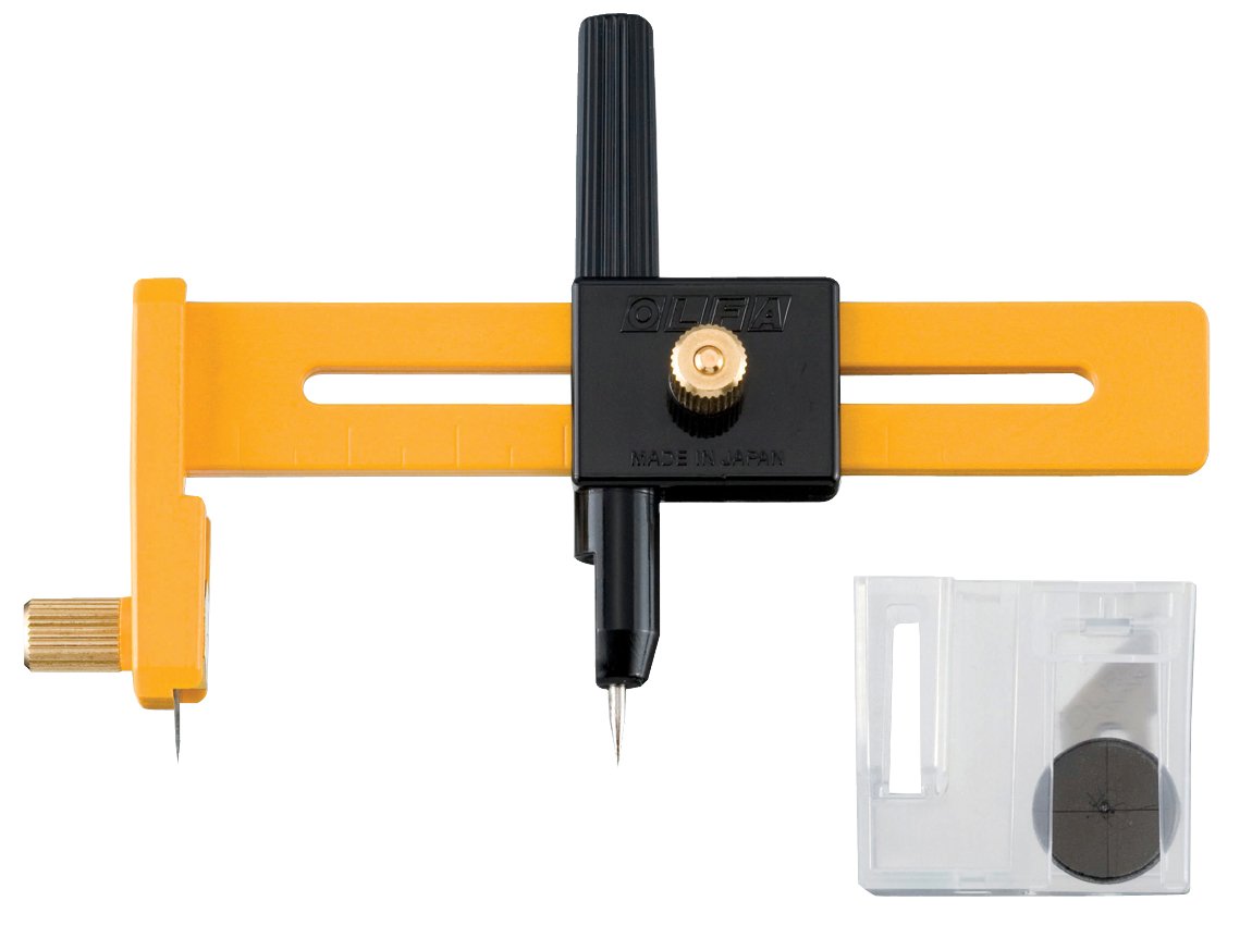

I’m weathering this bird pretty extensively. About like what I did with my last Corsair. And this aircraft has a fascinating paint scheme. Gray green on the bottom, that groovy dark green top-side, with yellow stripes around the fuselage, orange stripes on the leading edge of the wings, and the national insignias. The kit provides decals for the stripes and insignias, butbheres the issue:
1. They’re thick.
2. They’ll look pristine on a heavily-weathered bird.
So okay, Solvaset would probably handle the thickness issue.
I can dirty them with oils after application so that would help the “looking pristine” issue.
But while that method will make the finished product look good, it won’t push it over the cliff. Know what I mean?
So I’m opting to paint that stuff myself, so that I can chip and scuff those insignias and stripes so that the weathering is consistent. Chipped yellow band down to bare metal AND scuffed down to green as well. So I’ve been mentating on how to work that out, and I think I’ve got it licked, at least in my head. We’ll see.
Multi level chipping! That's gonna look sweet!
I know you can pull it off!
Since the Japanese markings are so simple, you don't need a Silhouette Portrait to cut masks for it. You can use one of these...
https://www.amazon.com/OLFA-9911-Compas ... 8318&psc=1
$8, same day delivery if you have Amazon Prime.
