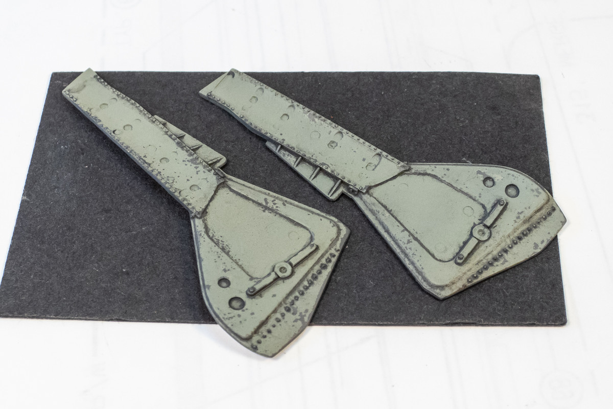

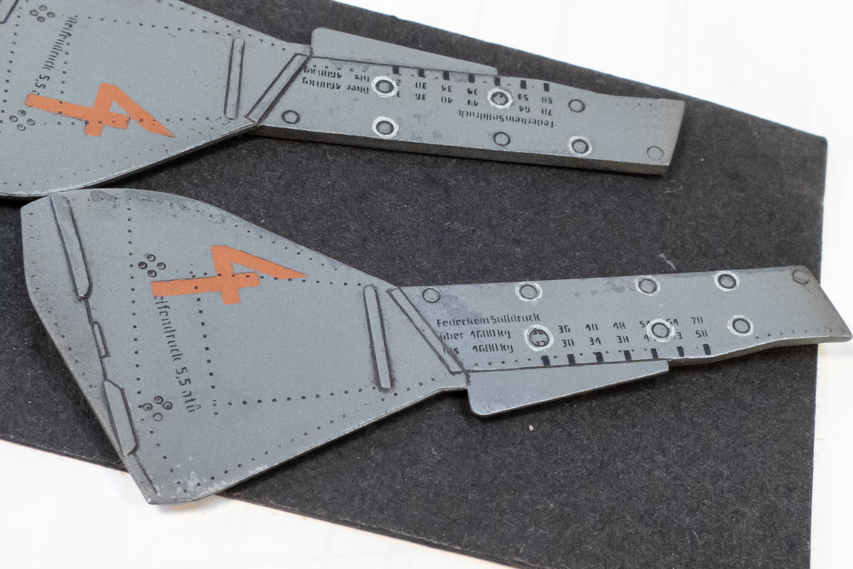

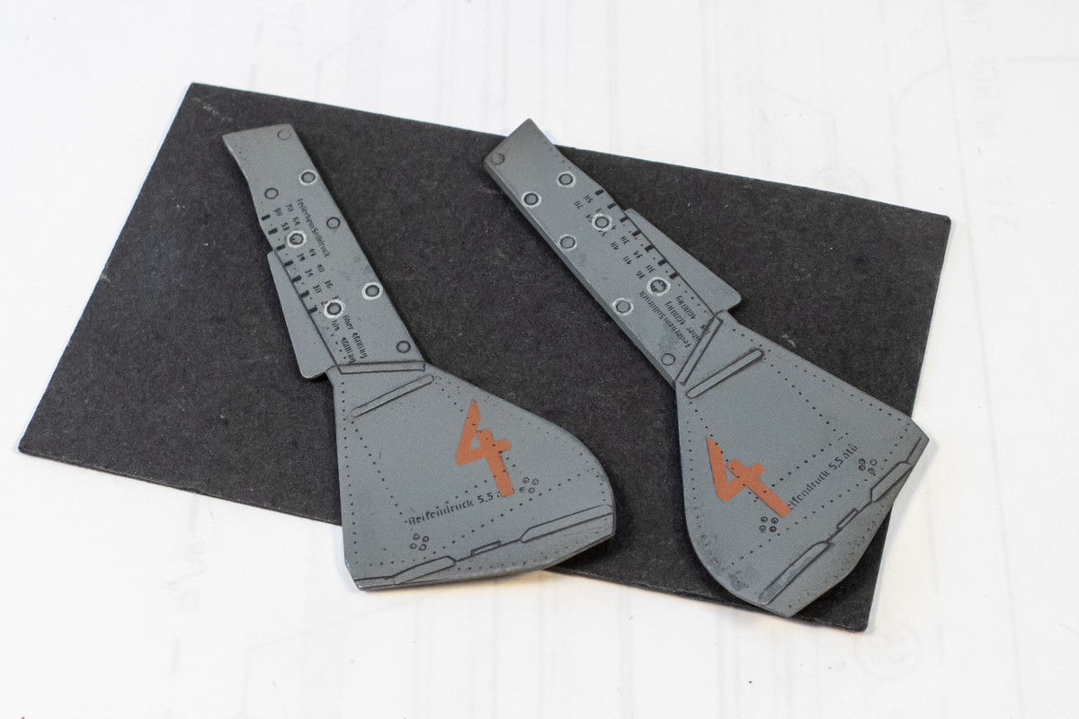

I re-did the landing gear covers after I realized that I had wrongly assumed that the bottom color was RLM 74 Dark Grey. My references say RLM 75 Violet Grey. The stencils were sprayed using the 1ManArmy masks, highlighting that these can be re-used multiple times.

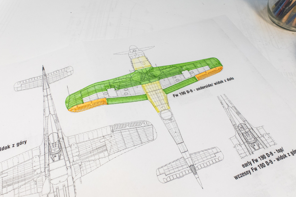

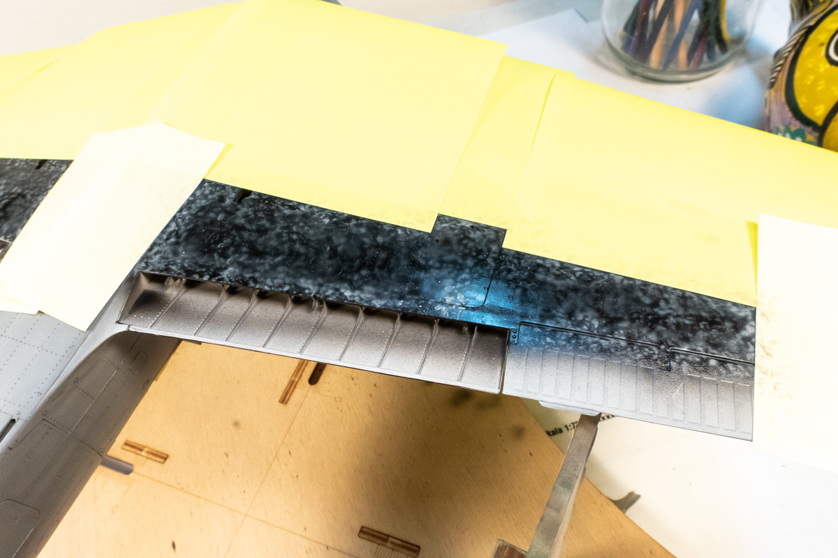

I decided to give my self a kick in the pants and get the painting underway since the gloss black base for the natural metal has been sitting for a few days now. Prior to painting the black, I had mapped out the different colors on the bottom.
I've decided to try a different metal paint for this one. This Mr. Metal Color No.218 Aluminum. From the few Youtube clips I've seen, this paint seems to spray well and can be buffed after application if you want a shinier finish. It also seemed to have no adverse reaction to a clear coat on my paint mule.
I also wanted to try a matte pre-shade to see if I could create some texture in the metal finish. I used flat tan color to create a random mottle over the gloss black.
This is the metal color after spraying. You can see some of the texture that the flat mottle created when the surface is viewed at an angle. Otherwise, it is not very noticeable.
After drying, I buffed the metal surface lightly with a clean cotton t-shirt. This removed the slight graininess. Alclad Duraluminum and AK Extreme Metal White Aluminum were used to create contrast in the panels and ports.

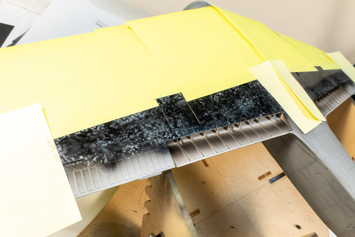

The metal sections were masked off using Tamiya yellow tape.
The leading edge of the wing bottom was given a mottle treatment prior to spraying the RLM 75 Grey Violet (Mr Hobby Aqueous).
The Alclad colors, which had been sprayed directly on the Mr Metal, lifted with the tape so I ended up removing most of it.

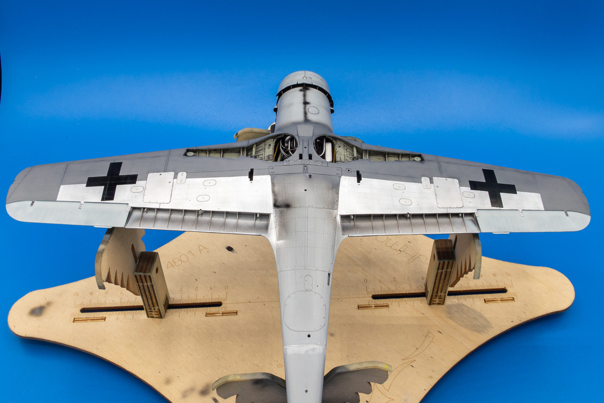

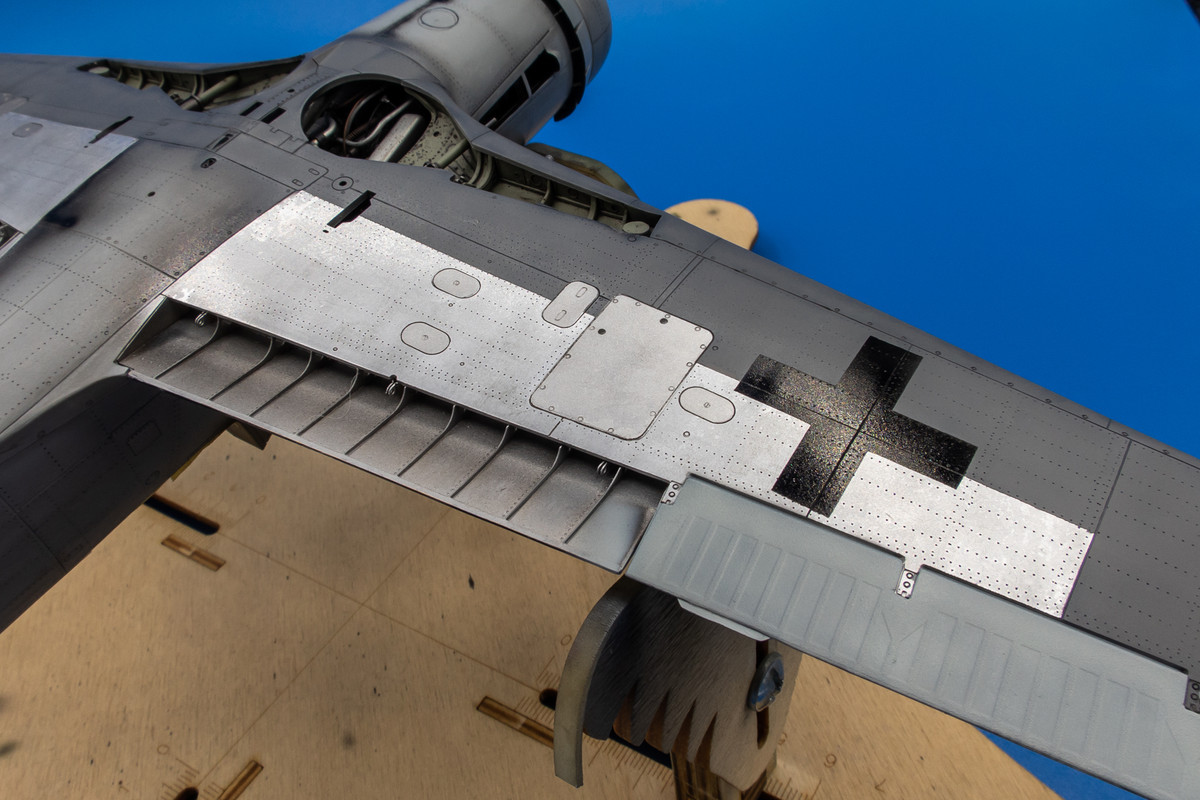

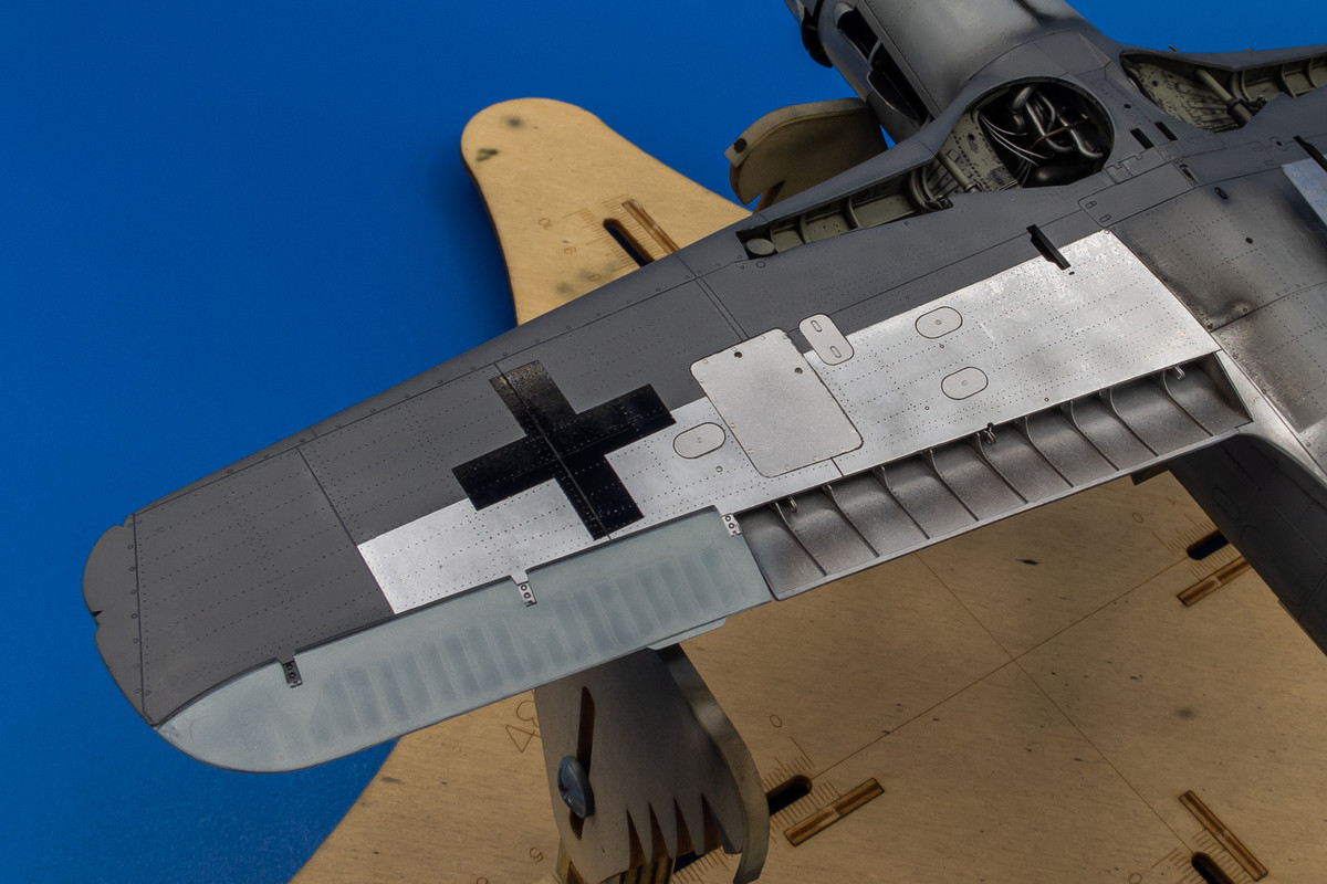

The panels and ports were re-sprayed (just Alclad Duraluminum this time) and the ailerons were painted RLM 76 Light Blue (Mr Hobby Aqueous). Here's what the wing bottom looks like after painting but before any weathering.
Dialing down the exposure, you can just make out some of the texture on the NMF.
