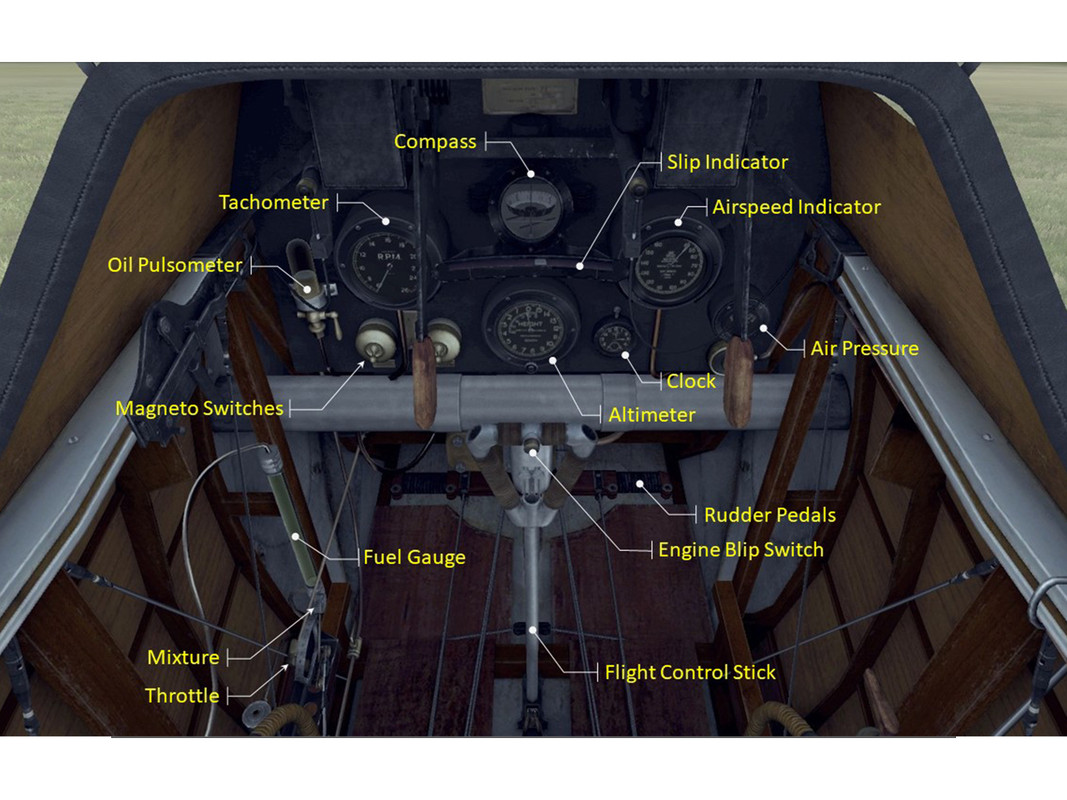

Those engines didn't self commence, Bruce. The starter was a guy pulling the prop through. There would be an ignition switch somewhere, and a blip switch I think on the throttle which cut the ignition to reduce RPM's.

What I pulled off the internet—
To start the Sopwith Camel's 130 hp Clerget 9B rotary engine, typically the pilot or ground crew would first turn the prop by hand to prime the engine. Then the following steps are performed -
Mixture set to full rich.
Throttle set to about 1/2 open.
Magnetos switched on.
Prop rapidly pulled to start.
The last two steps are bound to a single "Engine Start-Stop" key so these happen in rapid succession when the key is pressed. If everything is set correctly, the engine should start right up.
The “Engine Start-Stop” key definitely confused me! Thank you for explaining.
I sincerely appreciate your knowledge.

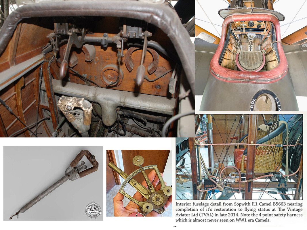

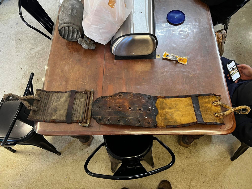

These are some of the cockpit features I will be addressing. Whenever possible I’m referencing actual objects.
- Posts: 11465
- Posts: 13521
speedgraflex wrote: ↑Sat Jan 25, 2025 3:23 pm
Wow...great reference photos!
