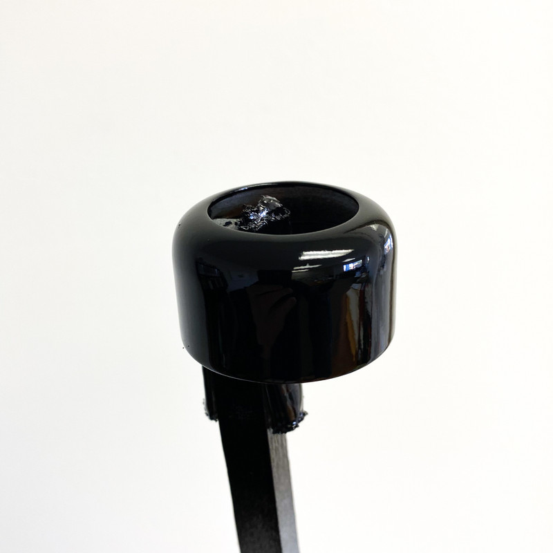

Thank you, Lyle! Here:
John, I am using Mr Surfacer White 1000 as a primer. Heavily. To the point where I was watching for edge flare. Then I polished the surface. Sanded with 2K Tamiya abrasive. Then I primed again.
This is first coat of black. I think it is all I need. UV gloss clear after it cures. Actually just checked and Robot 4 Less sent me UV Coat Flat. Argh. Either I screwed up or they did. But I know there is a high gloss UV Coat and I want to finish this with it if possible. Or floor polish. Or floor wax. I’m not sure yet. But I want to buff this surface to a high gloss. Maybe I will use everything above. The kitchen sink approach. Ideas would be most welcome!

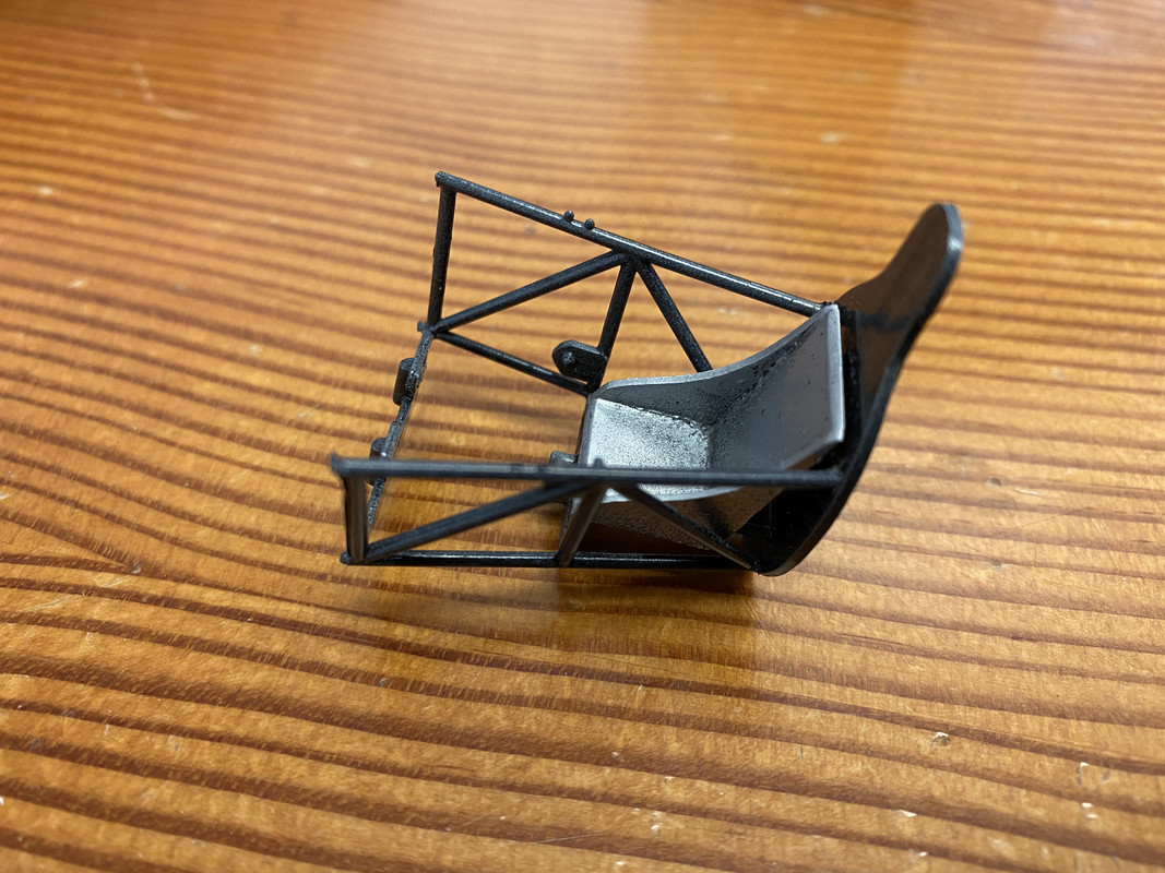

I sprayed the control stick in navy blue to see the flash and imperfections better. Time to slice and grind albeit gently with appropriate finesse.
Preparing for the IP next... or “At the next,” as Sylvio would write as a sign off. Cheers.
