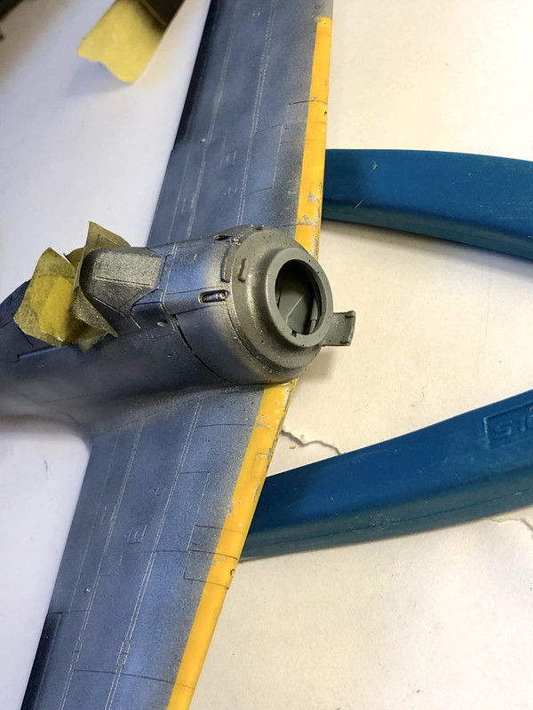

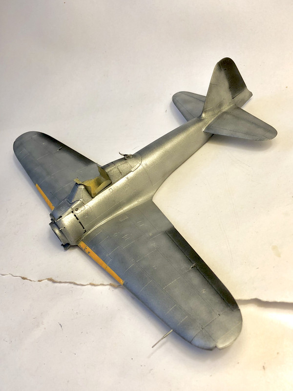

I’m stoked. I got the leading wing edges painted and chipped early this morning. Here’s a photo set of the progression:
After the Mr. Hobby Super Clear has 24 hours to cure:

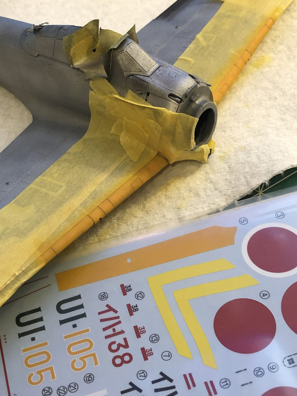

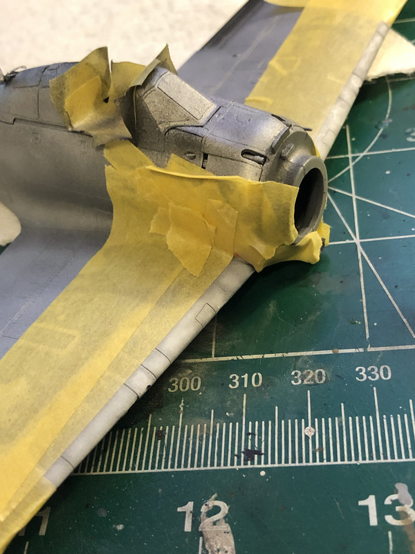

Here the aircraft has been masked, and Aqua Net hairspray has been applied via airbrush to the targeted areas, and painting has begun. Here was a light, misting coat of Flat White, followed by another coat or two marbled, just shy of the panel lines:
Next came the orange. I mixed equal parts Red and Yellow, and then added white. That initial attempt was far too red-leaning. So I took two drops of that and mixed it with four drops of Yellow. It immediately became too Yellow, but I sprayed it anyway. After a light coat of that, I mixed one drop of red, three drops of yellow, and one drop of white. BOOM. Here’s the final product with the decal for comparison:
Chipping came next, followed by a buffing with a microfiber pad. Here are the results:

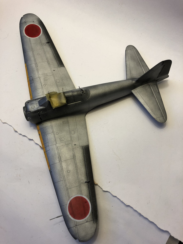

Okay, so back to it, lunch break Hinomaru! Two down, four to go. Let’s take it from the top!

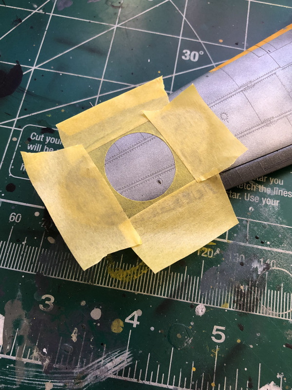

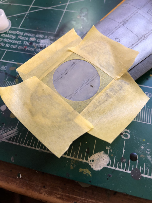

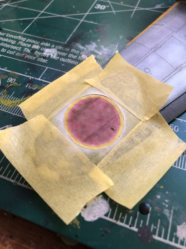

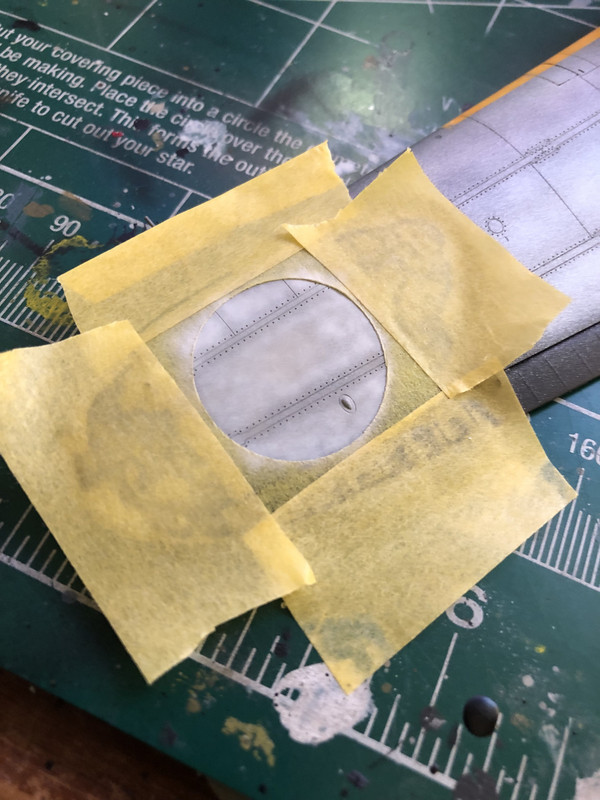

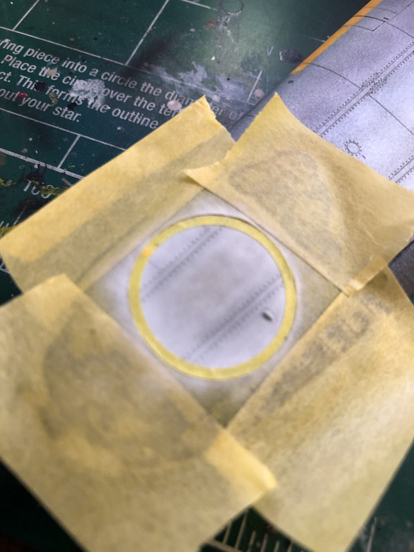

I cut the mask out of wide Tamiya tape using the circular cutter John recommended earlier in the thread. It got the job done easily. First I cut out a square of the Tamiya tape. Then cut out the large circle which encompasses both the white and the red, and from that large circle I cut the mask for the white.
Next I thinned some Deck Tan down, 3:1 thinner to paint and marbled it on the inside of the insignia. I kept the pressure at 10PSI and was very light on the trigger.
Next I thinned White down 3:1 thinner to paint, and began applying it in the same careful, easy-going, marbled manner, building it up very slowly.

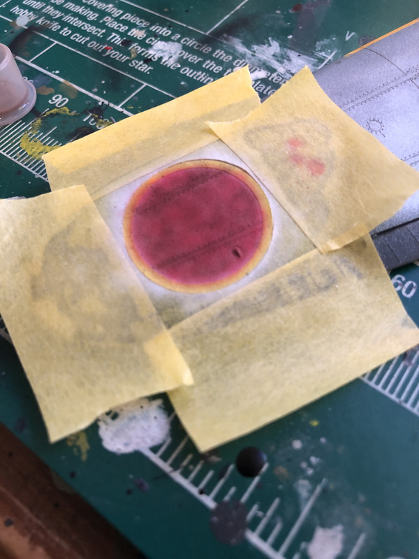

After that, I applied the mask I’d cut and set aside for the white very carefully, and began laying down the red. I began with Hull Red, thinned 3:1 thinner to paint
And next came Red, thinned 3:1 thinner to paint, same protocol, thin, marbled coats.

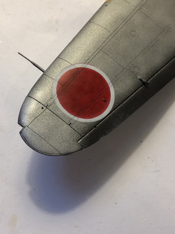

And the results!
This is the first time I cut masks and painted insignia. I’m very stoked about how these came out. And I don’t foresee the use of decals for insignias like roundels or crosses anymore if I can help it. I really like how they look painted on.
These will be left to dry and cure over the weekend while I work on the other four. Then they’ll cure for a few days. After that comes the Green and Gray green.
