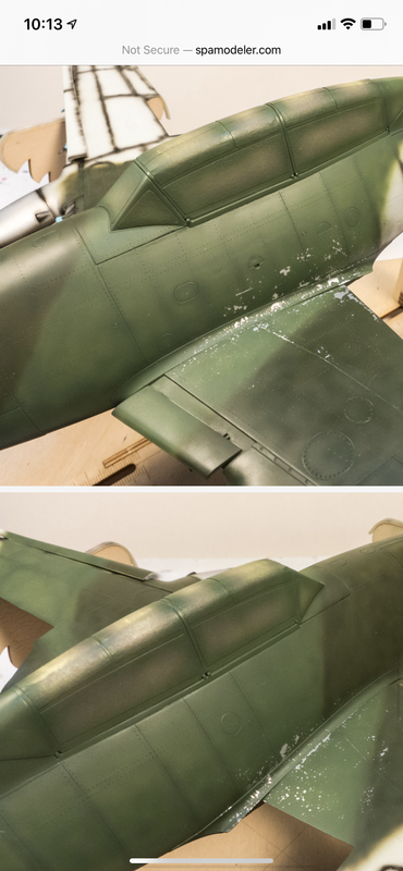

Looks excellent! Can't wait to see the upcoming mottle
One of the things which I enjoy most about observing your work is how it re-enforces the idea that there is more than one way to accomplish most goals effectively. This helps remove a nasty tendency which can arise toward blind marriage and absolute loyalty to one specific idea. Case in point, the manner in which you paint. I get the sense that like me, you enjoy a depth and modulation in your paint work. But while I Black Base, you do the opposite, with a lighter base and pre-shading. Then we meet in the middle. And I very much enjoy seeing how you’ve brought a nice finish to life using this method of yours. Great tonal variation in the darker shades of the paint, and the lighter shades pop in a very nice, very pleasing, “scale” way. All while achieving and maintaining harmony. I like that very much.
Also, the edges on your splinter camo are diffused in a lovely way. I can’t seem to pull that off myself. Never could get that effect laid-down in such a way as I didn’t hate my final result.

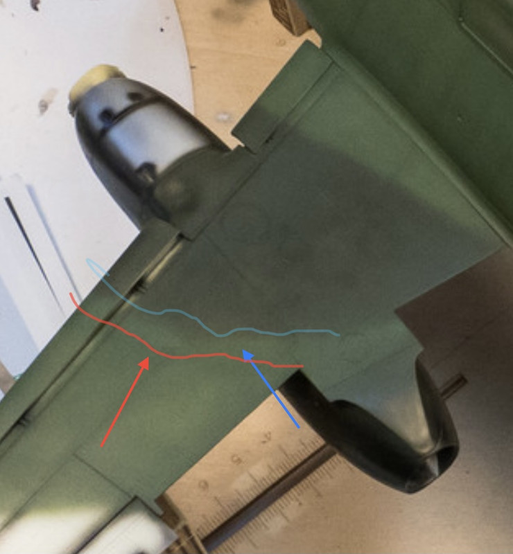

I think the key to soft edge camo is extension of the fade itself. Here with this top down view there appears to be the initial camo demarcation line at the red squiggle I added and the fade extends outward to the blue line before stopping.
I think both dark and light colors then blend with a bit of the color beneath them... or maybe it is simply pixie dust? So, John, how is this done?
Thanks guys! To be honest, I wasn't paying too much attention to the upper camo scheme. Due to the upcoming lighter mottle, the RLM 81/82 combo will pretty much be obliterated and you will not be able to distinguish the 81 from the 82, much less make out any of the transitions between the two. So I was just trying to separate the two colors as neatly as possible without dwelling too much on the results besides uniform coverage. That's why some demarcations are softer than others. If this was the final scheme, I would've paid much more attention to the consistency of the demarcations.
