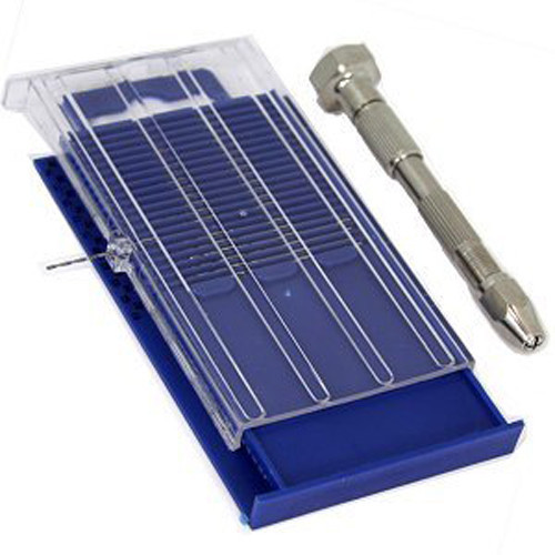

Hey Kenny... I totally hear you about adding things to a part that has already been finished. Sometimes you just have to decide to move on although Bruce has given some good options in case you want to try again. Ultimately, the decision is yours and I personally think the model will be just fine without the wiring.
If you DO want to make another attempt, I'd pick up a set of micro drill bits and a pin vise to hold them. Very cheap stuff... should be less than $10.
You were on the right track in terms of attaching the wiring at the harness first. Accepting holes in the wiring harness and in the cylinder heads will give you better attachment points.

And as to John advice, yep. I have a very small hobby drill but I need one of those jobs you posted. Definitely going to get one in the very near future.
