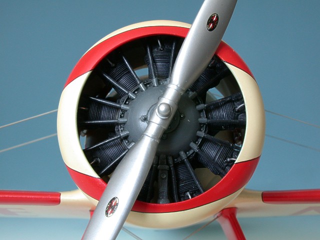

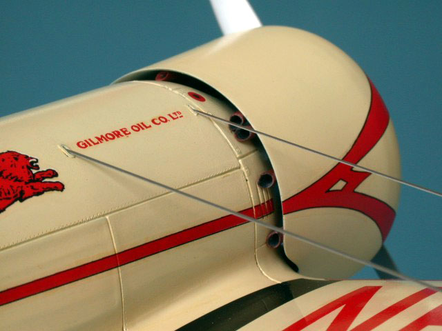

Exhaust stacks
I believe I need to hollow them out or use brass tubing to correctly depict the exhaust openings. I didn’t consider this at first but I recently found photos of a 1/32 Weddell Williams Red Lion (Williams Brothers as well) which depicts this quite clearly.

Hi Bruce, just a suggestion, you can also use Q-tip pipes for exhausts if diameter fits. Or straws. Just an idea.
If I was living in America, I would 3D-print them for you...
I have a resin 3D printer if you have the file I would happily make and send them to Bruce.
Bolleken
Posts: 696
Post by Bolleken »
Well, I don't have any 3d model until now. But I can provide that if Bruce can provide some diameters and probably some more information regarding shapes and geometry. Keep me informed guys.

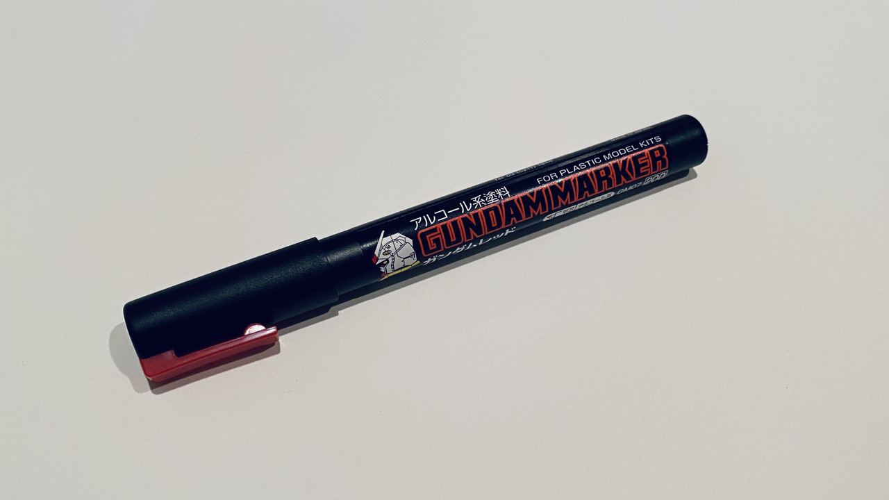

Thanks, gents. I sincerely appreciate both of your offers and the enormous creativity behind your own work. I spent the day trying to work out how to get my girlfriend from Rome to Los Angeles and I think we have a plan. Tonight I am going to look through my stock of Albion Alloy tubing to see if I have something close, and I will update this space in a bit. Cross my heart. I also received a red Gundam Marker (paint pen with chiseled felt tip). Huzzah. Thank you, Brookhurst Hobbies.
I am going to do some wing tests to see if I can use this to pull off the red pin striping. We shall see, said the blind man.
