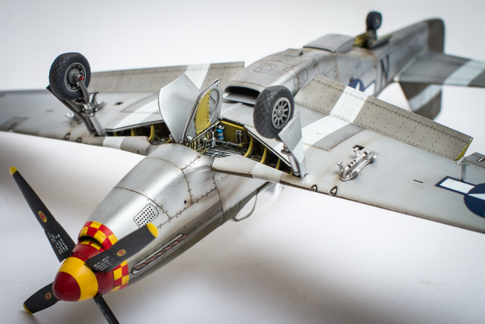

Kenny... Those are only the two that I'm personally familiar with. There are others that I haven't tried by Mr Hobby, MIG and AK to name a few. I have uses for both AS-12 and Alclad and wouldn't give up one for the other. AS-12 is nice as a chipping layer because I find that hairspray and chipping effect solution sticks better to finishes that have a hint of grain versus a totally polished finish. Decanting is easy... I just spray a tad directly into the airbrush cup. It's actually easier than going from bottle to airbrush. Yeah, a little silver paint gets on my trigger finger but it's not as messy as you might think. You can spray it straight without thinner but I like to put a little (Tamiya Lacquer Thinner or MLT) to make it last a little longer (think watering down whiskey).
Alclad is a line of lacquer-based metallics. They come in tall bottles and shoot straight without any thinner. I've never thinned any of the Alclad metallics. They are meant for airbrushing and I don't think they can be brush painted. Their high polish finishes such as Chrome, Aircraft Aluminum, Polished Aluminum, etc, produce a grainless mirror-like finish, the shine is which is dependent on how shiny your glossy black base is. They also have less shiny colors that can produce a grainy sheen similar to AS-12 (such as White Aluminum). I haven't done many metal finishes so I don't have a good example of what Alclad is capable of but I do use it on my oleo struts to make em shiny.
Alclad dries quickly and is fairly strong. If you want max shine, you want it stand alone... spraying any clear, even gloss will impact the shine. I treat it like any other color. My only NMF aircraft was done with Alclad and AS-12 on the wing bottoms to depict a doped finish but all of it was given a flat coat to kill the shine.

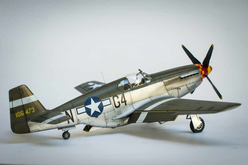

That is some beautiful silver, John. I like spraying AS-12 straight from the can, too. The straight no chaser approach I guess!

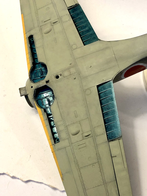

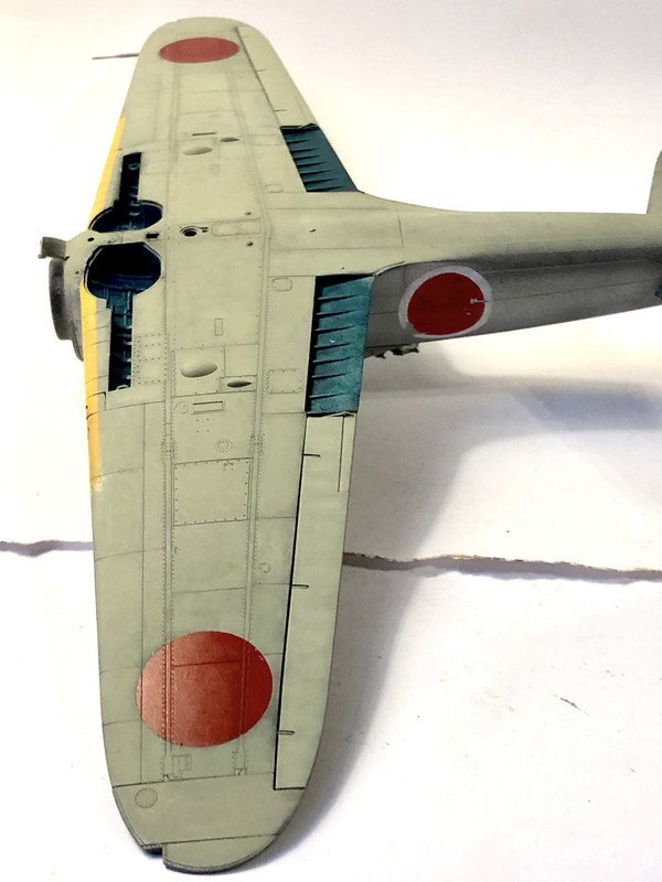

I took some time early this morning to finish the underside. Here’s some shots:
I’m pleased with this. All this work, along with the top-side Hinomaru will be getting a coat of Super Clear tomorrow. If there’s one thing I’ve learned, it’s: Protect Your Work.
I’ll probably shoot some more Super Clear topside where I plan to chip too. Just another insurance policy. I’m hoping to start the dark green on Thursday, so we’ll see.

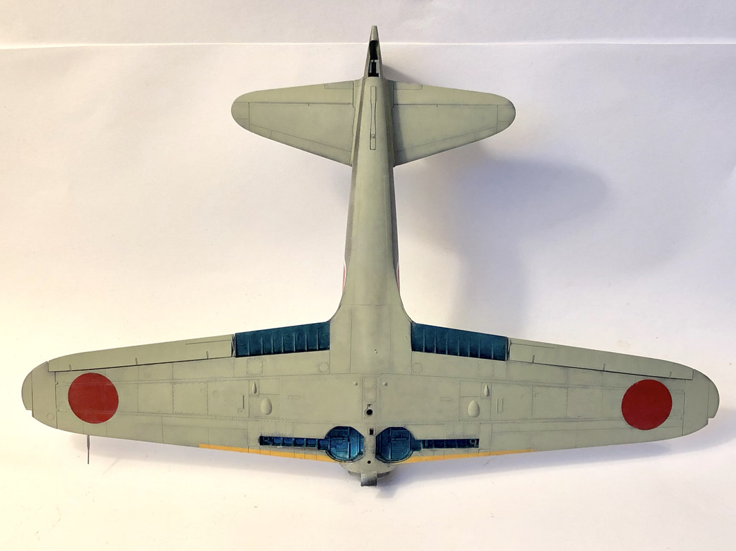

This looks great! Panel line and shading/wash are done with "taste", as it were. It looks like you would expect this to look. Well done, sir. Well done.
