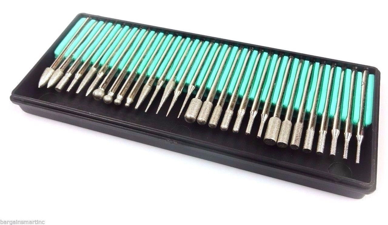

As I reviewed the many Tamiya Corsair builds out there, one thing caught my attention. The exhaust stubs. To their credit, Tamiya has dimpled the ends to make them appear hollow but they are on the thickish side. I thought about replacing them with angled cut brass tubing or maybe a plastic drinking straw.
I decided to enlarge the openings manually, thereby thinning the walls of the exhaust tubes and also making the openings deeper. Kinda tricky since they are cut at an angle. I used a Dremel (carefully) with a diamond grit bit. I think they look much better.

Nice work on the exhaust, I'm way to scared to take a dremel to a kit instead I stick to doing things by hand.
I had the same thought and first tried to attack the exhausts with a knife and drill bit on a pin vise. But the oblong cut made things awkward. It's not just a hole you are trying to deepen... it's a trough and my hand work was leaving marks.
I have a set of cheapo diamond grit bits for the Dremel. They are listed as 240 grit but fairly smooth and the conical shaped head (sixth tool counting from the left) was ideal for deepening the trough slowly and smoothly. Sometimes tool speed can be your friend, even with delicate work.
