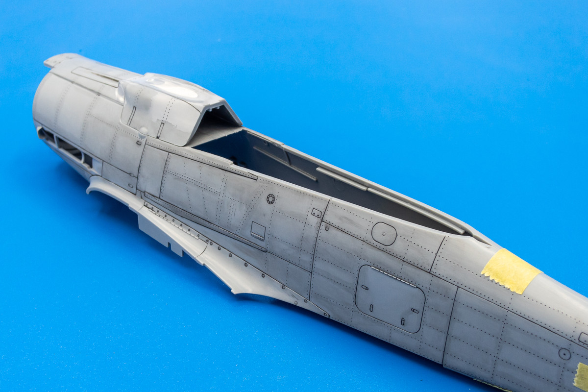

The circular hatch on the lower front fuselage is always weakly molded on this kit.
Using a circular metal template and a sewing needle chucked into a pin vise, re-scribing the hatch should be very simple. If... you do it right. I made the mistake of working on this when I was rushed for time. The template was not securely attached and slipped slightly as I was scribing... you can see the telltale double edges all around the circle. While it looks fairly good in the photo, it was obvious that the hatch was no longer circular.
So I filled it in with black CA glue.
I offset the scribing template a bit off from the original circle as I wanted to avoid the black CA glue as much as possible. In comparison, you can see how ugly the original attempt was. The new one has been highlighted with a pastel wash and the old one is completely filled with CA glue and should disappear under paint.
Like the tail, the fuselage has been riveted. The pastel wash used here is pure black to maximize contrast but I'll use a lighter wash on the painted model. This is just temporary. Curiously, the wash has caused some stains on the sanded surface... interesting effect.
I'm waiting for the Eagle Editions tail wheel to install before I attach the tail to the fuselage but fit is very good.
After the gun cowling was riveted, I put the riveted components together and put it in the light box for a review of body work so far.

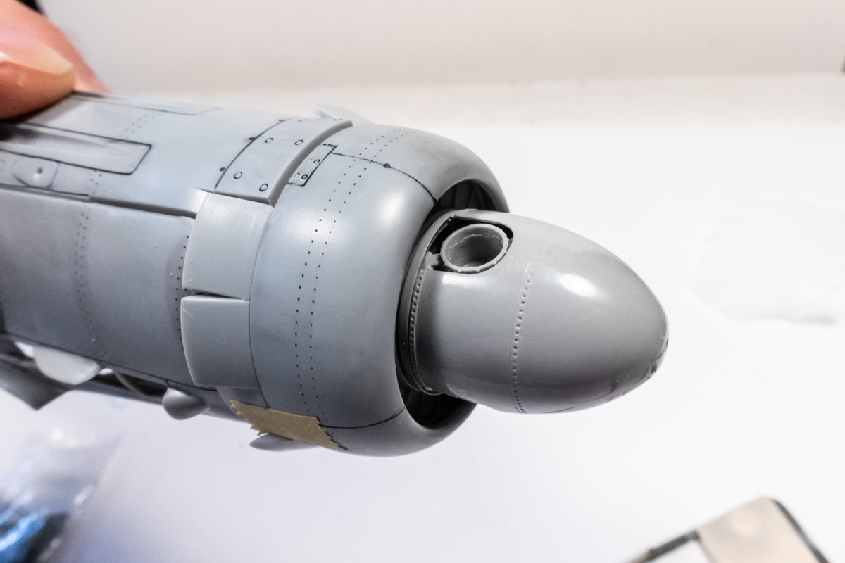

The detail on the HD prop is mostly hidden by the spinner. And since there is not enough friction to hold the spinner in place, gluing the spinner on and hiding all of that detail might seem unavoidable. However, where there is a will, there is usually a way and I found a neat way to make the spinner removable using tiny neodymium magnets. They come in a variety of shapes and sizes with the smaller sizes having a number of potential uses in modeling. The ones I have are 3mm (1/8") in diameter and 1mm thick... quite tiny but still with a surprising amount of magnetic strength.
This is the prop hub. Since there was no central cannon firing through the spinner like many other Luftwaffe fighters, this modification is much simpler.
After removing the raised bolt detail in the middle, I gouged out a 3mm opening in the hub to accommodate the magnet using a drill bit turned by hand.
A magnet is placed in the recess and enclosed into place with black CA glue. The second magnet will be glued into the spinner.
The raised detail is replaced with discs punched from sheet plastic.
Make sure you get the magnet within the spinner in the correct orientation or it will have the opposite effect and repel any attempt at connection.
The hub has been coated in primer and temporarily attached to the rest of the assembly including the backplate.
Now the spinner simply clicks into place and can be removed at any time! The small magnets have enough force to seat the spinner onto the backplate without any visible gaps.
