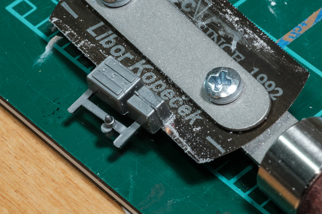

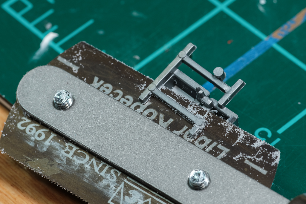

AMS is setting in big time.. Why not remove the radio boxes from the frame?

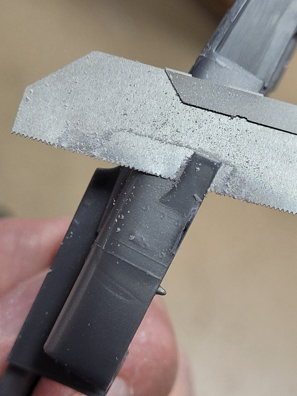

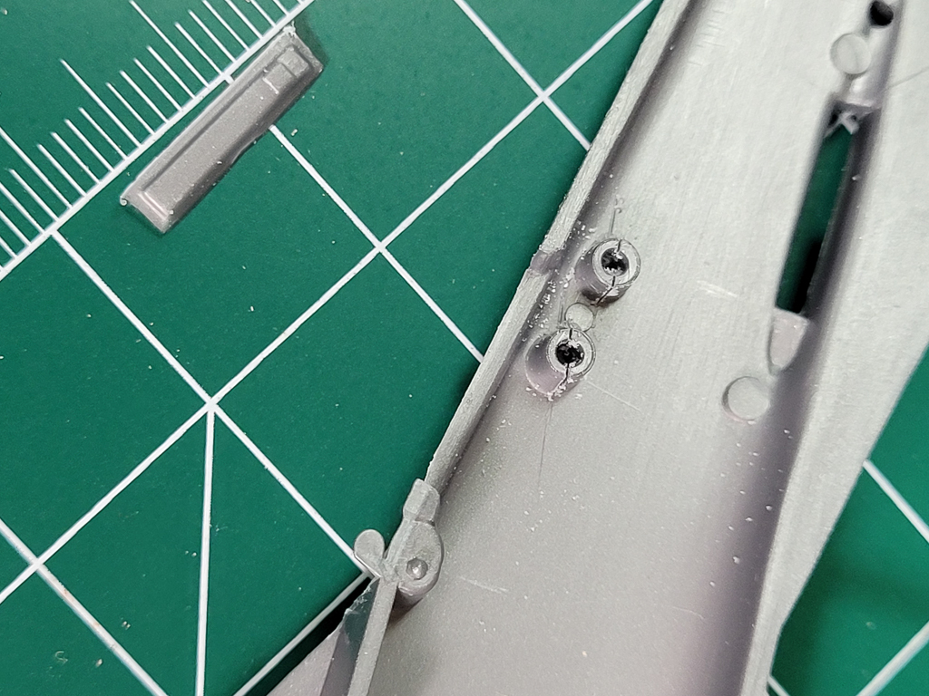

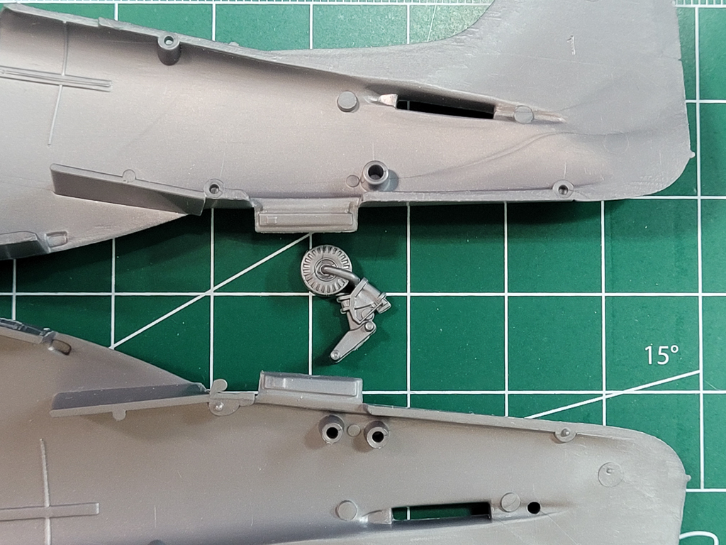

Need to also do some surgery so that the tail wheel can be inserted in the final assembly -- not before fuselage is closed up.
The attachment holes are cut in half and he lower section will be removed.

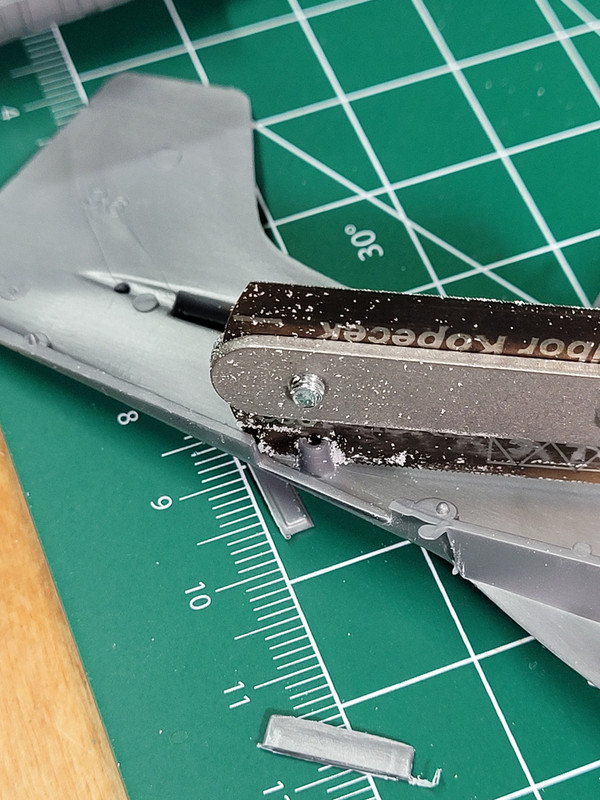

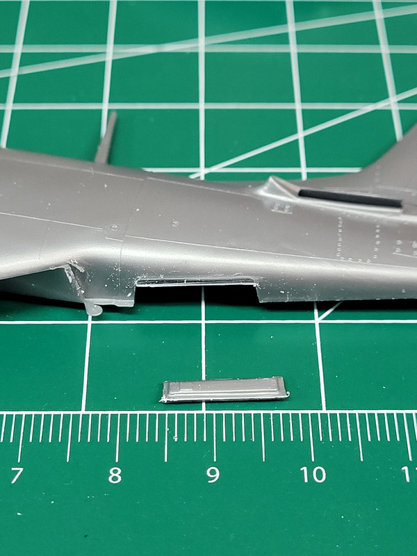

Gear doors are removed with razor saw to be refined and attached later. This also allows for easier clean up of fuselage seam

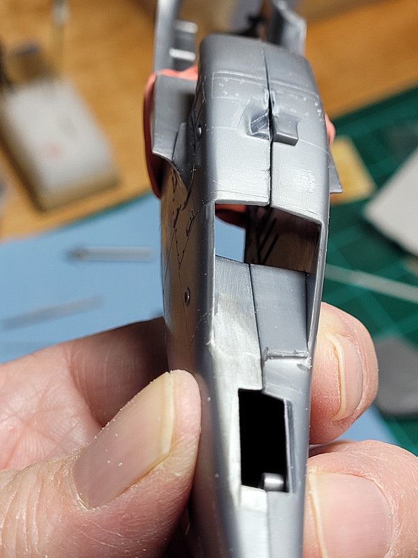

Crudest part of the Monogram P-51D is the lower rear fuselage. Removed bad details and filed down area with large step between tail wheel in radiator exhaust.

You’re doing more cutting than gluing so far… :hmm: I am quite curious to see what you’re gonna do next with this.
