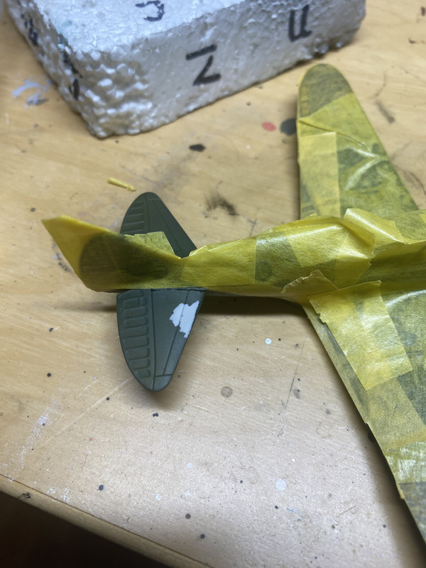

Main thinner problem was of my own making. I grabbed the wrong bottle. Instead of alcohol I added lighter fluid (which I use for oil washes). Result, a clogged airbrush and two models with bad paint. The two other models that I did in the same session are good.

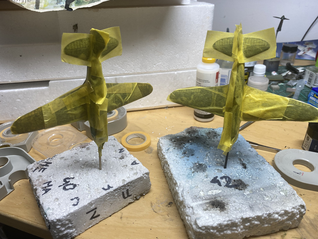

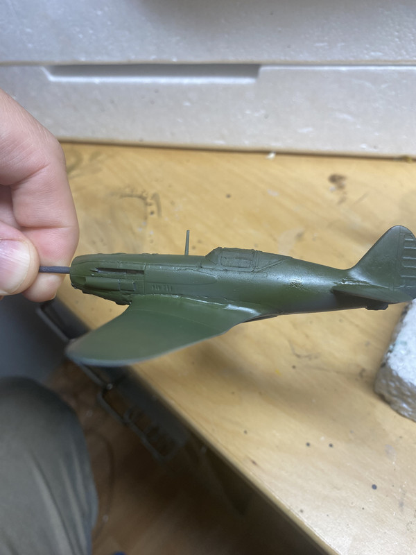

These two builds have been fighting me all the way.
I think I did something wrong with the resin (maybe an old batch?) because at few places it keeps “sweating”. I am going to try to finish it and will just see what happens with the resin problem.

What do mean by sweating? The paint sweating off the kit?
Re: Resin cast MiG-3 early
It is uncured resin coming out, I think. Westley's Bleche White used to be the best cure until they changed the formula.
jeaton01 wrote: Wed Sep 10, 2025 7:34 pm It is uncured resin coming out, I think. Westley's Bleche White used to be the best cure until they changed the formula.
Yes, that is it. If you look at the pictures on page 1 you will see some spots on the rear fuselage. I think that is the uncured resin.
There seems to be very little I can do about it. Although I have read that hot water can be used to force curing. I might give that a try.

Very impressed with the casting you did there Borg!
Annoying about the resin sweating, but I'm sure you'll get around it.

Would heat from a hairdryer or heat gun (not too close to the resin) help?
If it is poorly mixed resin you might try acetone or lacquer thinner to dry up the problem areas.
