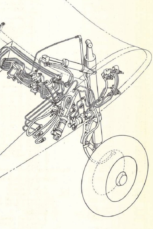

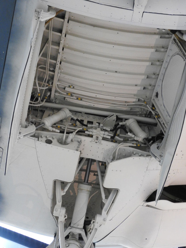

Now I'm looking at the wheel wells. There is a junction for the hydraulic lines located on the wing spar. It is represented in the kit parts but it is very small and I don't know if it is possible to drill holes in it to accept wiring. Plus I have to figure out where the wiring will be placed including the termination points where I would have to drill some holes. I'm not going for a complete 100% accurate representation but want to make it busy enough to be passable.

Here's the part. I think it is pretty accurate. It's just that the little receptacles that stick out are so small that it would be difficult to drill out holes to accept wiring. And the hydraulic lines on the restored aircraft photos are on the thick side. What I might do is add small sections of brass tubing as sleeves to accept a thicker gauge wire.speedgraflex wrote:I would replace the Tamiya part I think... would you take a foto?

Thanks for posting the photo! You’re right—the part looks great. It’s actually a little slimmer than the original though—delicate, even. The original is beefier as befits a junction box. You could easily scratch the plate from styrene with a brace, drill the holes out and run the wires straight through. I will check the parts catalog.

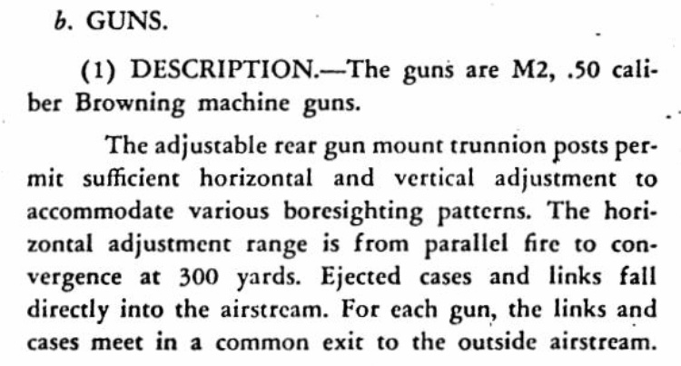

A little more work on the outer wings to report. If you look at the ammo chutes on the kit, you'd notice that the wing guns might be staggered. Photos confirm this.
So instead of placing my gun barrels straight across like I had originally shown, I've staggered them.
It's not dimensionally accurate but I wanted to give the visual impression of the staggered guns. Practically speaking, you'll be able to see the barrels that are closest to the fuselage but the others will be hidden in the shadows.

The guns were adjustable vertically and horizontally for different firing patterns. Your set up and the one in your photograph are for convergence. Here’s the relevant section of the manual:
