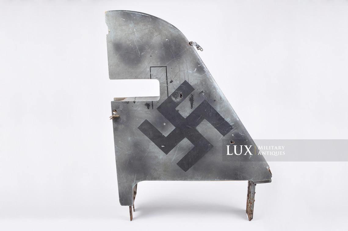

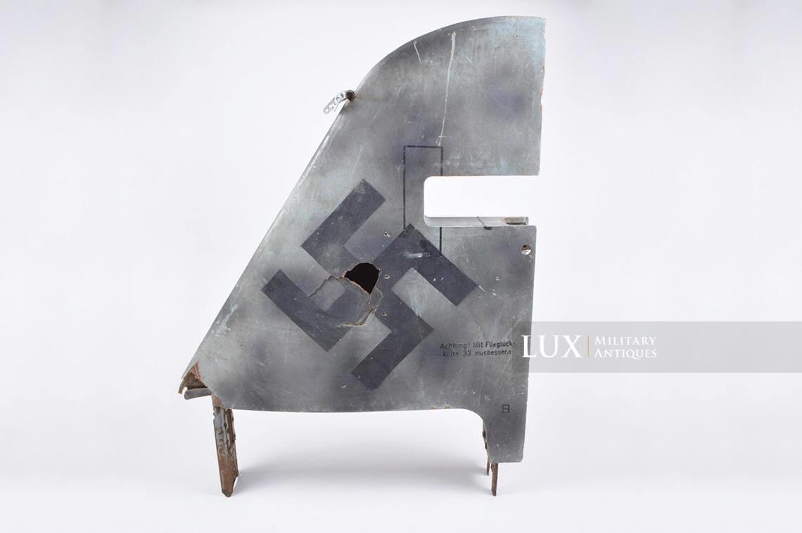

Onward to the swastika challenge next. Here are two images for position reference, since I have never assembled a swastika:
Moderating Droid Mostrich, let me know if not appropriate to display.

The K-4 swastikas are going to be tricky since they have white borders which is confirmed on photos of 265. Maybe do-able with masks but sometimes decals are a better option than paint masks. Never fall in love with a single technique. :wink:
