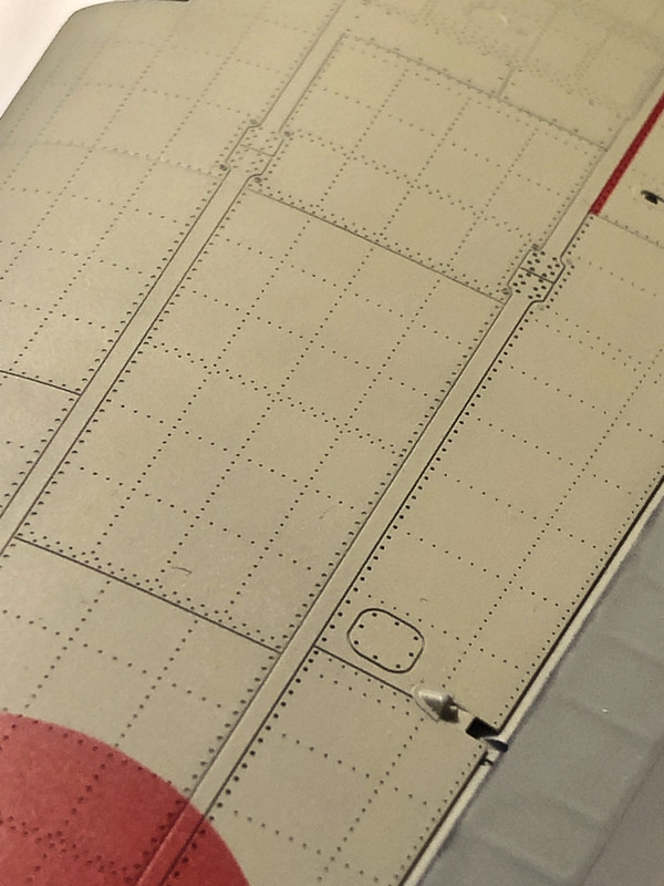

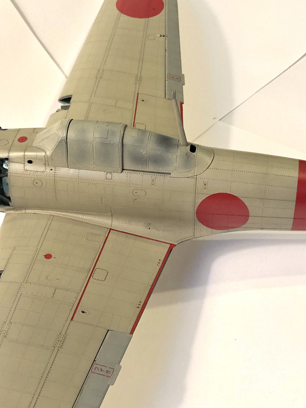

Have a look here, this is a blow-up of the aircraft’s surface very early in the painting process:
You were right on the money with what you said about the color blocking and variegation. I was absolutely attempting to re-create that on this aircraft. And what you see in that photo is me, using the intersecting rivet lines as a grid, building up the paint meticulously tiny section by tiny section. I first mottled-in a very heavily-thinned, unadulterated base color, tiny rectangle by tiny rectangle. Next, I lightened that color very mildly and mottled that in, tiny rectangle by tiny rectangle, and then lightened it a little brighter, and mottled that in. I used the smallest spray pattern I could. Super-Clean airbrush, needle just a millimeter or so above the surface. Tiny, translucent dot. Paint so thin it would almost bleed. And I built it up that way, keeping in mind to make the resulting tonal variation on as close to a “micro level” as I could get it. And you can see, I was avoiding river lines and panel lines in a relaxed way. I didn’t want a pre-shade effect per-se, it’s more like I wanted a very, very subtle call-out, once the blend coats were done, and we’re talking “practically imperceptible” here. But yeah, if you just thought “Holy crap he painted that with three or four thin layers of paint mottled into quarter inch rectangle by quarter inch rectangle” you’d be correct. And it took many hours.
After that the blend coats came. I used the heavily thinned, unadulterated base color for that. I wanted to avoid the “Tartan Quilt” effect you hear modelers talking derisively about, I wanted subtlety, and I wanted smoothness along with some nice depth. I wanted to lose about 70% of the variation, knowing that, just as you said, the cream hues won’t be present in their proper proportion if there isn’t enough paint on there. The first result looked great, but it looked too used to my eye, and the cream tones weren’t pulling through enough. NO PROBLEM. Just a few more thin blend coats got the job done.

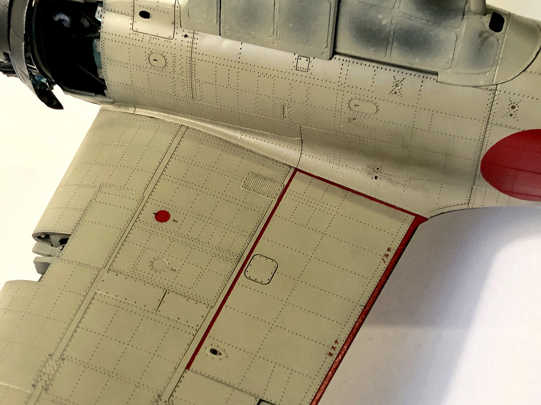

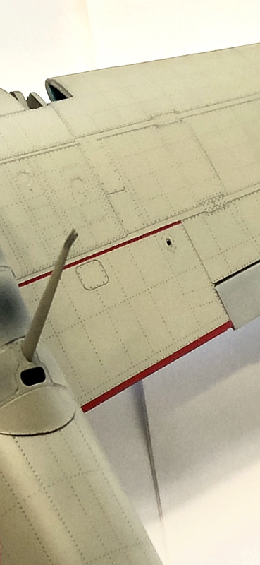

Here’s a close-up of the port wing after the clear coat has set up:
As you can see, the tonal variation was knocked back quite a bit, but again- practically brand new aircraft which was literally babied by the Japanese Navy. And there is still some depth and tonal variation in the paint, along with barely-perceptible called-out surface detail- rivet lines and panel lines —and those’ll look LOVELY when washed with the Mig Neutral Brown.

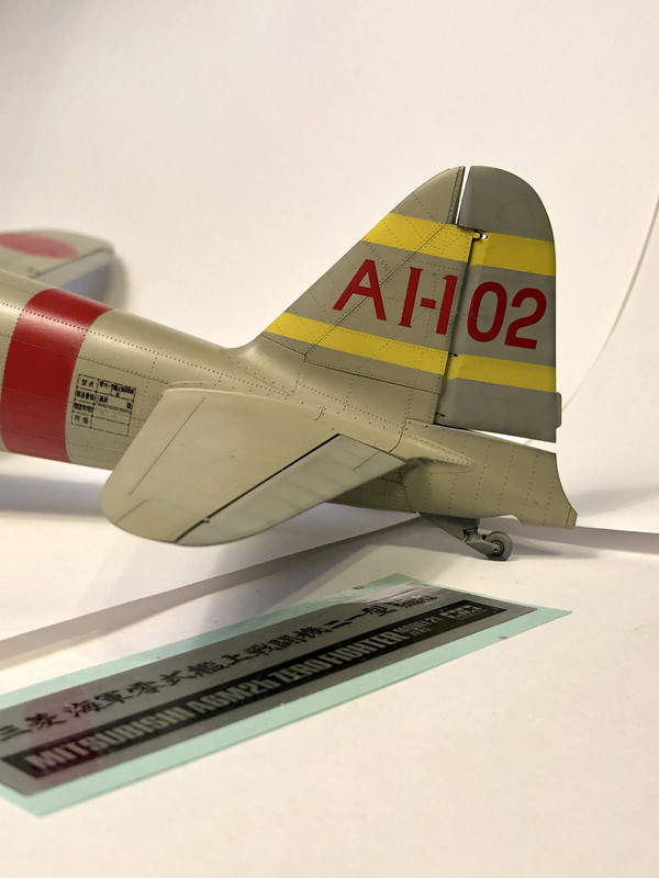

Okay, not a big update today, just some markings. There really weren’t many, due to the fact I painted most of the markings on. I’m going to do that more often. For me it’s just easier and less hassles to paint as much of it as I can up-front. The Mr. Mark Setter and Mr. Mark Softer got the job done fairly well.
I’ll probably paint the Hinomaru on the underside tomorrow. I built me a 1:32 size jig from a kid I had stashed away so I can flip this thing and work on the bottom safely. I didn’t want to perch it on pipe tobacco tins :lol:

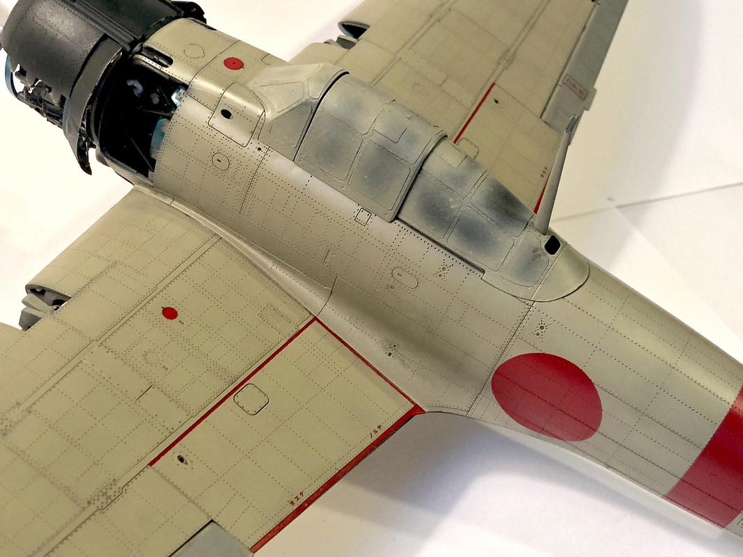

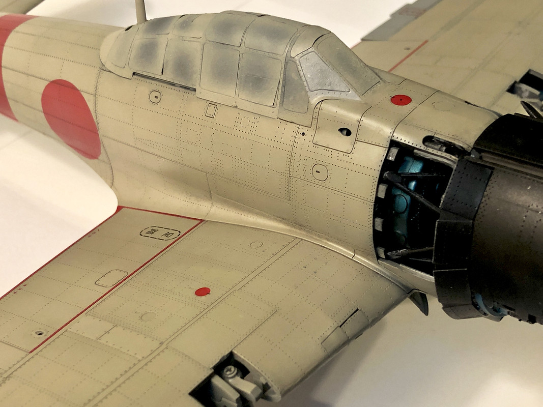

Painting topside is now complete with the Neutral brown panel line wash, and a clear coat:
The old girl is going down for a rest for a while, so I can work on the 1:72 Zeke, and decompress. After that I’ll get back to her and I’ll take care of the insignias and washes on the underside. After that it’ll be the little things- the missing fuselage panel’s aft of the cowling, the gun’s and their covers, formation/landing lights, and so on -all the small things that deserve big attention.

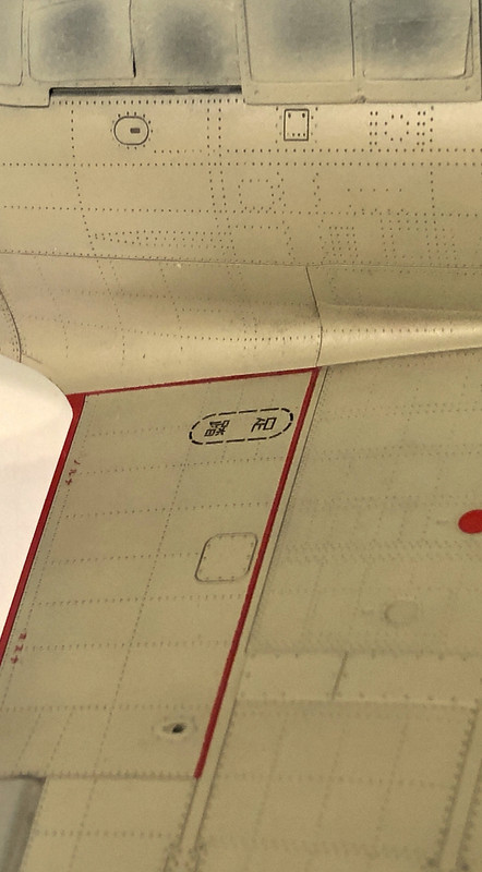

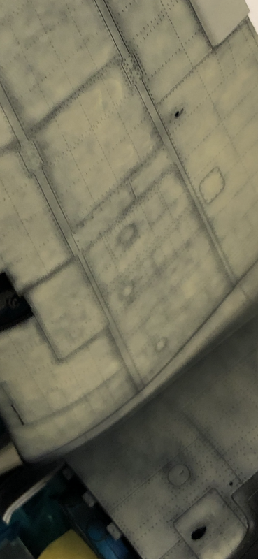

I was reviewing yesterday’s photographs, and I noticed something interesting. Have a look at this blown-up shot of the starboard side of the aircraft, particularly the area inside and around the no-walkie lines:
That is post pin wash. Now have a look at a shot I took *before* I applied the wash:
Now, it’s different lighting and a different angle but this comparison doesn’t have to be staged perfectly in order to illustrate what I’ve observed.
Look at the pre-wash photo. Much of the tonal variation has been knocked-back, and that of course was what I wanted to do. Now, when I look at the post-wash picture, and I could be going crazy here- it looks to me like after applying that wash, some of the tonal variation has returned. I can spot the hue shifts in each individual rectangular section a lot better than I could before I applied the wash. And it makes sense- the wash in the rivets created those faint lines of demarcation between each section which, I theorize, make it easier for the eyes to see each individual section and for the brain to process the, uh, “data” from each one individually when creating the “picture” we see of it. Bruce knows a whole lot more about this stuff than me and he is absolutely free and welcomed to weigh-in if he wants to, I’d appreciate it.
Also of note is how the areas into which I sprayed more of the lightened shade are being picked up. That makes sense too. The light catches the surface just right and the panels I lightened a little bit more pop out a little bit. I like that, that’s one of the things I was looking to accomplish.
