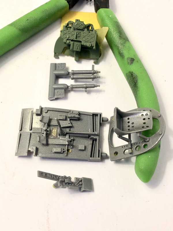

I got a basecoat of Flat Aluminum sprayed on the cockpit parts, and I sprayed over the IP with my BOOYAH! GREEN. I like the way that color looks when thinned almost to death and sprayed over the Flat Aluminum. I’m okay with using that in the cockpit. The instructions call for it on the other side of the aft bulkhead, and makes the BOOYAH! GREEN pop more. I’m going to do some chipping on the seat and the floor, so this’ll rest and cure for the day and tomorrow I’ll clear coat it. I’ll be costing it with Mr. Hobby Clear. I’m using that because I plan on using the IP decals and Inwant to use Solvaset on them. That Mr. Hobby Clear is tough stuff. Should be able to handle the hotness of the Solvaset.

As a side note, I really resisted “going commando” with no primer on as John suggested. I guess my own approach was relatively primer based. I felt with resin the color coats would just flake off, and the same would go for styrene. However, I was pleased as punch when the lacquer went down on both resin cockpit and styrene seat with the same kind of tone and tough finish. I merely report my own small experience, though.

My pal Brian has been known to shoot straight acryl at styrene without benefit of priming. He’s a madman in a lot of respects. Though, I believe he restricts this to only cockpit parts. Which, that’s probably fine. Fact about it, today’s work was acrylic Flat Aluminum straight onto styrene. No issues whatsoever. I wouldn’t do that on an airframe though. If I go the AS Silver route on the airframe, I won’t prime. If I decide to use the XF Titanium Silver, I’ll most definitely prime it and that’s the direction I’m leaning toward. We’ll just have to see what happens when I test that method out on “Reggie”, my other paint mule.

I spray Tamiya and Mr Hobby acrylics straight onto styrene and resin all day long. That's what they were designed to do. As long as the surface is clean and dry, you should have no issues. There are benefits to a primer coat, of course, but it is far from mandatory.
