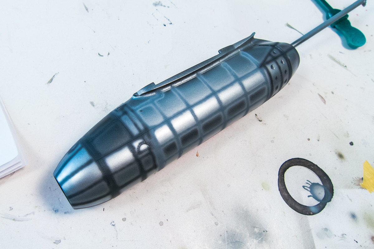

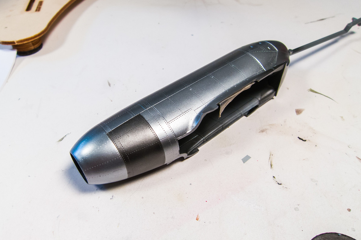

For reference... some photos of the metalized mule before I put the camo colors on.
Airbrushed putty lines...
Brush painted putty lines...
I didn't photograph what happened afterwards as I was just going to scrap this approach. But what I've found is... what comprises the putty layer is not critical, whether it is brush painted or airbrushed, oil or acrylic. The thing that is hanging me up is how to reveal what is underneath the camo. It seemed like removal of the camo layer via Micromesh wasn't working. So I was thinking that I could preserve the putty layer by restricting the depth of the camo painting along those seams. Careful painting... not sure if that was do-able without visible grain from the airbrush.

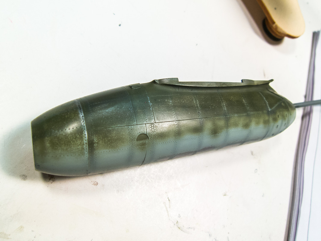

Ya know Bruce... I may have been presumptuous about my efforts on that mule. After reading your last reply, I went back into the modeling room to shut things down for the night and I looked at the mule in disappointment. I had put on some chipping via sponge along the bottom seam just to see what that would look like. It was bad. I took a piece of 3600 grit Micromesh and started rubbing it off. I then started Micromeshing the whole thing, taking off post-shading dark grey that I had tried to salvage things. The results were interesting...
Side where I brush painted the putty lines.
Side where I airbrushed the putty lines.
This approach might be workable after all. The key seems to be applying the Micromesh over ALL of the surfaces, not just the panel lines. This spreads paint removal over a larger area and doesn't take as deep a "bite" into the paint as rubbing it in one small area.
