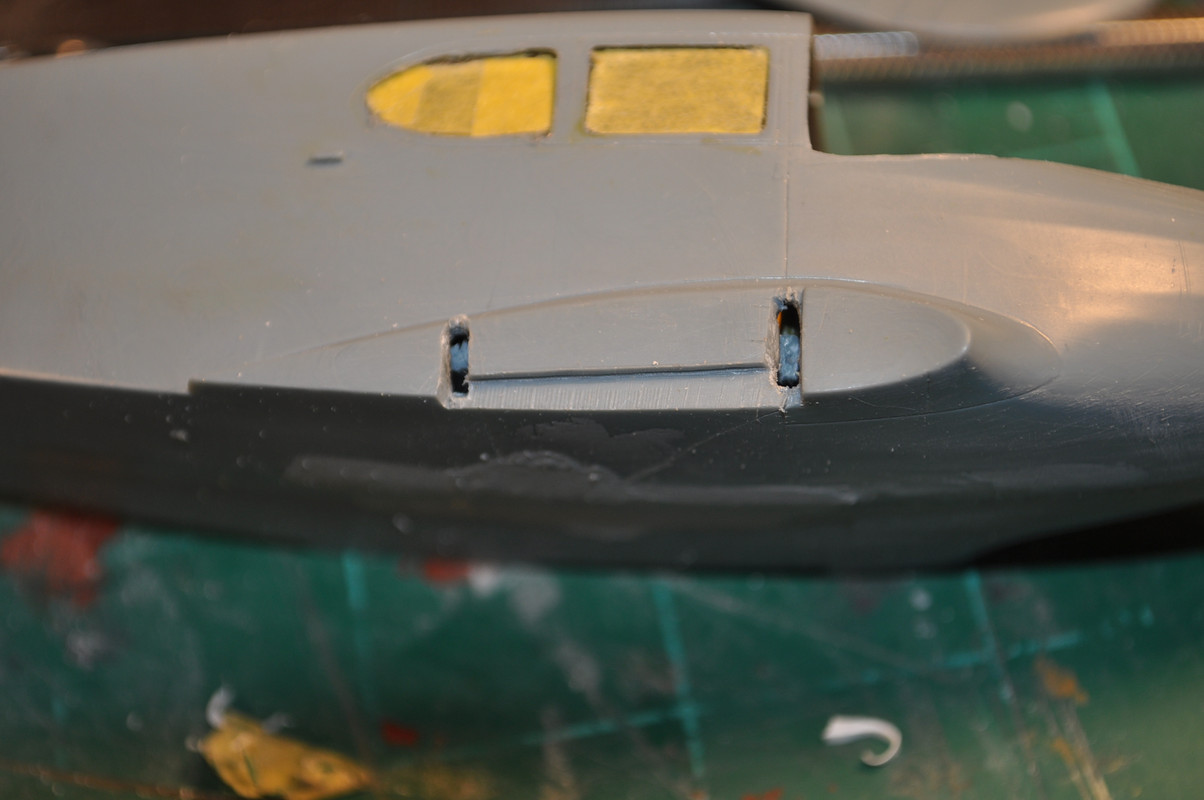

The wing joins are coming up. This should be an adventure. It is mostly a butt joint, however there is nothing to really "butt" it up against, just the .020" thickness of the plastic itself. Notice the substantial (yes, sarcastic) locating tab on the wing....at least they tried. Oh, and the fit is horrible, so there will a fair amount of filling and sanding. This means handling which means the wings will pop off.
Cogitatin' on this, I may try to add some styrene sheet stock to fill that opening in the wing root. Hmmm.

If it was me. I’d find where some metal tubing fit into the wing roots then drill holes into the corresponding fuselage areas. Have the tubing extend an inch or two out from the fuselage and into the wing to give it some rigidity, like an actual wing spar. I used steel music wire on a solid thickness lower wing of a biplane in a similar situation to give it more strength. Worked perfectly.

Been thinking about this. Either tubing or strip stock. With those options though, there is a gap on the wing side and nothing to provide any backing for filler. Maybe some cardboard or something. Don’t know yet. I like the idea of tubing...easier to drill a hole than cut a slot in my case. I may also scrape out the recess on the fuselage to make it a bit deeper. That may close it up some.

Okie dokie.....by scraping out the recess that the alignment tab sits in, it did improve things. Crappy picture, but I could not hold the beast and take the picture at the same time. Fit isn't perfect, but I think it is manageable. Other side is about the same.
Decided to use a combination of brass stock and plastic on the wing mounting. I only had some 1/16" brass stock - square. I cut some slots, thinking I'd run the plastic strip all the way through the fuselage. Nope....floor of the cabin is in the way. So, only the brass square bar will go through. The plastic will be inserted about 1/4" of an inch into the slot

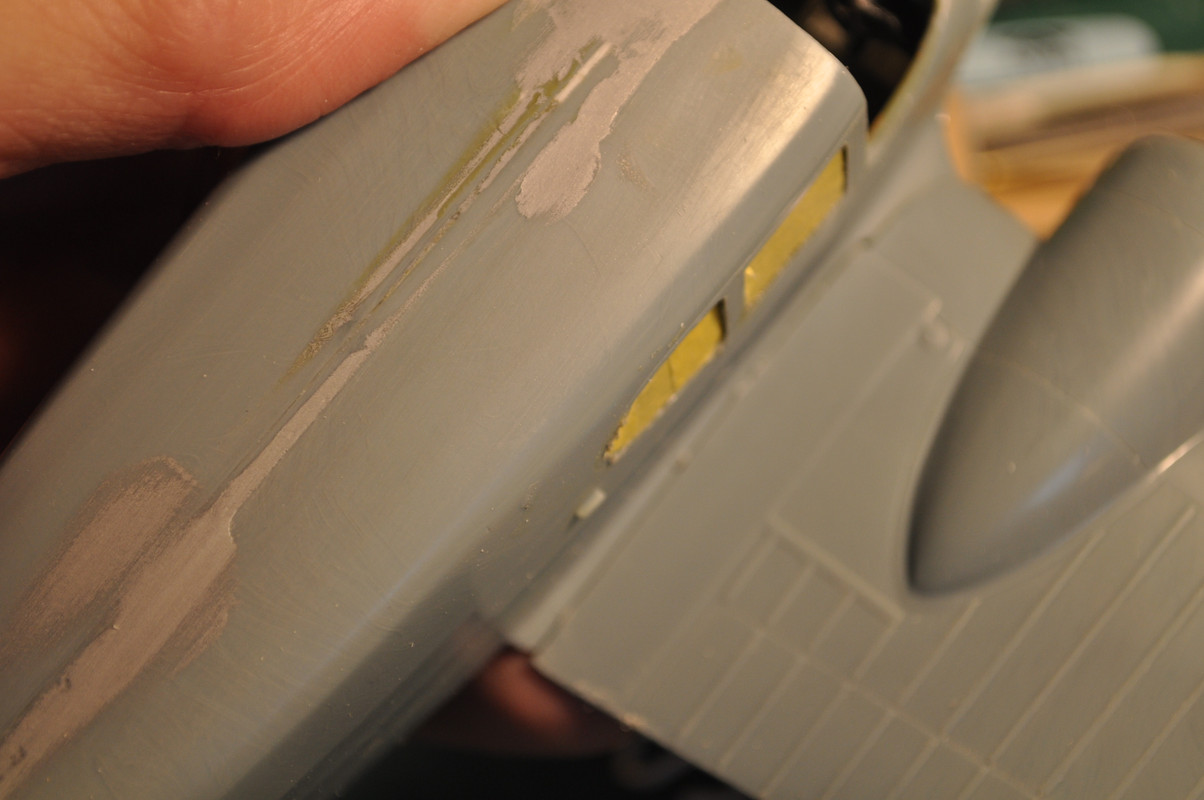

Might as well fess up. I added some filler across the top of the fuselage. I wanted to “hurry it uo” a bit.
Yeah, you can probably guess where this is going.
Uh, sort of forgot about it. I had placed it under a desk lamp.
Well, it looked like a popsicle left on the driveway in the summer.
Melted the Bonde.
Melted 2 or 3 BB sized holes along the seam.
A good icnch or a bit more started to sag down into the interior.
Smokin’!
No, I did not take any pictures.
Yes.
,I think it is salvageable. Already put the first coat of filler on it.
