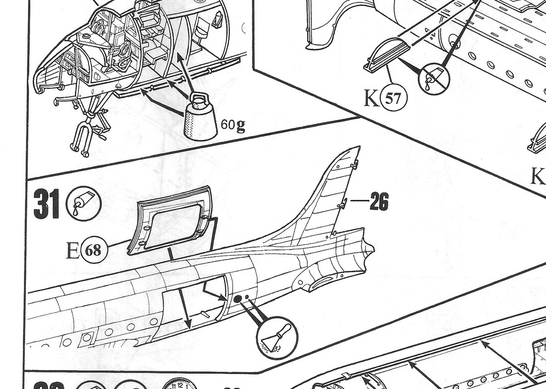

Another small "gotcha" on this one. …. sometimes, they will put a number in bold print like 66 and maybe "X" it out - somewhere in a stop. That will usually mean go look at the step they X-ed out and see what it needs...have to watch those.
This one is a bit different as is the one in step one (removing hinges is you want closed gear doors - step 22). See part O63 The two small windows behind the cargo door? Great. Glue 'em in.
Oh, you want an option mentioned in Step 31, a page later? Fill 'em in. At least that is what I think the little scraper symbol means. Not listed in the front of the instructions.
if you choose this, it would seem to be easier to fill those openings at the outset.

Lyle, you are right about that little scraper thing being a "fill" indicator. I guess the best thing to do is to go through the instructions with a pen or pencil and make notes for the different steps one must take for their chosen scheme. I need to bring mine down and get started on it.
