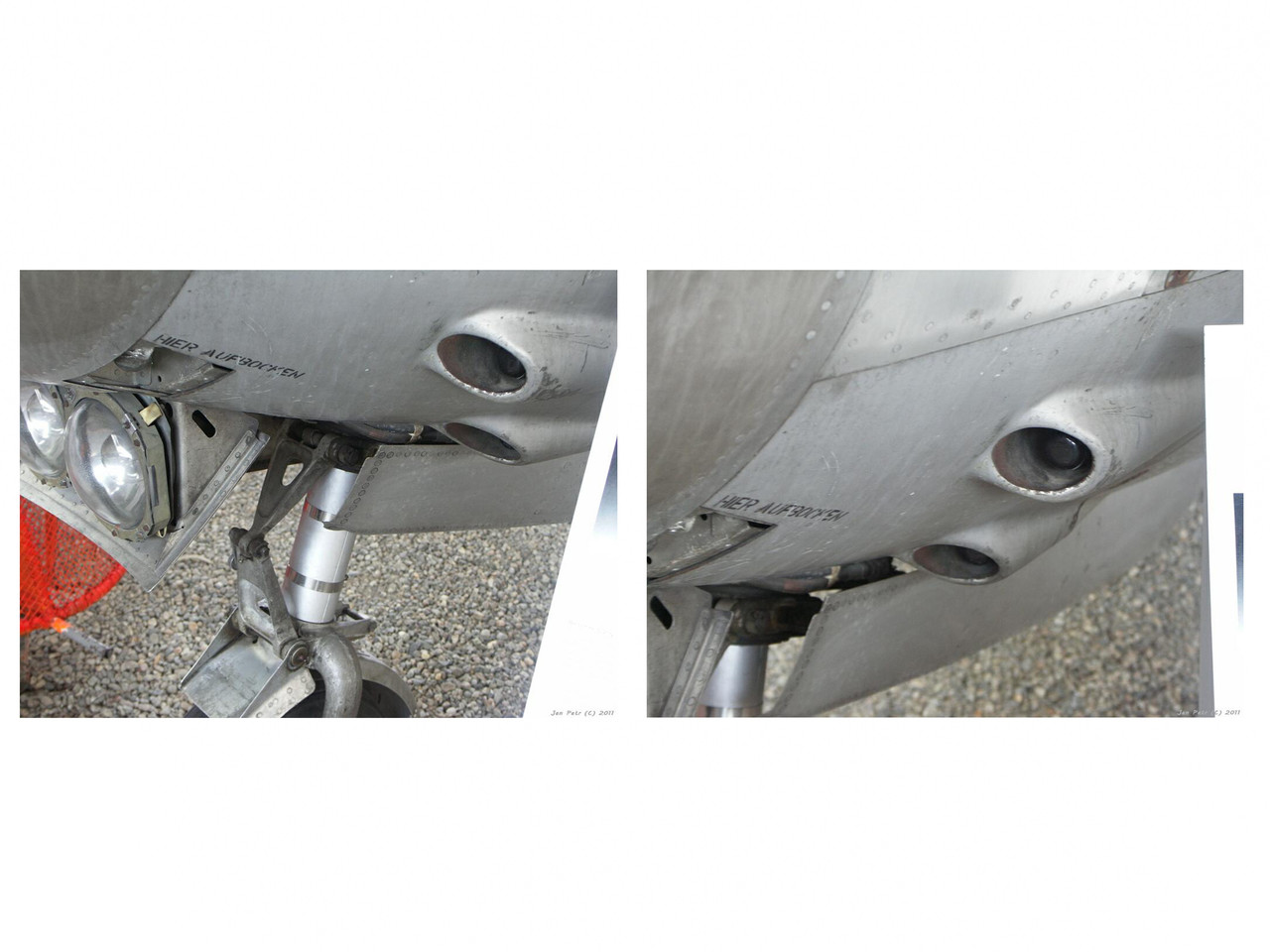

Last night I took advantage of slightly cooler temperatures in Southern California, along with my Dad’s needle files to start adjusting the streamlined gun shrouds which Matchbox rendered very simply.

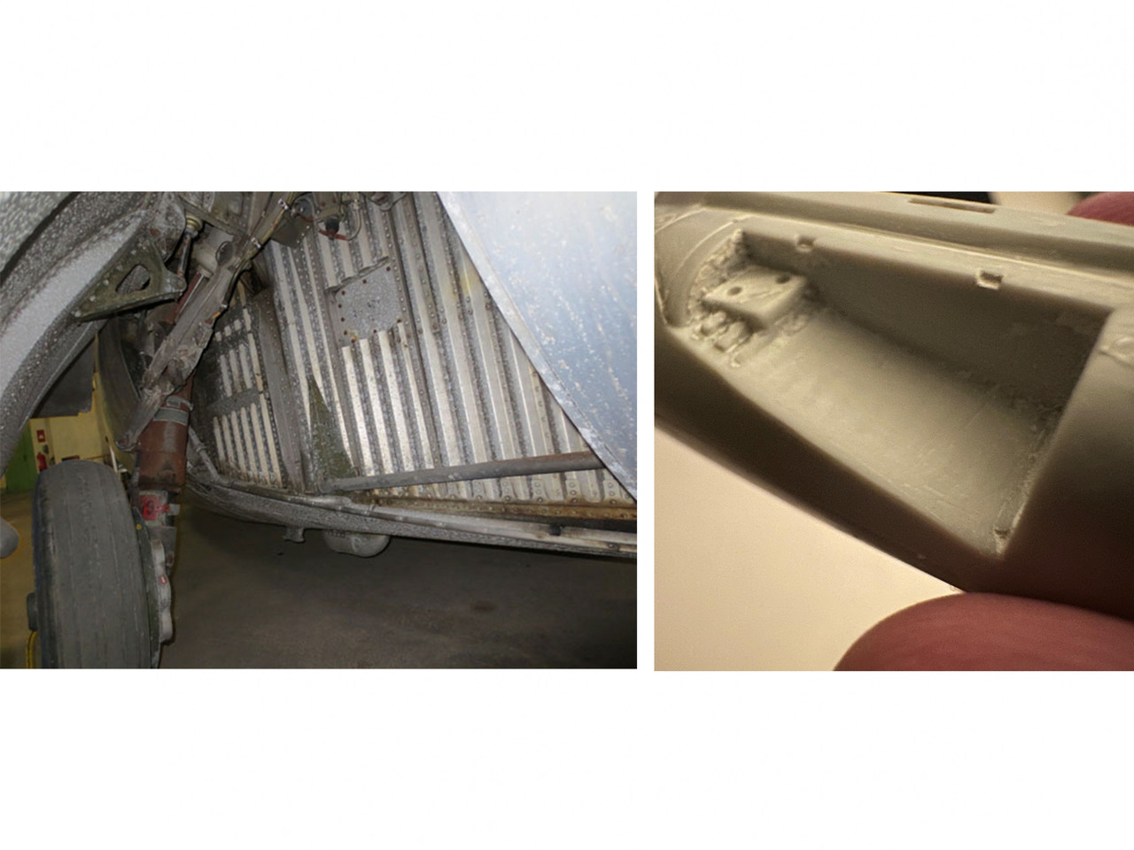

Thank you, Stuart. I’ve been making an attempt to modify the guns and I’ve also removed the oversized interior details from the landing gear bay. I fancied a bit of carving last night while watching the telly.
You can see three remaining stubs in the far corner. Had to get the knives out for those. Satisfying remodeling.
To give Matchbox credit, they did add 12 of these interior braces to their design; I’m just following that “wild hair up your arse,” as my Grandfather might say and always with a shake of the head.

Thanks, Stuart. It only took me about 20 minutes per side to do away with the ribbing. I’ve spent twice as much time shaping the gun shields and these are at the check stage.
It’s a lot easier now that the interior bays are flossed to give them some attention. I am deciding if I should cut and measure thin plastic card to add a better level of detail here. I can also go a bit wild and add hydraulic tubing inside, too.

Some thin Evergreen styrene strips would work great to replace the removed rib detail in the wheel wells.speedgraflex wrote: ↑Thu Sep 03, 2026 11:10 am Thanks, Stuart. It only took me about 20 minutes per side to do away with the ribbing. I’ve spent twice as much time shaping the gun shields and these are at the check stage.
