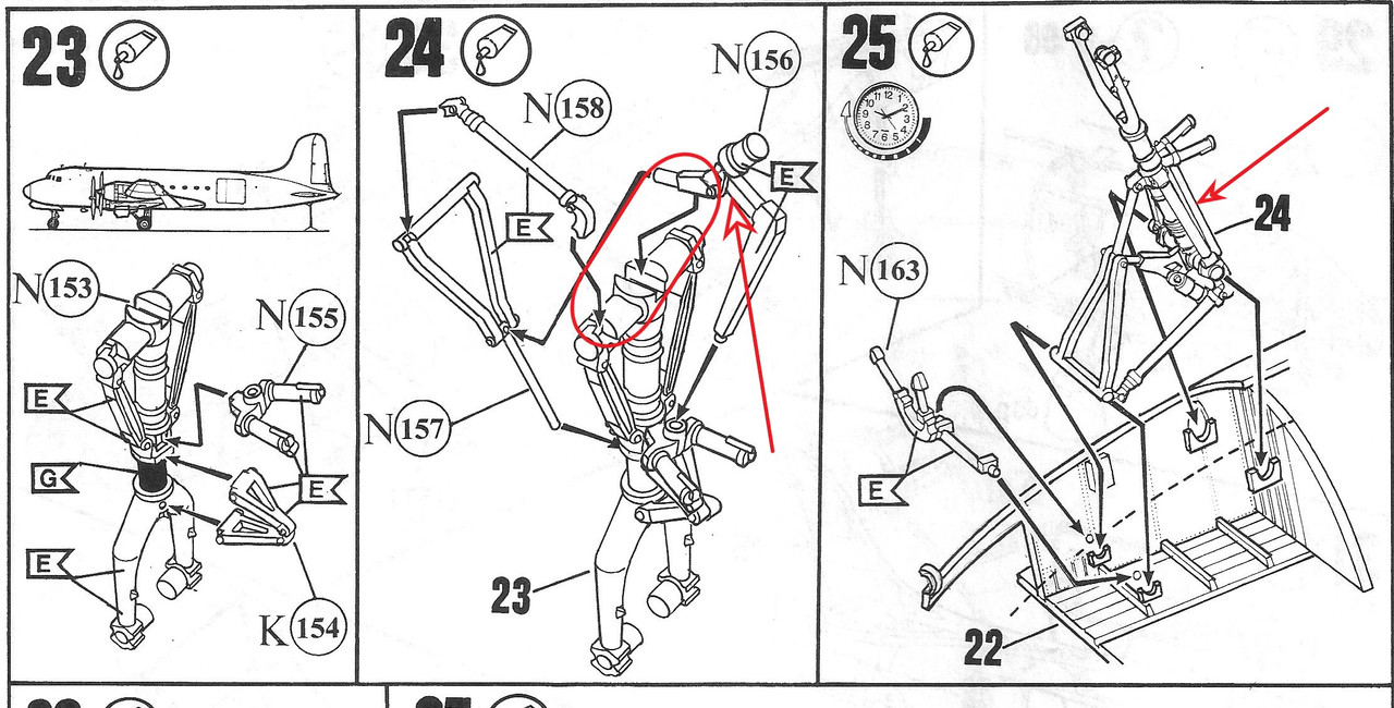

I am eager to get the fresh parts and see what happened. I do think I'm closing in on the answer, though. As dumb as it sounds, this has been weighing on my mind for a while. I think the answer may be below...
1. The notch in the center of the strut is to hold the squared off section of part N156 - or so it looks in step 24. Notice the placement arrow.
2. If you look closely at step 25 in the red arrow and the bold 24 - that part N156 is pretty much flat against the strut N153. There is a small square piece you can see in step 24 just underneath the letter E. I believe that is what fits in that notch. That would give the extra length needed to fit that rod properly. Again, looking at step 25 closely, the cylinder that juts out seems to be on the left side of the part. Clear, huh?

I asked Revell GmbH about my thought. They seem to disagree. Oh well. Perhaps I either cut or broke a bit of the end off of part 156. They wanted to know if 154 and 155 are installed correctly. I think so, but...…………
Anyway, likely back to square one. I've asked if they have any pictures of this assembly. Frustreating.

Take this as my opinion only, but the illustrator took into account the reorientation of the part first and depicts the part in Step 24 reoriented to stand upright. Essentially a tripod is being completed. The third leg of the tripod, which is the part in question, is shown too simplistically as being a straight tube and not angled, while attention is meant to be directed to attaching the part (central landing gear?) to the other legs of the tripod itself.

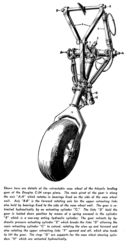

Found this illustration from legendsintheirowntime.com. Seems to support part of my thoughts anyway. You will need to tap the image to open it in post image. Looking at some Spruefest shots that I’ve found online show a longer protrusion on that part. I guess the replacement parts will tell.
