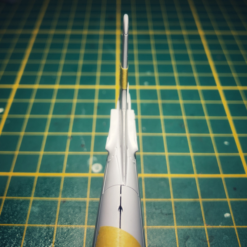

I started also to build with the new Airfix P-51D and look at this...
Even if just dry-fitting, it does not change the fact..that the centre line alignment with the vertical stabilizer is totally off, unbelievable!
The fit as such is pretty ok...
This if something kills the the motivation to continue with the project..
Re: Airfix 1/48 (New) New tool P-51D
Oh man I’m sorry to see that! That’d kill my motivation for a project too.
Oh wow! I'm assuming that the P-51 did NOT have an asymmetric tail. Ya never know with props rotating in one direction... I believe the Macchi 202 had one wing shorter than the other.

John, you’re onto something. Here is the technical description of the tail of the P-51.
The vertical stabilizer is a full cantilever structure with an area of 9.98 sq ft, and set 1° to the left, rotated about the centerline of the rear beam, to counteract the torque of the engine. It is constructed around a forward and an aft spar of 24ST Alclad, flanged ribs of formed 23ST and heat treated 24SO Alclad, covered with 24ST Alclad sheet. The skin is stiffened with light rolled stringers of 24ST. The tip is of 52½H aluminum alloy formed about 2 supporting ribs and is non-detachable.

Yes I think the 'stang did have an off center angles tail to off set torque...
