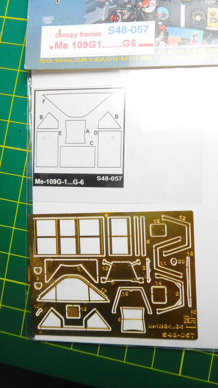

I have an AM PE canopy for a 109 G-series in 1:48 scale... For these kind of "squarish" canopys the solution is quite straight forward.. at least masking could be skipped entirely.. Then again the bending of those frames could cause other issues....
Not sure how common AM PE Canopy frames actually are... and why they are not used more ? :hmm:

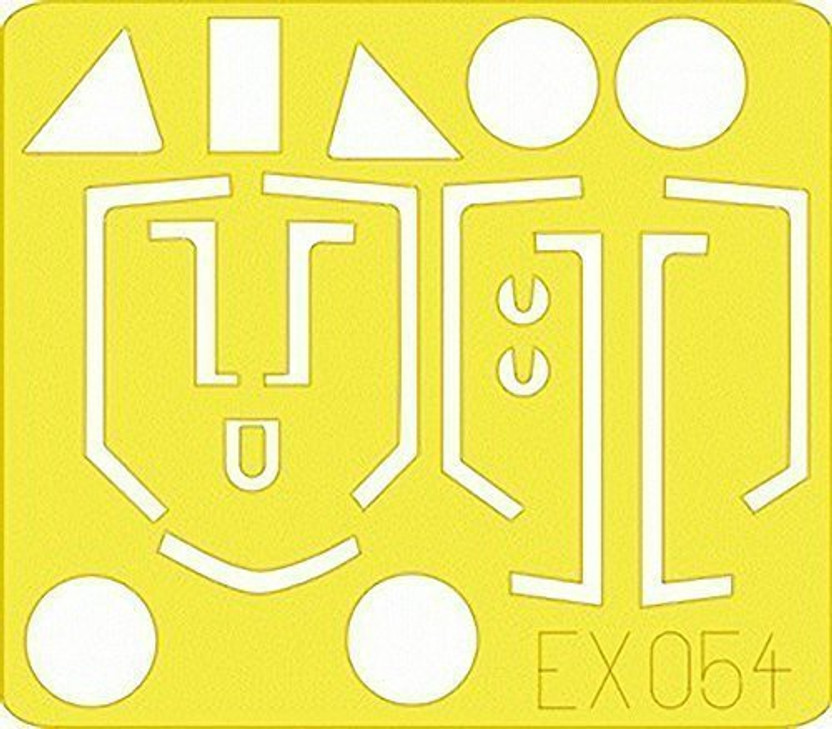

Masking canopies is definitely a challenge but worth the effort. I prefer the yellow tape for masks... the Eduard ones, if they are available. I find the fit of Eduard masks to be very good in most cases. The only ones I don't like are those long thin ones...

I was using the Eduard masks. Never had a problem with them in my Emils but these for the Corsair, I didn’t like so much. Meh. Stuff happens. And they’re convenient and good quality. I’d use them again on other models, for sure.
