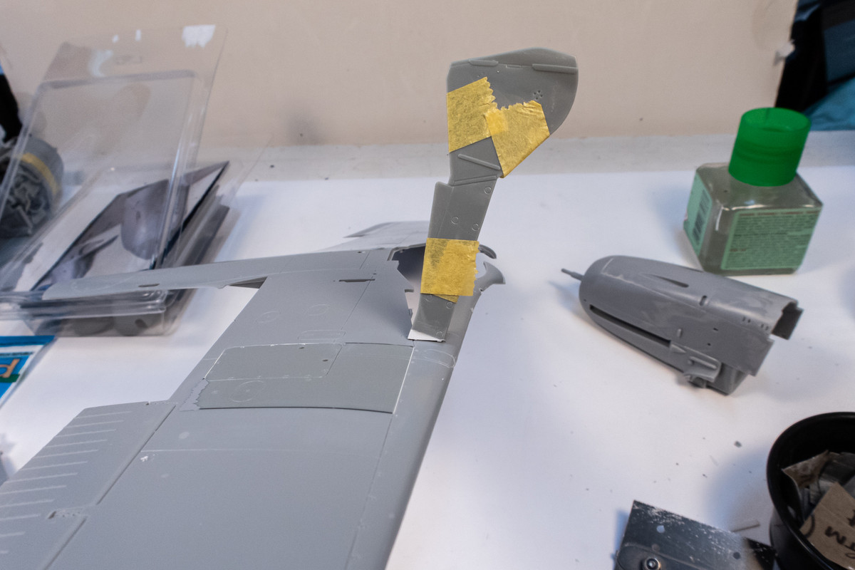

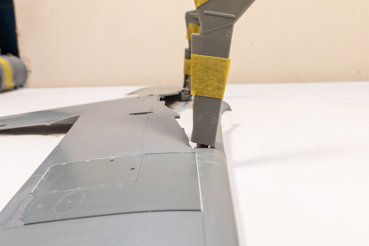

Another small detail that I want to address is the landing gear cover. The Hasegawa main landing gear cover has a noticeable gap at the base.
In actuality, this cover extends into the wheel well. Due to the lack of spacing, I can't make that happen but I can reduce that gap visibly using pieces of sheet styrene.

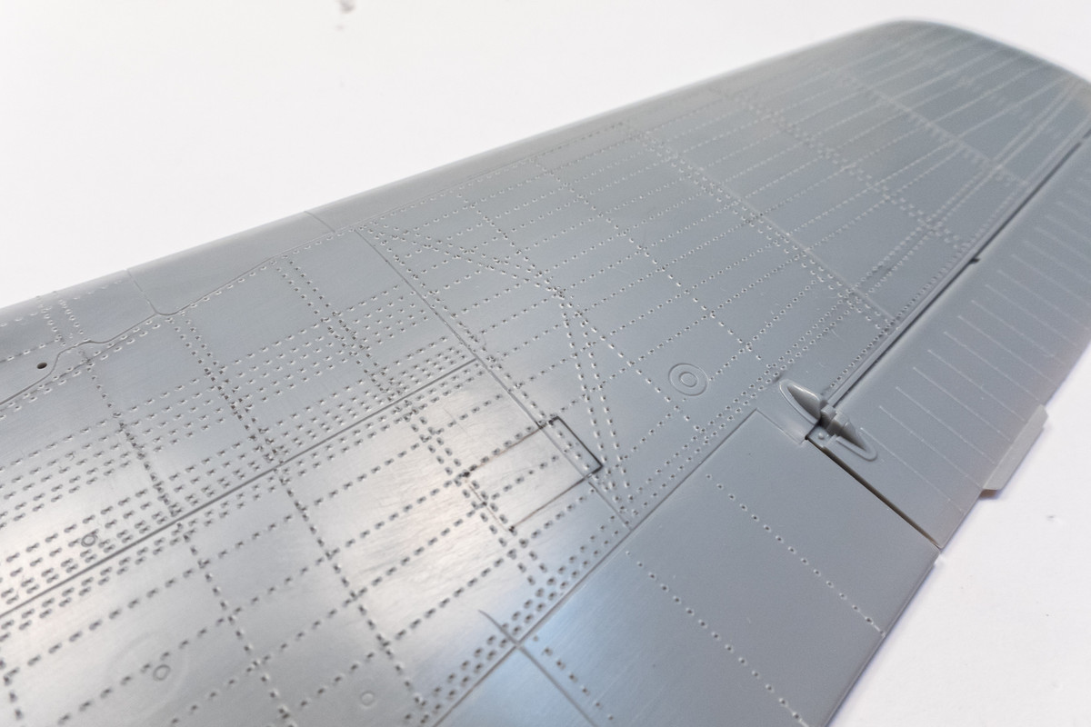

Thanks guys! Jumping back onto the D-9 build for a bit... I thought I'd get the upper wing riveting out of the way. Riveting takes some time effort and I need to be motivated to actually put in the hours so when the inclination bubbled up this afternoon, I took advantage of it. The first and most tedious step is to draw the rivet patterns on the model parts. Lots of rivets on the upper wings!
Once the rivet patterns are drawn, a wheeled rivet tool is used to punch tiny holes in a linear row.

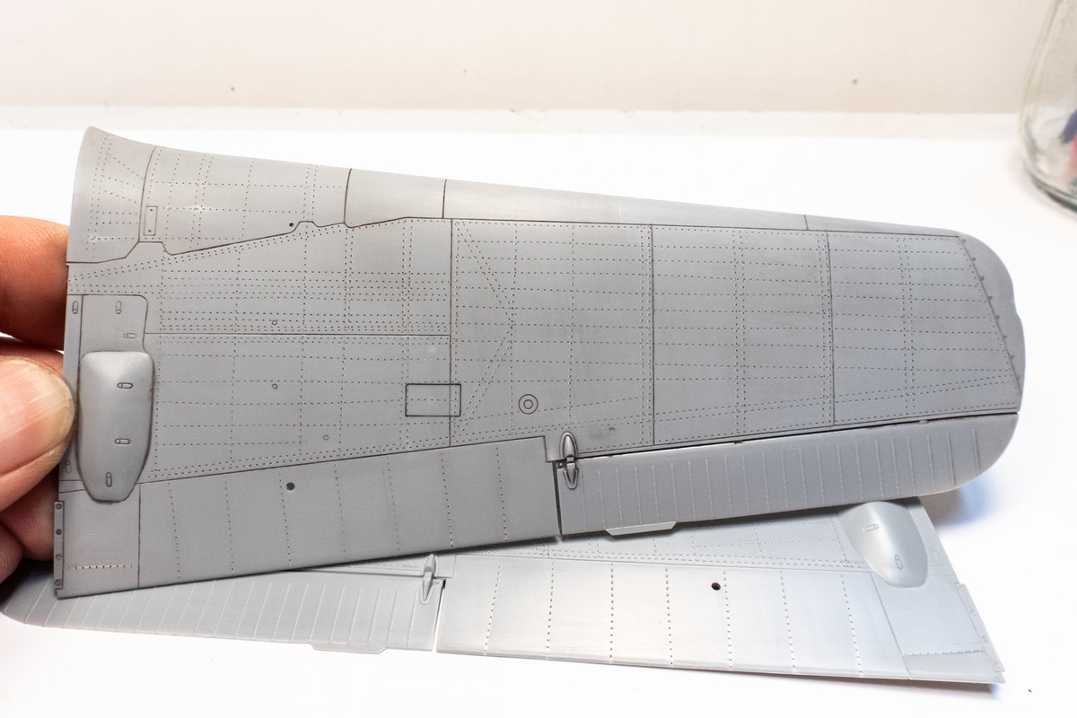

The wings are then sanded to get rid of the raised plastic around each rivet hole. A temporary pastel wash is used to check the results.
You can see that the wing surface is nice and smooth now compared to the pic prior to sanding.

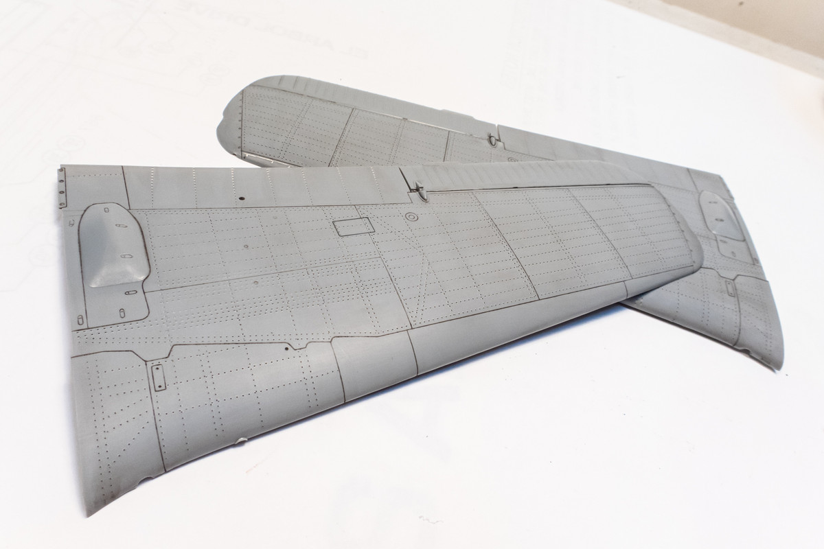

Both upper wings have been riveted.
Circular fasteners along the leading edge of the wing that are added using a beading tool.
