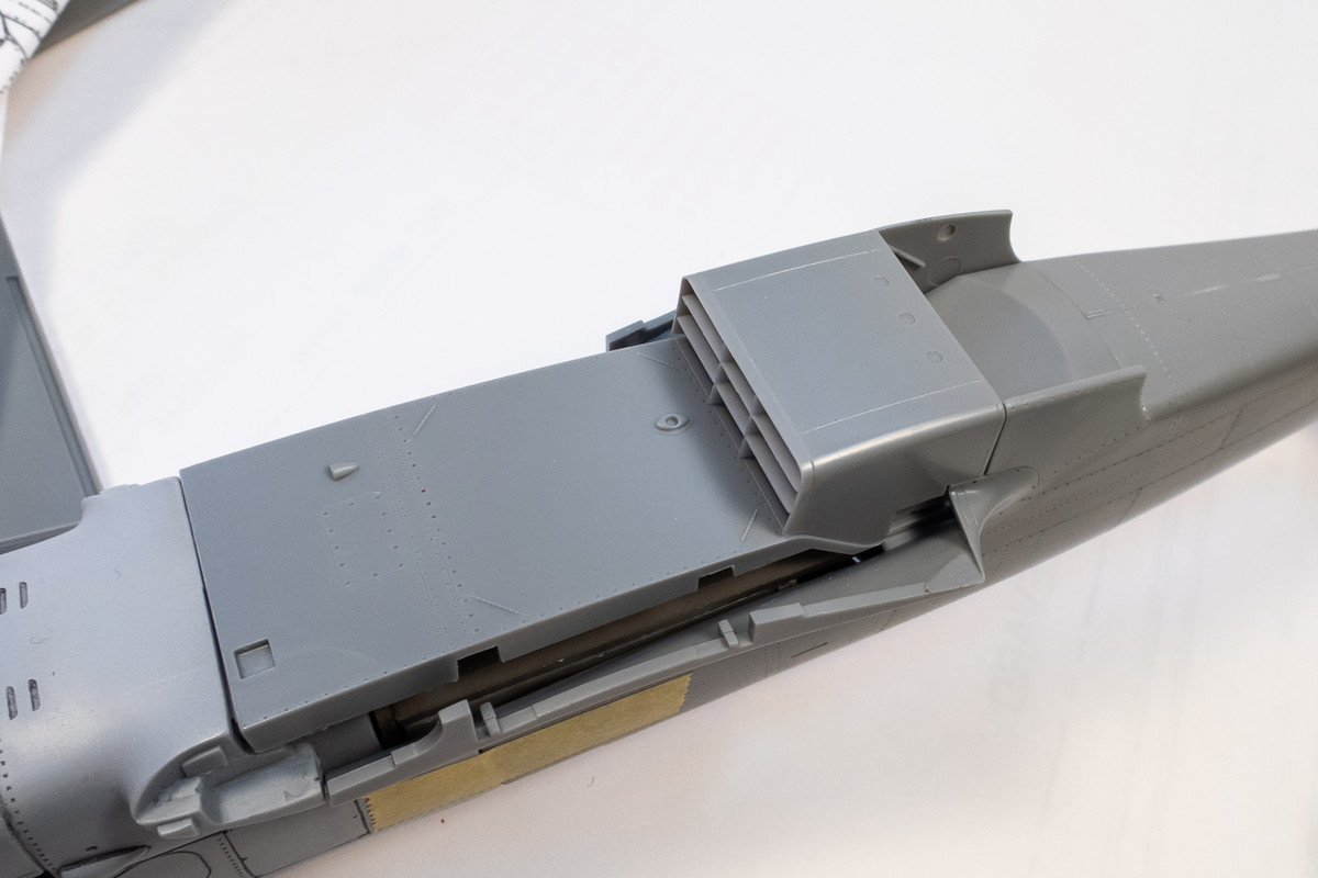

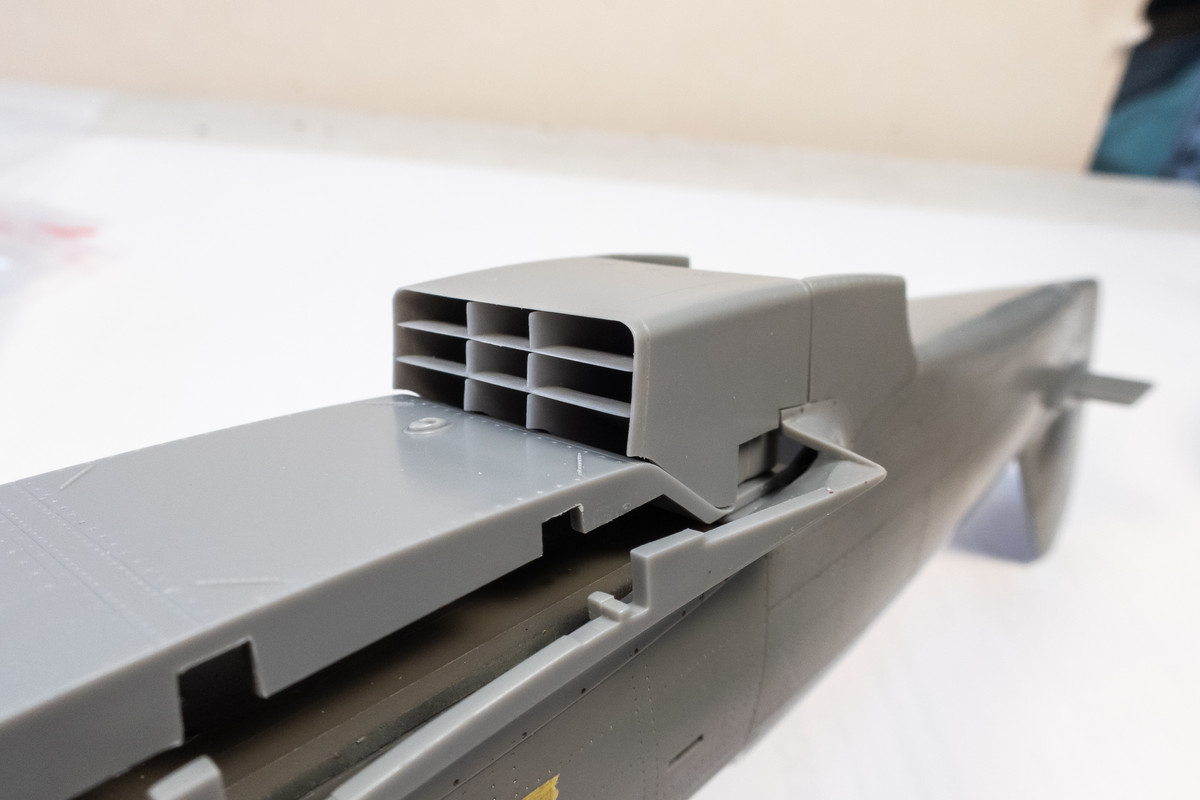

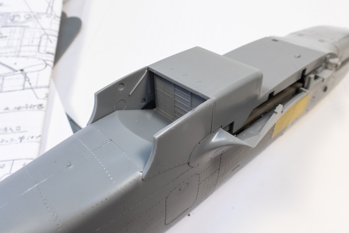

I've tinkered together the radiator/oil cooling intake. The leading edges have been thinned.
To match the rest of the aircraft, I'm going to apply rivets to this assembly. Here's the before pic...

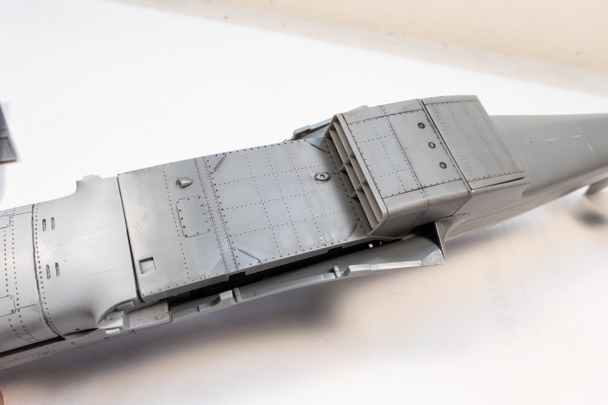

Based on my reference drawings, I'm adding a panel line to the rectangular housing.
Here's the area after the panel line addition and rivets.
Mulling over how to thin the trailing edges... it might be do-able with some careful sculpting.

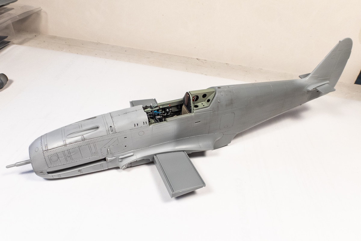

It's time to start gluing the fuselage components together.

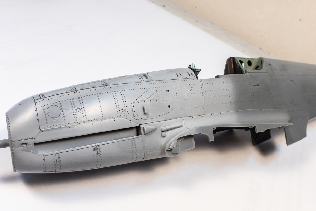

First up is the Wolfpack resin nose. I've test fitted it multiple times and am ready to glue into place using Black CA glue.
The starboard side butts up together very nicely.
There is a bit of a gap on the port side. I've filled this using more Black CA glue. To minimize the sanding, I used a cotton bud moistened with CA glue debonder to level the glue gap.
Thin CA was seeped into the other contact joints and the gaps were touched up with Mr Surfacer 1000. This usually takes a few iterations and in the process, the panel lines and rivets were cleaned up as well. This is what the joint currently looks like with a thin coat of Mr Primer Surfacer 1000.

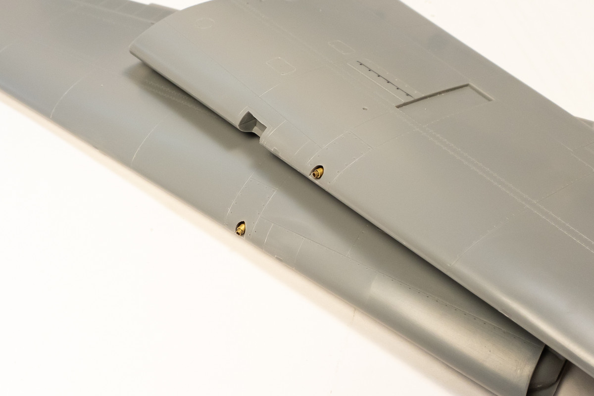

Another task that I was able to complete while waiting for the putty to dry was fabricating the wing gun barrels using brass tubing.

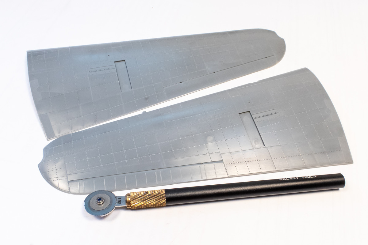

I decided to rivet the wing tops at this time. Rivet lines were laid out using a soft leaded pencil.
The Galaxy rivet tool in 1.00mm pitch was used to punch the rivets along the drawn lines.
The riveting process creates small mounds of plastic around each rivet hole.
I choose to sand these mounds away, leaving just the hole.

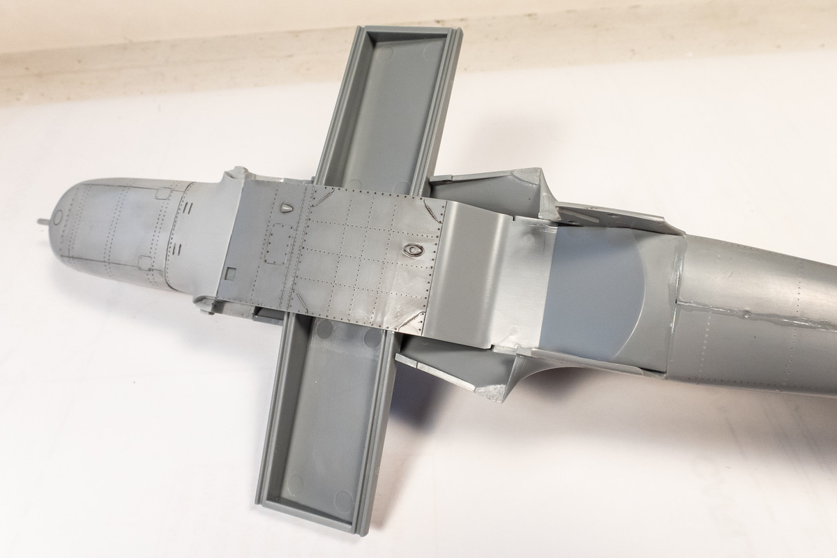

I've glued the wing spar and the fuselage bottom into place. The rear joint will be addressed now but I may wait to do the front joint after the wing bottoms are attached.
