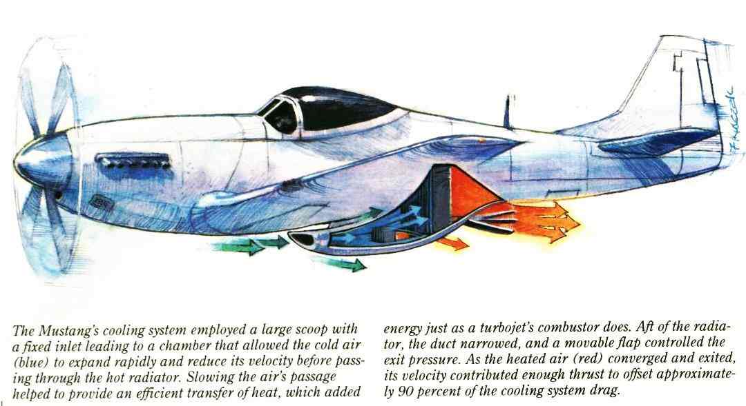

... looks like the radiator door is closed; it must operate to control air flow; I seem to remember reading about how this works at some point; I think I am gonna model it closed based on what I am seeing during these period photos (the restoration Mustangs seem to keep the door open, maybe that helps keep air flow going through the supercharger; my brain is mush right now). Any thoughts?

Radiators are usually minimally open in flight and max open on the ground to reduce overheating when the airflow thru is reduced.
- Posts: 11465
Re: Hasegawa 1/32 N.A. P-51D "Cripes A' Mighty" IV SN 44-149
Thanks so much, Carlos. Now I need to modify the door to close properly!

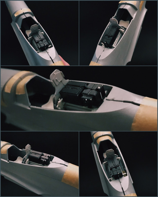

Cockpit views- the figures shipped out tonight. I am prepping the cockpit seat supports.

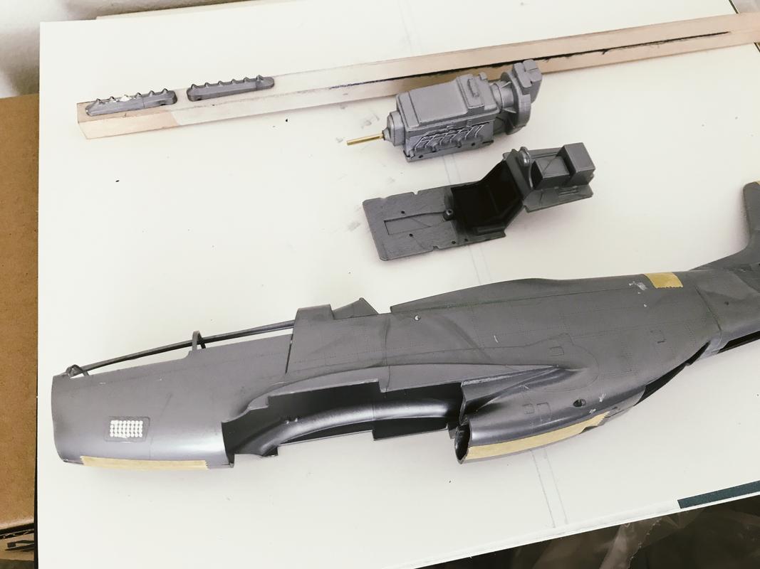

Original kit cockpit- for posterity.
