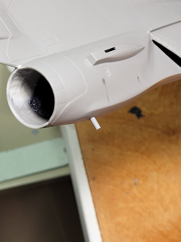

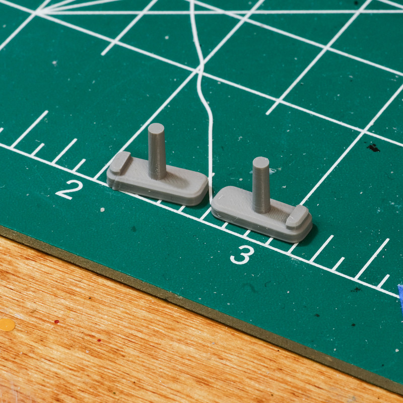

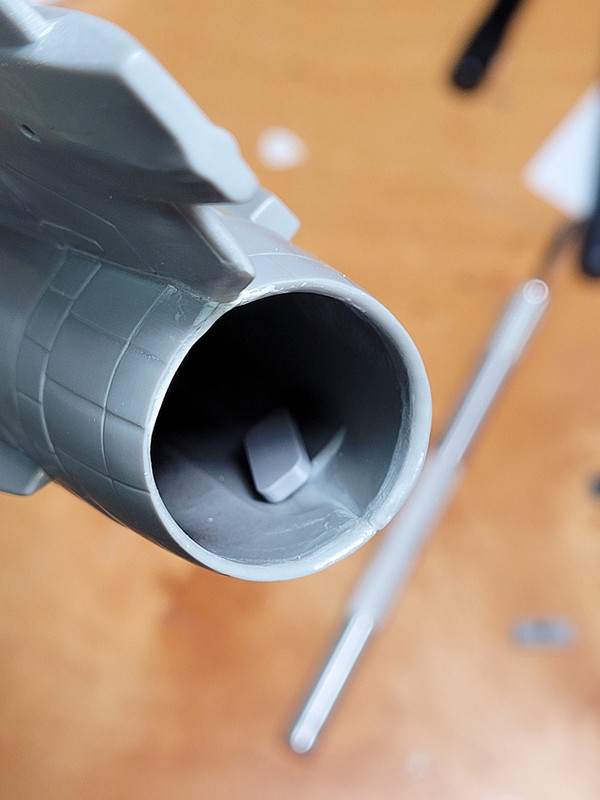

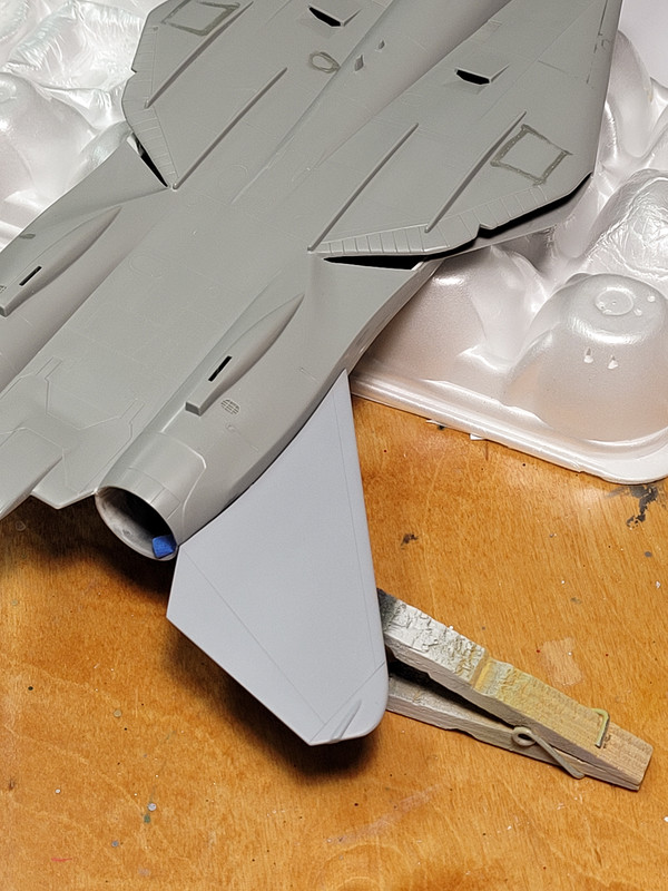

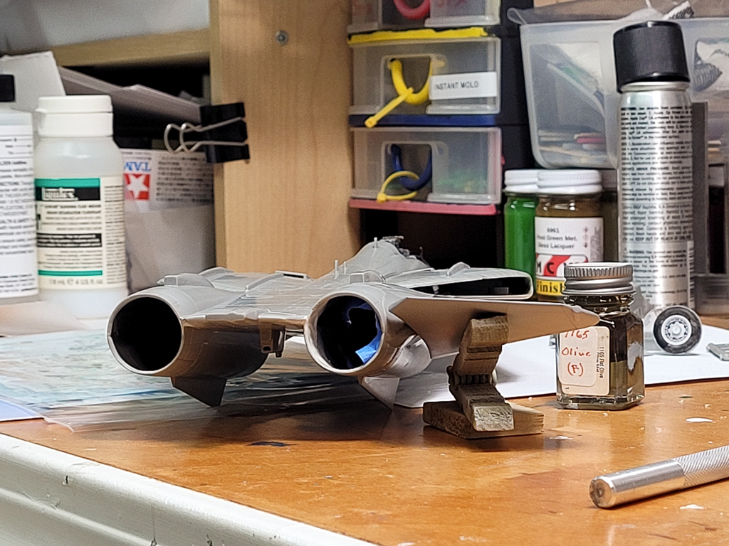

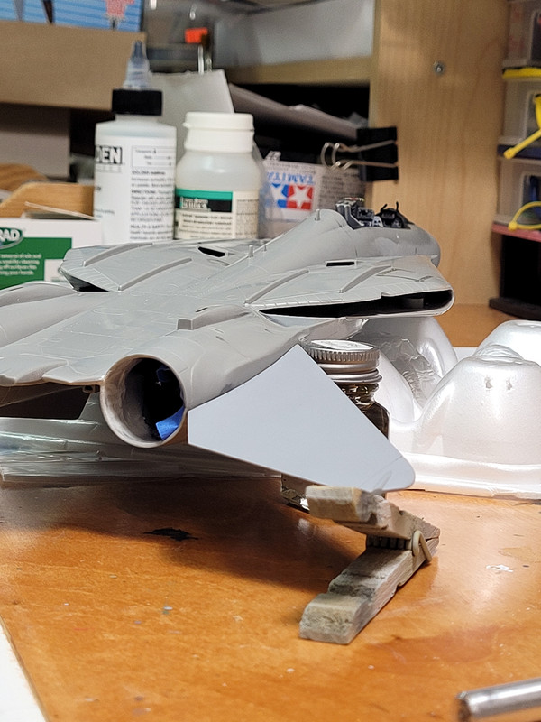

Working on getting the stabilizer installation finished. I 3d Printed some mounting hardware. The raised area on the back plate is to offset the opposing raised area inside the fuselage from the kit's locating pin. I used a standard divider to make sure I drilled the holes in identical places on both sizes of the fuselage and used a triangular cutting bit to get the holes started (drill bit would have wandered around too much).
The idea was to allow a little play in this assembly so both stabs can be installed at the exact same angle. I will probably use 5 or 10 min epoxy to install the posts and tweak things as the epoxy sets up.
The holes in the stabs are also a bit oversized to allow for some additional latitude in positioning things.
Very happy with the results.
Will pose these drooped as they are normally seen when a/c is on the ground.
Or maybe I'll drop the flaps and modify the nose gear to kneel so they can be displayed as if going down the cat... :hmm: Ok, maybe not... :giggles:

Looks like some sweet fill work overall. I’d like to use Aves again. It was John Kim who turned me on to Milliput. I don’t know much about modern aircraft yet but one sure fire way to learn is to follow along with you, Chris. I can appreciate your love for this kit, too. I can also appreciate the reality of your model building approach—the usage of inverted egg cartons as a support takes me all the way back to memories of my Dad’s bench when I was but a wee lad by the side of the ditch and everything he did was enormous and powerful and magical. That’s a long winded way of saying good job of work, but I think you knew that.

A really interesting build Chris - I like how you're going about tackling a lot of the problems with this kit - the new pins for the tailplane were an excellent idea. The cockpit btw, looks excellent.

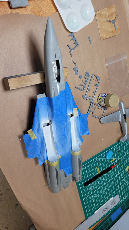

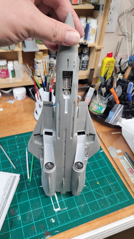

Jumped back on this horse this week. The intakes have always been a speedbump with this kit. Decided not to do a thing with the intake seams, because, you know, it's a model and the brain knows that :lol: This decision will make painting the intakes much simpler.
