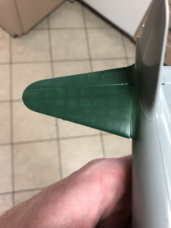

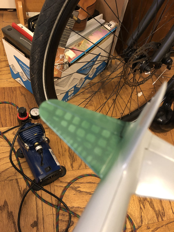

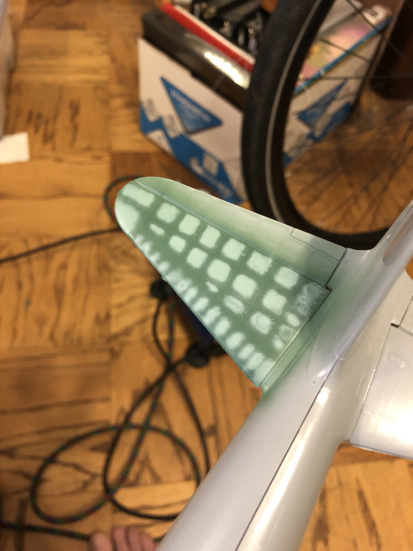

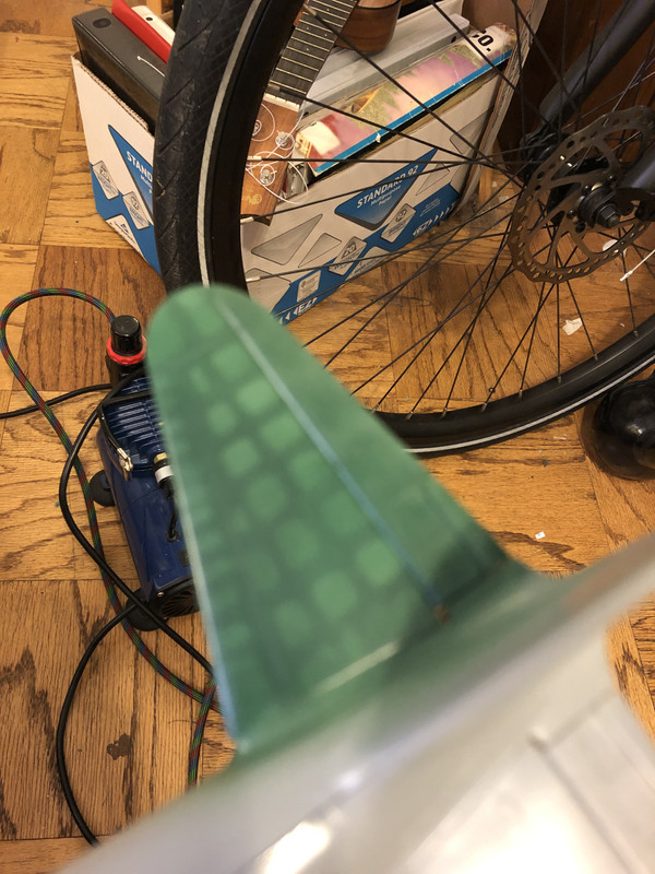

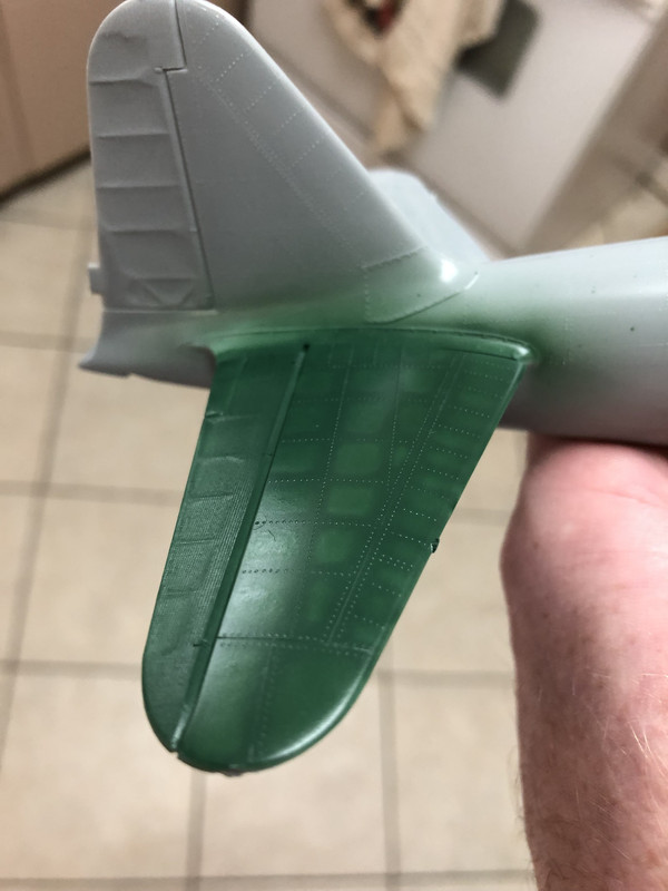

EXPERIMENT #3
1. Spray the base coat over Tamiya Flat Aluminum. This base coat is Dark Green 2 mixed with JN Gray 2:1. I did that because I wanted to reduce the starkness of the resulting shading.
2. Spray the highlights in the center of each shape on the surface. This highlight color is a mix of my custom RLM65 and Dark Green 2, 1:1 (this was great accuracy practice).
3. Next came the blend coats. Heavily-thinned Dark Green 2, sprayed in the direction of airflow.
4. The results after subsequent blend coats.
Subsequent clear coats and oil filters will knock out some of that variation and tie it together. I’m very happy with this and this is how Inwill proceed when the time comes. I’m glad I pulled out Doug and Reggie, my paint mules, to test this.

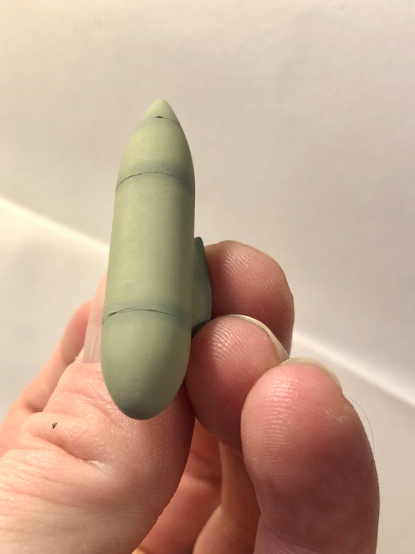

OH! I also got rid of the unsightly remains of that seam on the bottom of the drop tank, and re-painted it:
